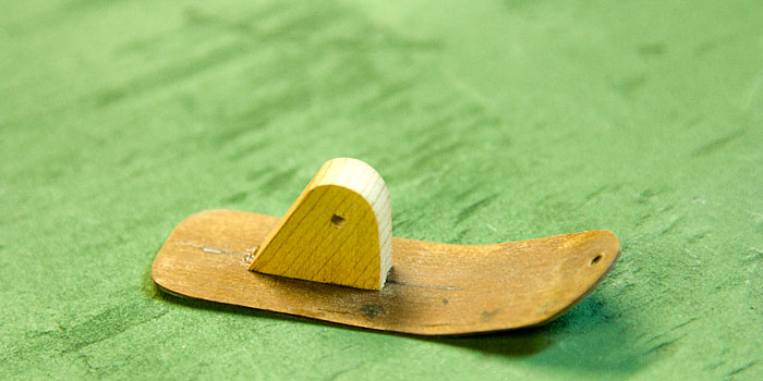

I've heard Formica (used in counter tops etc) makes a pretty good ski material. Tough as nails & best of all, nice & slippy on one side...
http://www.scipie.com/rc/skis/20120122_0067.jpg
I used a heat-gun to help form the ski-tip...
http://www.scipie.com/rc/skis/20120123_0024.jpg
The ski's spine I made from scrap pine. I used contact cement to temporarily tack my templates to the wood...
http://www.scipie.com/rc/skis/20120122_0074.jpg
A little time at the scroll-saw, some sanding & we have a pair of ski-boots...
http://www.scipie.com/rc/skis/20120122_0079.jpg
