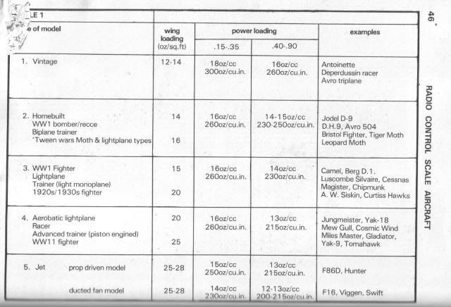

Old 01-23-2013, 08:41 AM   #20
Posts: 2,963
Scratchbuilders Award  Outstanding Contributor Award  125mph Speed Demon
Originally Posted by npowell28 View Post
Cool. So about 1 to 1.5 inch. I've sized it up and that looks good. Yes my wing does have some washout at the tips. Just on the building with foam and balsa comments. It's still coming out heavier than i thought it would. I reckon i'll finish at about 65 ounces. I was hoping for about 55. Wing loading should still only be about 12oz per square inch though.
These might bbe of use ..... (old but good !)
- Subscribe to my Youtube: "solentlifeuk"
