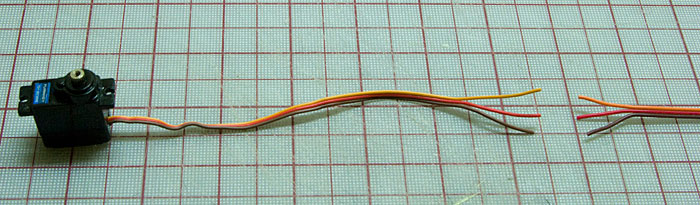

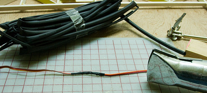

Originally Posted by Nodd View Post
The wires don't reach

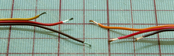

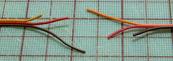

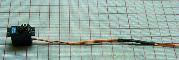

I've never been one to use pre-made servo extensions as it's not that difficult to solder together a custom length of wire if need be. Here's a great tip I picked up watching Bruce from xjet & rcmodelreviews on YouTube.
First I cut off the servo plug & find myself a spare length of servo wire...
Next I stagger-cut the wires so the connections aren't all in the same spot...
Bare the ends...

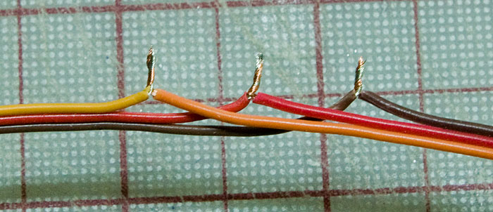

Twist them together...

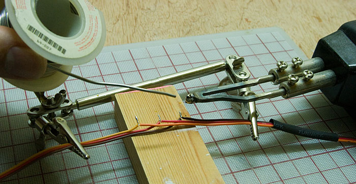

Add a smidgen of solder to each...

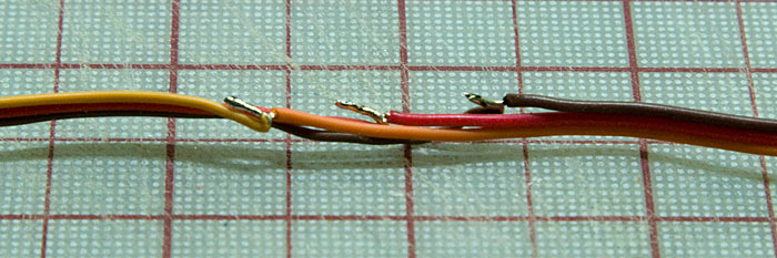

Bend em over...
Slip a length of heat-shrink over the whole thing...
And we're good to go. I like this technique, no need to fiddle about insulating each wire separately. Thanks Bruce...
