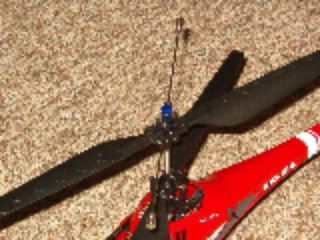

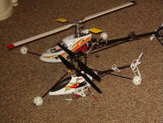

Default Just finnished the conversion
I just finnished the conversion on the CX2. Man what a diffrence in performance! It actually fly's much better,outdoors in the wind 5-10mph.With the added power of the Xtreem motors,and the tail boom (the wind dosen't push the heli around so much),the heli flys like a diffrent machine. I plan on adding the alum grips,and lower hub,plus the Xtreem upper and lower blades to it. Ron <a href="[media]http://s33.photobucket.com/albums/d86/rks1949/Heliocopters/?action=view&current=IM001228.jpg" target="_blank"><img src="http://i33.photobucket.com/albums/d86/rks1949/Heliocopters/IM001228.jpg" border="0" alt="Photobucket"></a> <a href="http://s33.photobucket.com/albums/d86/rks1949/Heliocopters/?action=view&current=IM001227.jpg" target="_blank

Here's a couple more,Ron

Looks good, Ron S. I'd like to build a hopped-up CX2 some day with complete after market and upgraded parts. But using only the parts that have high praises and the best flying results.

Yeah,it really flys well now,I tried to fly it in the wind yesterday. It could handle 5-10mph wind,but when it got up to 15mph it would go backwards only! Ron
