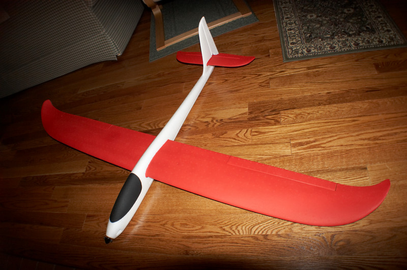

I painte my easyglider with flouresent spray paint and black Krylon H2O spray paint and alsi a little black auto spray paint.. They all seemed to work fine.
The flourescent gave the best straight edge aganst masking tape,,
popriv is offline

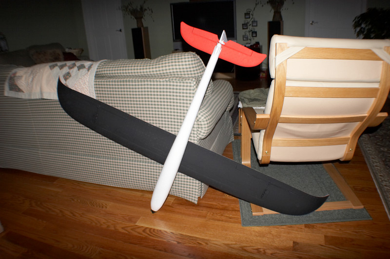

If my pics uploaded you can see I planned around putting tape over paint. I used regular masking tape and black electrical tape. both worked.
Where tape did cover paint it did pull some off but as Flywheel said you could touch it up with a brush.. I didnt bother.
The flourecent leading edge really lights up when shes coming at me with trees behind it.
The black white and florecent wing bottom is much easier to see than the white was..
I couldnt find the sealer that multiplex tells you to use??? So I went ahead and used anything... It does chip off a bit but because the foam is flexable I think any paint will???

Gorgeous bird, Steve! Very nice design. The bottom, albeit pretty as it looks, really doesn't matter though on a sailplane. once it's over your head, every plane is black (Hey, maybe I should add that to the "Great E-Flyer" quotes thread..?).

Maybe cause I'm flying at sunrise but I find the black shows more than it did when it was white I'd have to see both birds in the air to judge the difference.
steve

The hobby store paints cost 3 times the same paint at the hardware store.
I use Krylon and Rustoleum on my Easy Stars and Easy Glider.
ID:	82936 Easy Glider, Rustoeum paint
ID:	82937 Easy Stars, Krylon and Rustoleum
