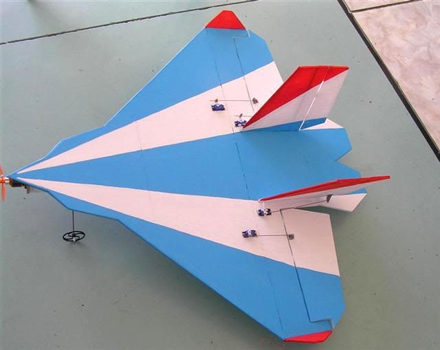

After having built a EVO MUGI which is a S.P.A.D., I decided to explore other technique to build a SPAD.
Some people call it Simple plastic aircraft design I preferred to call is Simple Plastic Airfoil Design.
The first thing is to built a profile shape aircraft with its basic aerodynamic in place.
You can use Depron, foam or simple fold a paper plane to make a profile aircraft .
Just toss it around, make necessary modification or add weight at the nose until the proto-type can glide.
Note the Balance point in which the proto-type glides well because this will be use later to determined the actual C.G.
I started with the proto-type and the final finish product is a fast flying EDF jet. See attachment.

Old 10-17-2010, 02:20 PM   #13
babylon5
Join Date: Apr 2006
Posts: 530
Thanked 29 Times in 29 Posts
hi, here is the picture of the delta spad. This is the 3rd SPAD sucessful maiden today.
It is faster then is predessesor because of some changes made . Same power plant use.
I like to correct the current drawn as previously reported of 20amps is incorrect. It is now drawing 28amps on a 3 good cell lipo
The higher flying speed attributed to a thinner both in cordwise and thickness. It has a more flat bottom airfoil and a curvature top airfoil.
It was fun racing with some fun-jet today.
This 3rd spad with a sexy colored scheme(pinky is very visible and nice in the air.
Sorry no video yet.
