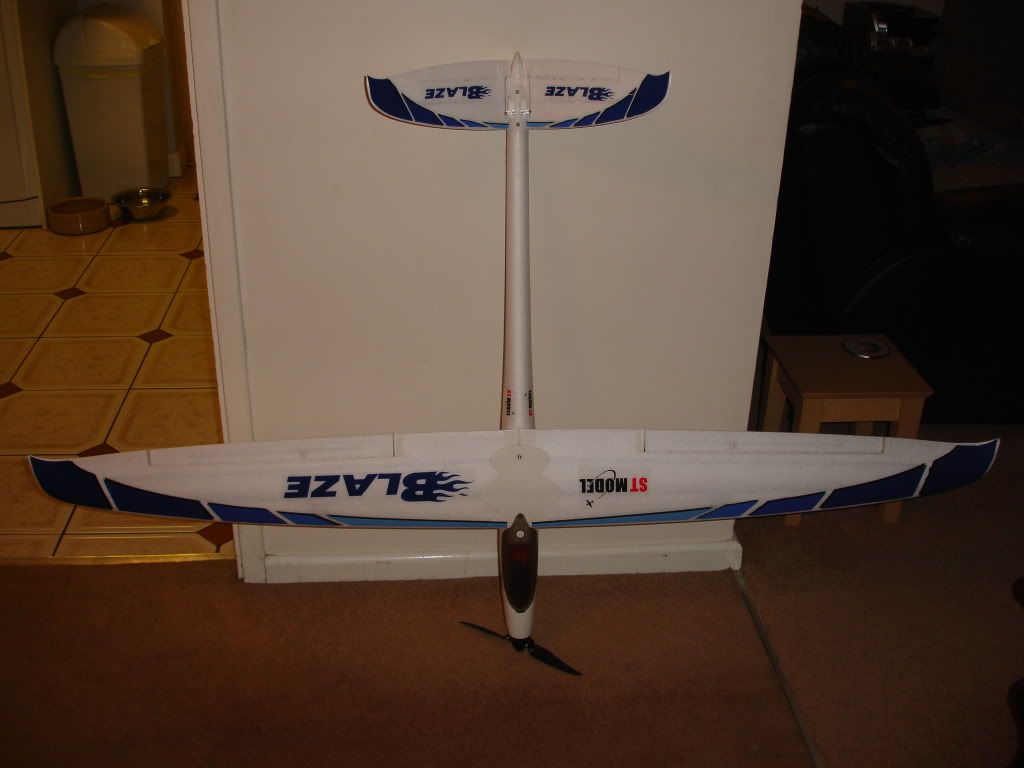

Was flying my Blaze on a beautiful day with blue sky's and hardly a cloud. It was performing brilliantly. I was flying pretty fast but it is supposed to be a hotliner after all. Next thing I know it's not responding to my control movements. It's pretty high up and quite far away. As I initiate aturn with ailerons it's fine. Feed in some up elevator to speed up the turn and it rolls quite violently. Lost it over a building site in the end and was worried cause it's a built up area. When I got there it turns out it hit a tree on a farmyard. Two guys working on a tractor said yeah mate it's up there. Didnt half make a loud crashing noise as it hit.It had buried the front of the model in a tree and the tail was sticking out. From what I can gather the right half of the V tail had snapped off so all my elevator commands resulted in a force at 45 degrees to the tail causing it to skewer out of control. It now has a conventional tail with standard elevator on it. At least if I lose half this tail I will have a chance of bringing it home.I have insurance but was really worried in case it had hit someone in such a built up area.

It's about a year old and has been flown about 30 times I suppose. There is a vid on youtube of one flying with a rear facing camera and you can see the tail come loose and flap about so may be a model related problem. It was pretty easy to convert as the old tail just screwed on. I made a new horizontal stab and elevator out of balsa and hot glued it into position then made a fin and did the same. Then brushed a thin coat of EZ coat on it before spraying with car paint. Looks OK. Gonna test fly Monday hopefully.

To be honest I was flying pretty fast and making quite tight turns but it is supposed to be a fast model. It would be difficult to spot flutter from the ground due to the speed of the model but I suspect it probably has been fluttering and just fatigue cracked at the base of the tail. The usual inspection and control checks before flying didn't highlight any probs. The new tail slipped slightly while the glue was going off and is a little crooked but should fly OK. There's a vid on youtube of someone flying their Blaze with a rear facing camera and it films the tail coming loose.

Have finally had a chance to test fly with the new tail. She flies great.
Really put her through it. Flew as fast as I could and made some insane control inputs and no problems at all. The balsa tail is so much heavier than the vtail I removed a fairly large bit of lead from the tail and fitted to the nose but still had to add some more. Very happy with end result.
