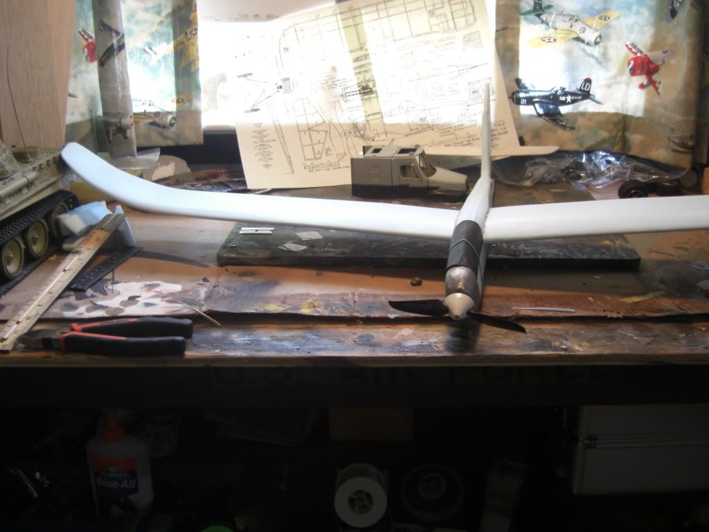

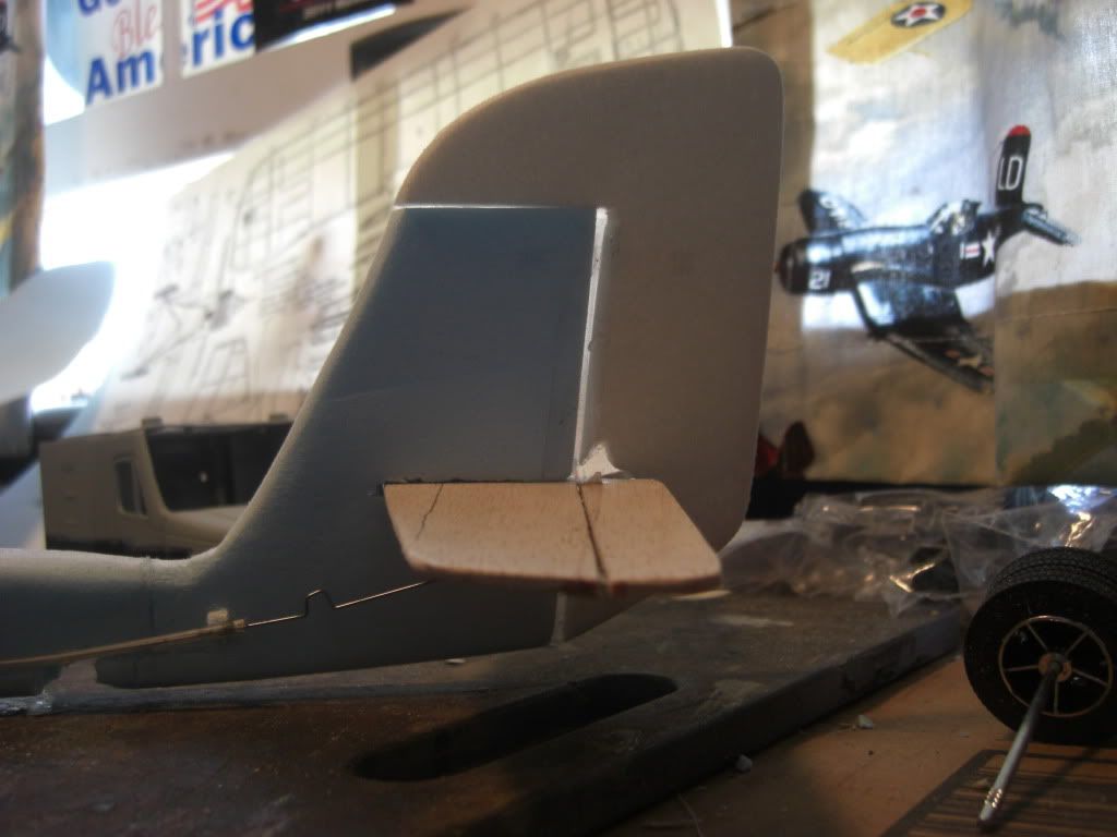

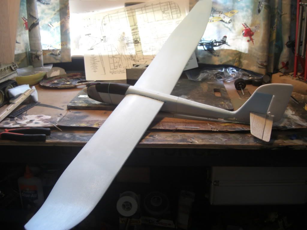

It will not be perfect but it's looking like a Radian!!!
What do you all think?

I love the beautiful graceful curved wing. How on earth did you cut that out?

Id still like to see your setup that you used to cut that cool wing

LOL,Sharp kitchen knife, sandpaper, and a heat gun. lol
