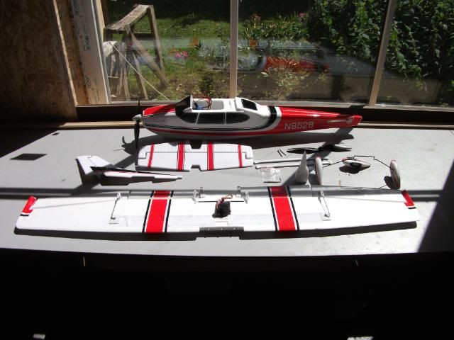

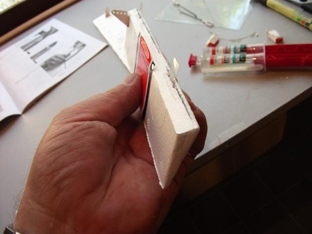

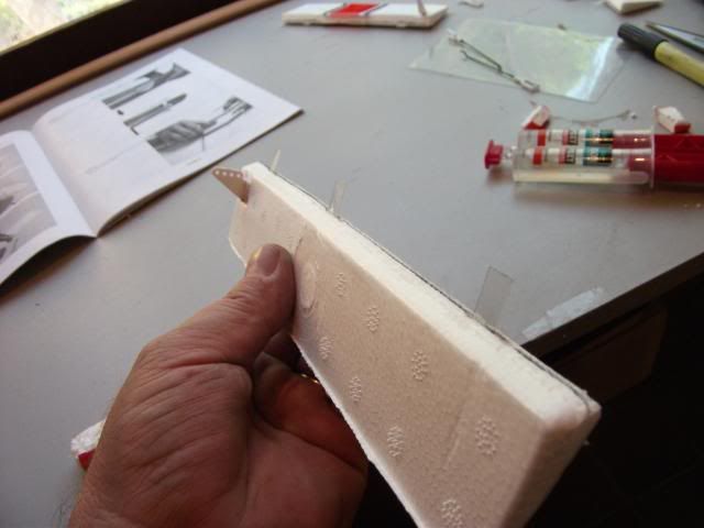

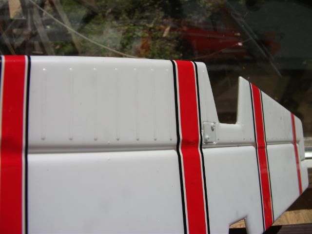

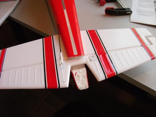

So Hobbyking were offering out their Cessna 182 ... Length : 31" Span : 39" AUW : ~600gr 5 Ch : Ail, Ele, Thro, Rudder, Flaps Duly arrived in post ........ well boxed to protect against handling. I took all out and here were the contents : ![]() The model is supplied with a small amount of assembly to do and then connect own Rx ... battery. First thing noticed was trim tape had been applied without thought of surface movements .... ![]() ![]() ![]() So a model knife was called for to slice through and allow surfaces to move ... ![]() When moving flaps / ailerons - the amount of slop was terrible. A gap of about 2mm existed at hinge line ... partly due to poor fitting of tape hinge. I hate tape hingeing and decided to remove, use acetate hinge strips epoxied into slots ... ![]() So remove flaps and ailerons ... carpenters trick with pen and draw hinge line along surfaces and wing. Model knife and create slots for hinges. I chose to use epoxy for all my work here instead of supplied foam glue. I don't fancy waiting 24hrs for glue to set. ![]() ![]() ![]() All hinged up and put aside to set. Fuselage needs a slot cut at tail to allow tail set to be slid intop place. The recc'd slot in my opinion is not enough ........ so I sliced of the top of end section to allow tail set to be inserted easily and aligned ... ![]() You have to cut away more than they say anyway to allow elevator to move. I glued the piece back to fair in again. Now wing is nicely hinged up - checking the control links from servo to surfaces .... the flap links are plastic ends glued to torque rods. The ends were not fixed solid and slight pressure on them would turn them altering the position of flaps. The rods etc. are glued into wing and would require surgery to remove ... so a careful application of CA was done to try and lock them in place. Taking care not to glue up torque rods in tubes. So now it was time to marry wing to fuselage ........ flap actuator fouls back end of wing seat and you need to deploy full flap down to allow wing to drop into place. Once in place it's fine. With a 1800mAh 3S Lipo ... balance was spot on ... most gear is fiited at or near CoG - so little difference with change of size / wt. Model is stated for a 1000mAh 3S but given the motor, 5 servos etc. - seems a bit on the small size. The battery compartment can well take up to 2000mAh and as said - its on CoG so no corrective weight measures needed. One thing that is obvious when assembling model ... wing is flexible and leads to thinking of adding CF spar etc. Actually not necessary as when wing struts are fitted - wing stiffens up fine. So now it waits for it's maiden flight at Regional Fly-In today July 2nd at Ventspils Airport ............. but forecast is for strong winds ! Test of motor indicates over-powered ........ just as I like ! It pulls strongly. I have 4 niggles with it ... 1. The poor vinyl self-adhesive trim tape ... it's not shaped and fails to adhere on curves etc. ![]() Its adhesion is poor and likely after 1 or 2 flights it will start shredding / looking tatty. 2. Very poor hingeing that I feel if not corrected would lead to sorry result if try to fly. This model is aimed at learner - intermediate - so would end up crashed in many cases. 3. Poor design for fitting tail set ....... 4. Flap actuator rods ... poorly fitted plastic ends needing fixing. Anyway here she is waiting for the day : ![]() ![]() ![]() The model is actually the Skyartec Cessna. My opinion is that factory assembly produces a nice looking model but I believe from my above observations - it needs modification work to get to flight ready in addition to the small amount of assembly. If a beginner was to buy and try fly without mods made - I think it would have a very short unhappy life. (The eagle-eyed among you will have noticed one of my all-time favourites under the bench - Skyleader Skymaster Mk 1, waiting to be built. That will be subject of another "out of box" but real traditional build job .... ) Cheers Nigel |

Thats Smart to go through the aircraft with a fine tooth comb and check it for errors, thats something most novice pilots wont catch, but experienced pilots will now that you made it bullet proof it should be a great flier, it looks great too, Can i do the Maiden flight on it Just kidding Take care and have fun, Chellie

if you have the time, get some testors clear spray enamel paint and give the plane a clear coat, its foam safe and will help to glue the decals on so they wont fall off after a few flights, also it will help to keep the foam looking clean, Just my 2 cents worth.

Is it just me, but the right wing looks down warped, Maybe it just the way the pic was taken or something. have a good one cr Great thread! |

No its fine .... its the main U/C ..... when you push and clip into place - one side goes in easier than other. I hadn't squared it up evenly - just put in quick for photo.
Hi Chellie ..... Clear lacquer is good idea - but this plane has thick vinyl self-adhesive stuff on it. If it was water-slide decals - then 100% agree. I'm not bothered about it actually - as I intend to let it start to peel of in use and then do a proper paint job with UK registration ... just to set her apart from all the others who have same USA reg'n ! Here she is 'sitting' on TOP of my mates 26cc gasoline powered Cessna 182 .... Unfortunately the wind was very strong that day and most planes were not flown at the meet ... I chickened out on the Cessna after my ME109 couldn't handle it ! We hope that today 3rd July ... wind should be lot less and she'll be given her maiden. I have to say that the 182 does have a nice overall look and hope she goes as well as she looks. I'm expecting her to be too fast in scale ... Youtube vids show that .. plus that motor they fit is pretty strong on pull. Photos to come ! |

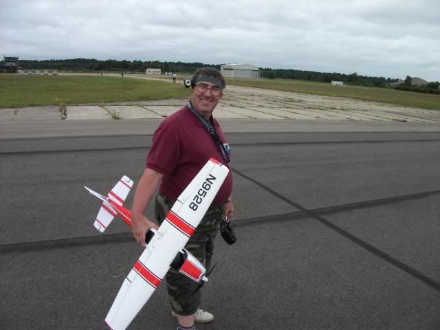

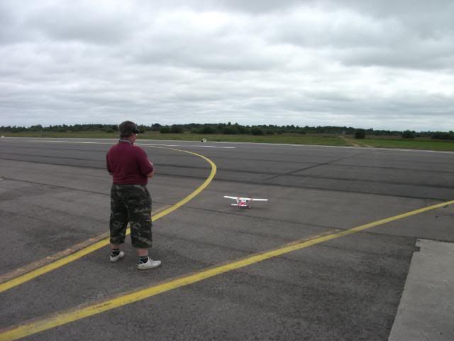

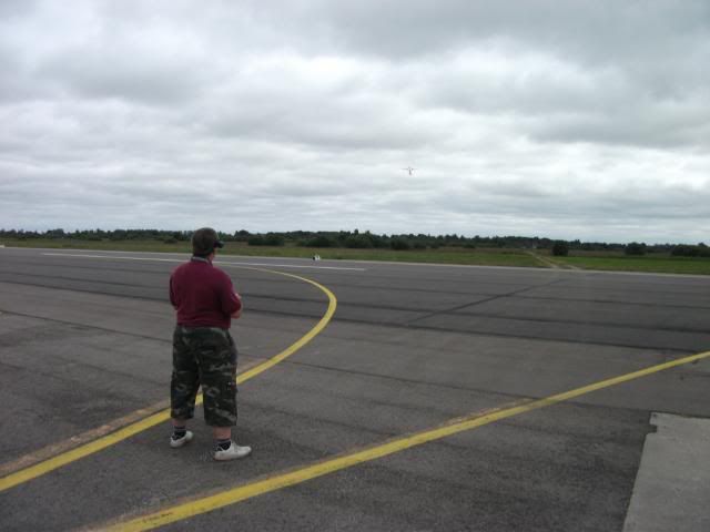

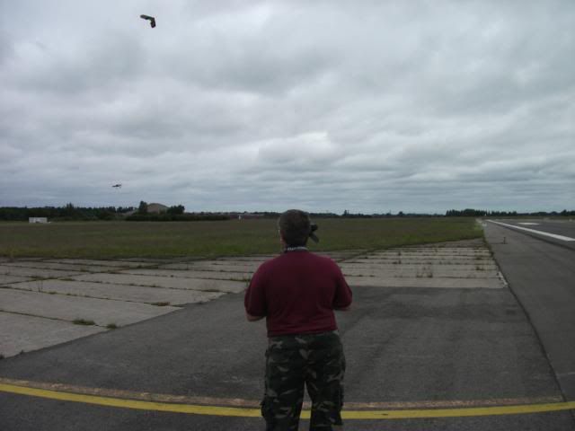

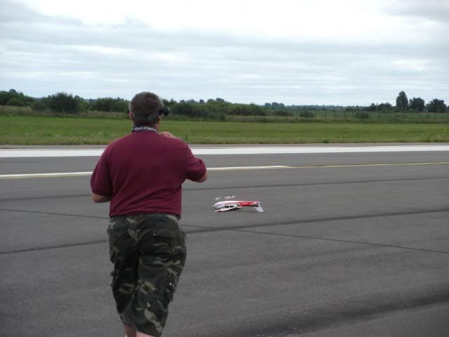

So Ventspils Airport runway and wind about 4m/s gusting 6m/s ....
Fired up FlySky 9X Tx with FrSky module and then fitted my 1800mAh 3S Lipo to the Cessna. So here before the initial flight .... ![]() (I'm wearing a helmet vid-cam so I can video the flight for post analysis ... ) Take off run ... ![]() In flight showing I'm a very happy pilot ...... ![]() ![]() ![]() Unfortunately the nose wheel fixing must have come loose and as she rolled out the nose wheel turned and she flipped on her back.... ![]() But having flown her and going home with her in one piece .... you can see how pleased I am here : ![]() Ok ... points found in the flights ( I made 2 before wind starting to increase again and I packed up). a) Definitely well powered ... faster than scale by a long way, but nice. She slows down to about 1/2 throttle OK with a shallow gradient decline in height. b) Aileron rate is excellent for geneeral Cessna style flying, but not enough for good rolls etc. - she is very untidy in rolls and very slow ! She needed near full right trim to stay level ... must check out why. c) Elevator authority is high and could be trimmed back a bit. d) She needs a burst of throttle to execute anything like a stall turn, as rudder is not as powerful as it could be. e) Nose wheel fixing is not so good ... it is a long collar with grub screws tightening on wheel leg and short leg on fuselage. Mine loosened in flight and caused her to flip on landing. f) Tried inverted but until I get aileron authority sorted - she was very unhappy inverted actually going into a spin when trying to turn her in a moderate bank ... Summary : Care with out of box inspection and sort out the items highlighted earlier. She wants to fly and is good 2nd or later model IMHO ... I wouldn't recc'd for a lone beginner but with teacher / buddy box - no problem .. Flight time on 1800mAh 3S Lipo ... with about 75% of flight at 75% - 85% throttle and short full throttles ... I did 4:57 and had 58% charge left in Lipo. If anyone else is looking at this model - ENJOY !! Nigel For landing you set her up on low throttle and let her glide in and she greases in lovely. |
