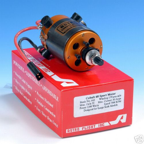

Finally, here is the Power System that was applied:
the ASTRO FLIGHT 60 Cobalt Direct Drive Brushed Motor:
STOCK No. 662
Winding 13-Turn #24
Max Cells 32 (Round, such as Ni-Cd, Ni-MH)
Max Current: 30-AMP
Power: 1,200 WATTs
Speed: 7,500 RPMs
Designed for Large Models

After many thoughts on the matter, I decided to use some power systems that I have had on hand for a number of years and still in very good condition. Since this "is" a "LARGE" trainer, I concluded that using a quality motor such as the ASTRO FLIGHT 60 Cobalt direct drive motor as the motor of choice will do well on this model as it has 900 sq.-in. of wing area and the style of flying will be exactly "Trainer" manner all the way.
Another reason for the selection to the ASTRO FLIGHT 60 Cobalt is the tremendous Tail Boom Weight that this model exhibits and the only motor that I have on hand to OFF-SET all this Tail Boom Weight was the AF 60 motor! Checking the Center-Of-Gravity, with the projected battery type and amount of cells the Center-Of-Gravity will be right on the mark without adding any Lead Dead Weight what-so-ever.

Lets See about my Trusty P-Calc Program....seems like the results are a little high...
ESTIMATED @ FULL POWER:
AMPs: 22.7 AMPs
WATTs: 583 Watts
Voltage
under
Load: 31.86 Volts
Efficiency: 80.5%
Prop RPMs: 8336 RPMs
Prop Pitch
SPEED: 63.1 MPH
Static
Thrust: 119.6oz. (7.5 lbs.)
ACTUAL MEASURED DATA @ FULL THROTTLE:
AMPs: 16.45 AMPs
WATTs: 576 Watts
Voltage
under
Load: 35.86 Volts
guapoman2000 is offline

It seems like by adding another Cell Li-POLY (another 4.15 Volts off-the-charger), I have effectively increased the overall capability of this power system as I have increased the Watts by 174 Watts additional!
Thereby, as previously posted, the fully flight weight (worse case) was:
8lbs. - 2 3/4oz. "or" 8.17lbs.
So,......
8.17lbs. / 576 Watts = 70.48 Watts / lbs.
I have effectively increased the Watt per Pound up another 20 Watts/lbs.
I am a true believer of HIGH VOLTAGE SYSTEMS from now on for the larger Models!
