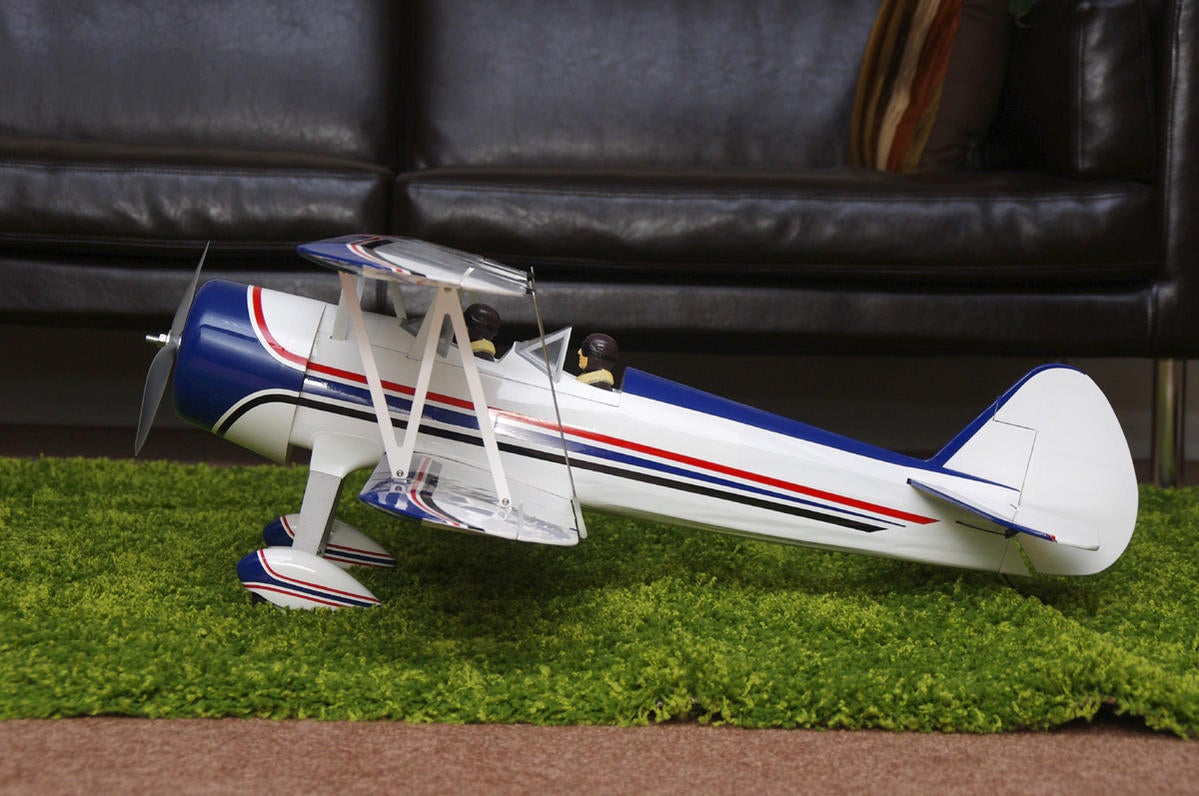

My buddy Gerry purchased it last weekend and today he was able to maiden it at our RC Club.
A few pictures showing how he setup the model.
Yes, he used the Super Tiger .10 Brushless outrunner that is slightly heavier than the recommended RIMFIRE motor but, my buddy did select the same 1250Kv equivalent motor like what Great Planes recommends.
Well, Gerry came with a big load lump in his pants showing me this and that and I had to keep my big mouth shut and go along as if I would have pushed him, I feared that he would have not maiden his model today

Here are some changes I did on mine:
1) Replaced the motor with an E-Flite 950 KV 480. I had this motor in a retired Pitts Special so no cost added here. It will swing the same APC 10X7 slow flier prop I flew the Pitts with many times.
The current draw won't be more than 18 amps. with this setup and it will fly it with authority.
2) Unscrewed the "N" struts since I noticed they were pulling the top wing down some bowing it and adding unnecessary twist to the outboard section of the wings. I will add a small extension to them to be screwed back to the wings.
3) Added two washers to the two front strut top wing mount to remove the small amount of negative incidence present before.
With the 1500 mah 20 3S1P battery fully forward it balances on the spot recommended.
