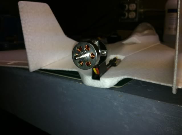

Swapped out motor for 5000kv EDF and found following ....
Bench run : 5000kv motor ( 2610 ) On 3S 25C Amps : 48A Watts : 420w RPM : 23600 On 4S 25C Amps : 51A Watts : 525W RPM : 29700 Motor extremely hot and rpm audibly reducing .... needs serious setting-up to be useable. What is interesting is the large jump in watts .... but lesser jump in RPM etc. All on same 5x5 prop. It appears to me that maybe there is a limit to prop size and what can be realised. It is interesting that with the 3700kv heli motor we had similar RPM and greater watts on the 4S ... this only goes to confirm my earlier idea that watts are good - but pitch is better. I'm back with my 3700kv heli motor and will up my ESC ... |

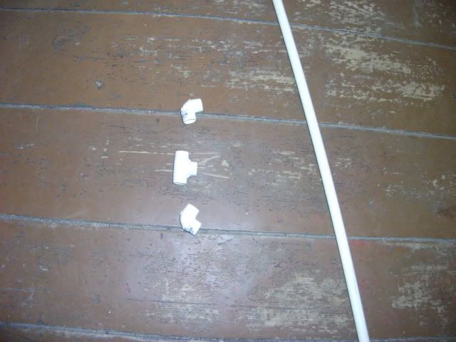

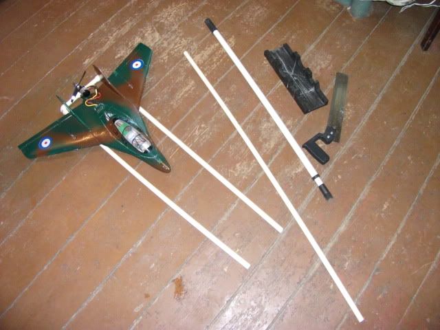

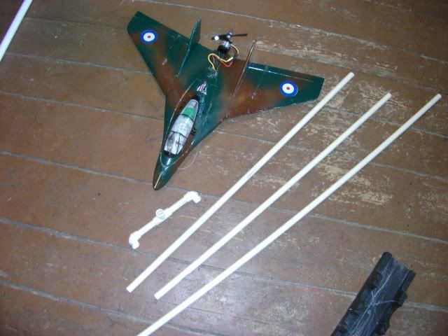

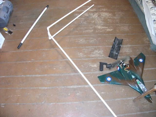

Using anothers Youtube vid as a base ... I bought some plastic plumbers tube / fittings and decided to try a launcher ...
![]() ![]() ![]() ![]() The affair dismantles down ..... i have added angled braces from stand pipe to the actual rails in wood dowel. ![]() My idea is that with sufficient power on a smooth polished plastic tube like this - she should slide ok .... Trouble is it's really cold out there to trial it !! |
- Subscribe to my Youtube: "solentlifeuk" |
