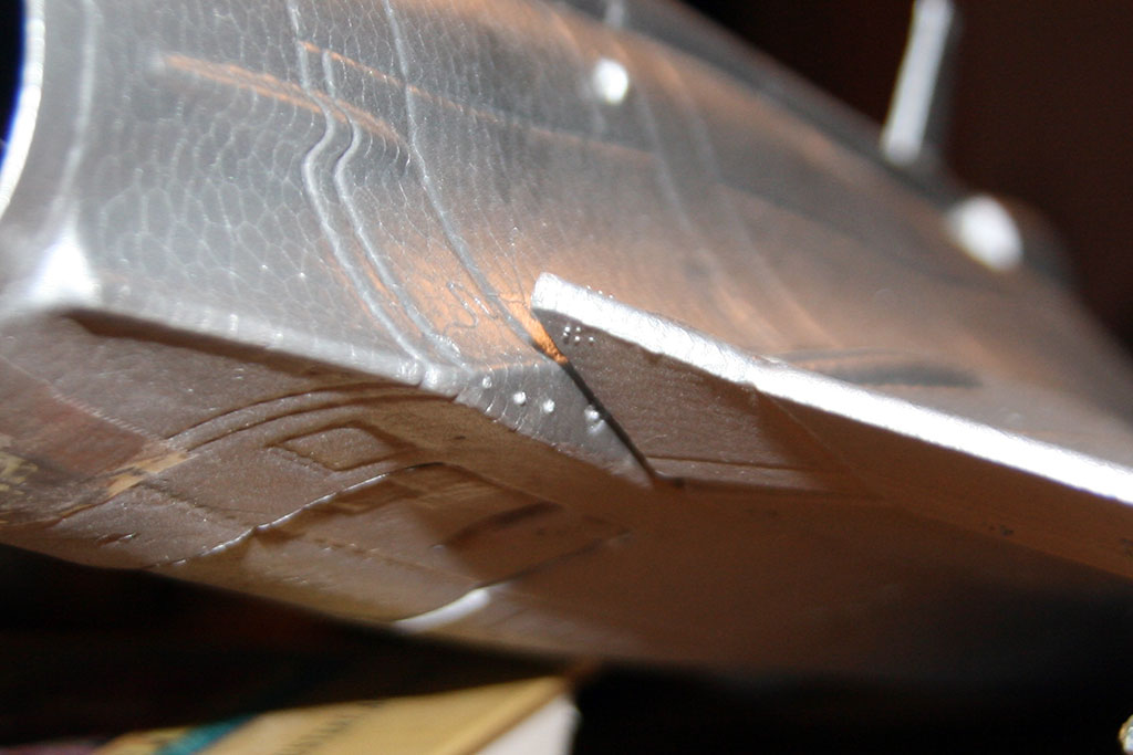

Flew my JAS-39 again today, this time with 3/4oz of lead taped to the very tip of the tailpipe. It was almost flyable. Next time, it'll be a full ounce.

I'm still carrying a ridonculous amount of up reflex.
I'll be curious to hear from anyone else who's bought this plane to see what their experience.

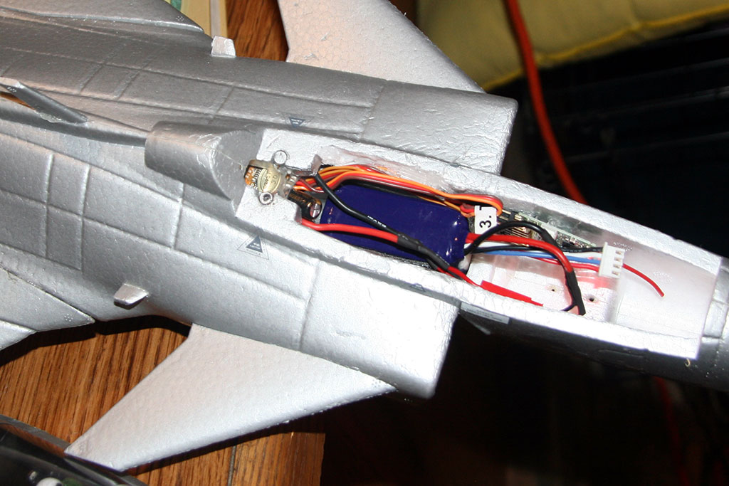

On the battery, I took my soldering iron and burned out the cross member joiner section than span the floor. The sidewalls now line up such that I can squeeze a larger battery in there. Now the battery itself acts as the supporting cross member and I'm able to go 1300-1500mah 3 or 4S.
Hawk, I'm not sure if your plane is significantly different than mine or I'm not understanding you.
I have my battery all the way back, jammed under the ESC. Are you talking about making more room behind, or in front of, the normal battery area? I have plenty of room forward of the battery but, as I'm nose heavy, I can't use it.
The battery compartment on the Gripon slants in at the back and the bottom. I actually punched thru the wall into the intake area already in carving the sides out to fit my battery. The entire foam section of the battery/cockpit area ends maybe 1/2 inch behind my battery. If I chop thru, the battery will just slide out into open air.
I'm not afraid to cut some foam, but I don't have much foam to cut.

I see what you mean. They may not be the same. The only area I cut was on the floor of the fuse that formed a connecting boundary between the rx and the battery. Really only needed about 6mm more in length to squeeze a 1300 3S or 4S versus the stock 850mah.
I really didn't have an issue with CG for this slight mod. Here are three pics showing, empty, the 850 and a 1300:
