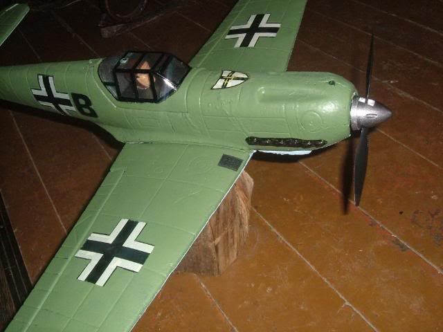

Here's the model before serious problems :

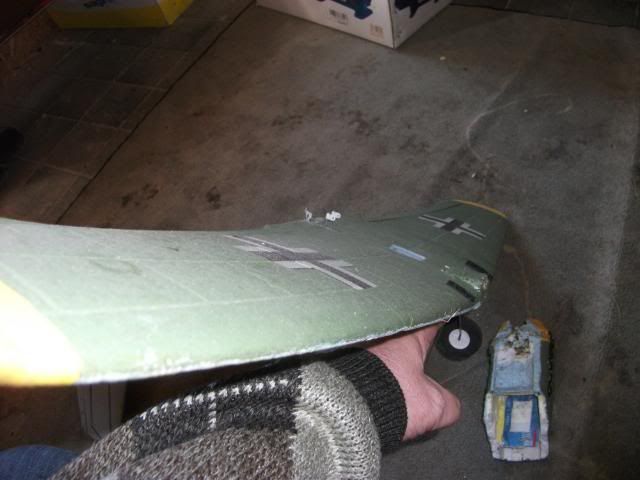

This is what I have now after her last vertical dive into the ground, believed caused by the failure of the fuselage in it's weakest area over the wing seat ...
Wing is fine ...

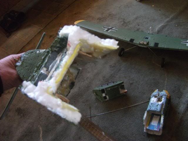

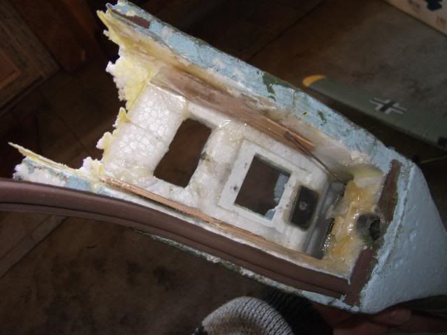

Some close-ups of the fuselage ..
As you can see this is going to be a serious project to rebuild. The front section that has broken away will be constructed from my favourite pink builders closed celll foam. A strong and sandable / carvable foam that is much better than the styrofoam of the original model.
Until I actually get knife and parts in hand to start ... I have idea to cut back the rear part of fuselage over the wing seat to create a scarf joint to join in the new. But before that - I shall lightly fix the old parts together to give me the wing seat shape to draw onto card.... for marking out new foam.
There will be a bamboo skewer inserted across the joints to brace and strengthen.

The Me109 I agree looks a real mess and initial reaction is "bin it" .... but when you look closer and consider it - with foam it's not such a big deal.
The wing seat is still there to copy when pieces are married together. Ignore the front end - the wing seat is important.
Total length of fuselage is easy to determine. General shape as well.
My thoughts are to cut a single block for the whole new section with hot-wire cutter. Not as in my Ultimate where I used my bench jigsaw to make blocks.
Once the wing seat form is cut - I then longitudinally horizontal cut the block. This allows me to then hollow out battery, ESC areas. The lower block then cut vertically to divide for sides of wing seat with of course material removed inside.
Basically I reckon to rebuild by creating a box structure. I will insert basswood spars into the length and across the spliced joint. These will also provide anchor for the motor mount as I did in the Ultimate, spreading the load into the airframe.
Biggest headache will be the cowl, as the original has a permanent surround to the motor, a real pain ! My idea is to cut this area of the above block, use cocktail stick pegs and magnets to align / hold in place around the rear star mount motor.... a 2610 200W RC Timer B/L ... on 3S.
