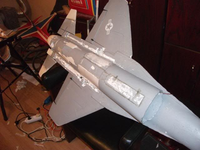

Well ... first I curved 6mm depron and sheeted in the retract areas ... then started cutting out splits / gouges more square to scarf in more depron ... in layers in some areas.
Tail extension just below rudder was missing ... depron to the rescue ...
Those dreaded elevator ends sliced off - yes - you guessed - depron ! 2 sheet pieces of 6mm sandwiched and pinned to elevator ends and then sanded to shape.

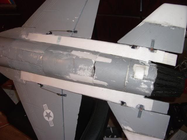

Next came the missing tail cone ... now the F16 is quite disctinctive with that fluted black affair ... so he had given me the tail cone of the Multiplex after fitting bthe vector unit ... this was too small an outside diameter but ID was correct at 70mm. es - again depron to the rescue .. in strips glued to the outside of the cone to produce the fluted look .. which also built it up to fair in with fuselage.
Photos ? ............. here ye go ...

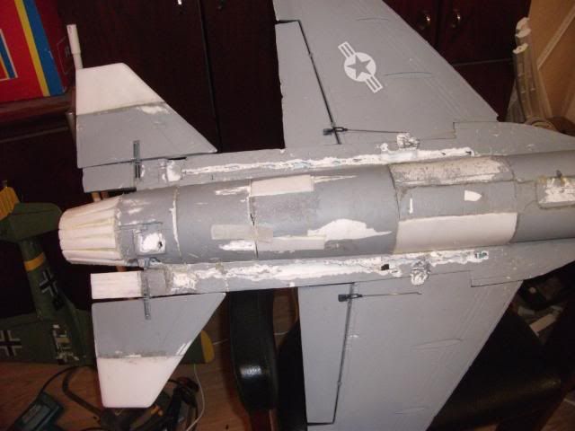

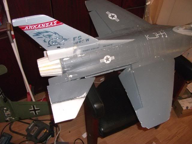

Today fitted cone .. and you can see the elevator pieces / tail bits etc.
Here's the ripped out fuselage runs where cables were ..

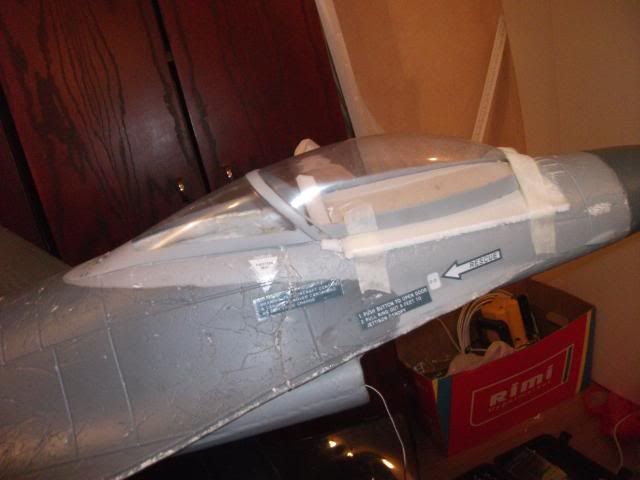

Cockpit base is proving a bit hard to fashion, but I'll get there ...
General underside ...

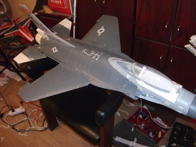

General topside ..

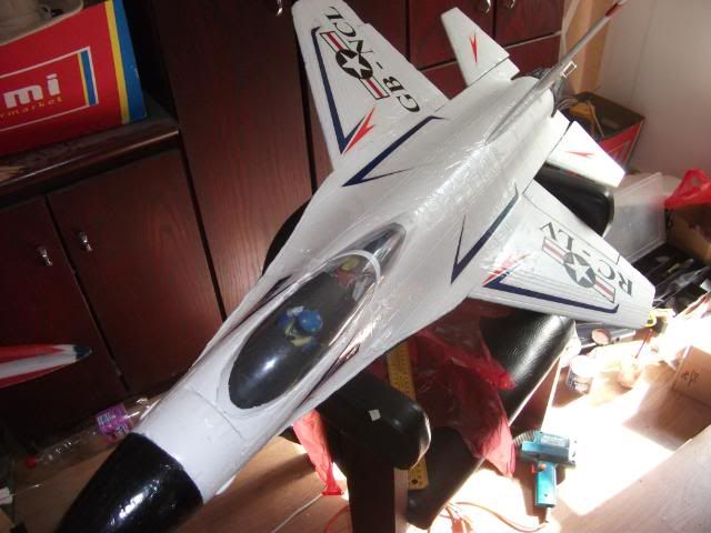

Starting to look like an F16 ... I will of course leave of retracts - it will be a belly lander / launcher job.
Colour scheme will be changed to more vivid scheme to be visible in sky ...

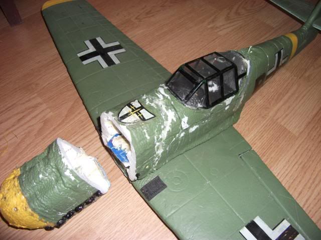

BTW, is that the short nosed version of the ME109 in the background?

The Me109 ..... that's a Lanyu ME109 that is having a new front fuselage made ... it became known as the banana ... so thought it time to cut of the old original crashed 50x front and give her a new lease of life.

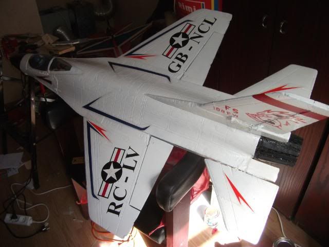

Today started on colour scheme .... so it was raid the goodie box .... check out what colours I have .....
I'm a great horder of unused stuff ... get a model, don't like the stock scheme - I put the decals in the box along with other bits and bobs. Later I use them slightly different to original !!
So decided .... White topsides, light grey underside.
The underside is plain without decals or markings. I will be visiting the vinyl shop to see if they can knock up some Stars and bars for me ...
The black nose and tailcone need to be done ... and fan unit mounted ....... then she's good to go.
If anyone wonders about the letters .....
RC - LV stands for RC in Latvia
GB - NCL stands for Great Britain - Nigel C. Luther .... my birth country and my name !
They get put on models I stray from scale schemes on ...

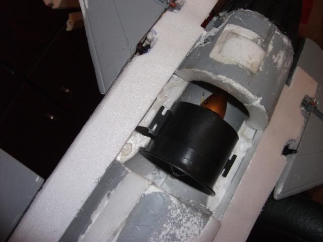

Fans in ..... and it's a permanent arrangement as there's no screw mounts in the foam etc.
I've epoxied the edf tabs to the fuselage and then the hatch down on to trap securely. I think with the power this thing is supposed to have - it's probably safest bet.
The hatch and joints will be taped up to seal and then painted over.
60A ESC is right at back of cockpit with solid 0.8mm copper wire back to the motor. ESC gets a blast of air via a slot from the air duct ...

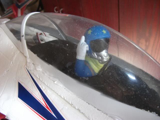

Final decals applied .... Pilot installed. UBEC wired in ready for 5S ...
She may look rough close up, never win any concourse medals - but she's all up together again.
General views :
The final touch ... :

The pilot in the F-16 is great!! love it!!
Regards
Ian

Just remembered a good jet bash for the 109 fuse that you posted earlier. They make a perfect HE280 fuse with a bit of rework, and they need a new nose anyway so the nose damage is not an issue.

Well it's taken a long time to get to this ..... but finally she got her day ...
I was not surprised when the motor gave notice it was in pain !! So decided to cut throttle and let her land ...
I may be lucky and have saved the motor ... will cut open the duct and see if I can remove that accursed rear cone that stops cooling air through the windings. If not then I need to find a better motor that can take the 5S.....
Very pleased though that what was a pretty sorry model has been given a new lease of life ... if I can get enough power out of her - I may even stick some wheels on her to save that back-breaking hand launch !!

Congrats on the maiden! She looks great. Looks like plenty of power, as that launch would have done in a lesser plane! Did you use an exhaust tube of the right exhaust area and all that to get the most thrust out of her?
Old 11-26-2012, 08:22 AM   #23
Posts: 2,982
Scratchbuilders Award  Outstanding Contributor Award  125mph Speed Demon
The duct is as is except for the rear black nozzle - that's of a Multiplex Twister 70mm. just added the fluting to it by strips of depron glued on.
I agree that the launch was a little too steep - but as you say - the power kept her going ... in fact literally she stands on her tail.
The model weighs abt 1.3kg ready to go ... thrust is over 1.5kg.
I just have to sort out that motor now ...
