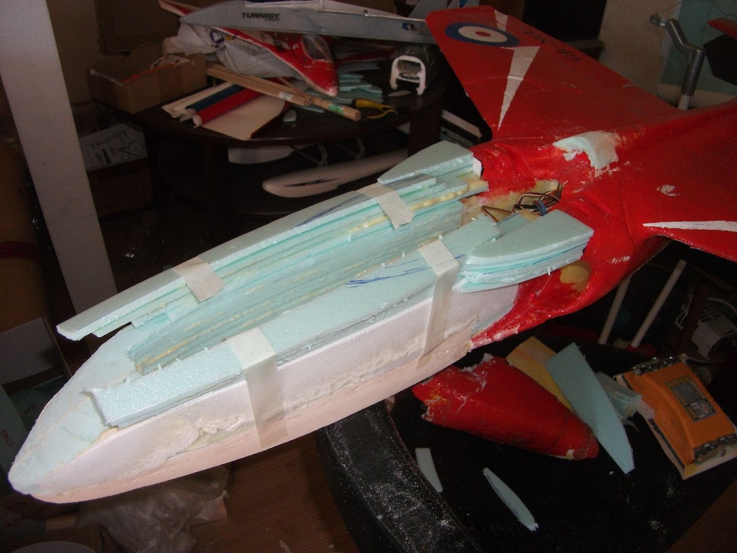

Canopy ... this is an awkward shape .. with double curvature ...
I tried planking :
Works but not happy ...
So out with block ...
This is now painted white base ... to lock the sanded foam ... then will be painted final ... it's more square, but to be honest given rest of models general condition - will fair in well enough.
