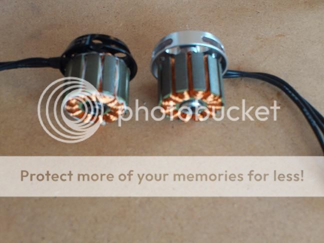

The static part of the motors are almost identical, but even there I have noticed a tiny differences. All Hackers have a retaining thread tied around the top of the winding, to keep the windings in place. The SK3 motors I've seen dont have this thread. Here's a photo i found on the net, it's not well focussed but you can just about see the white thread tied around the top of the windings on the hacker (left), the SK3 doesn't have any.
It's only a minor difference but possibly proof that they are at least made to a slightly different build standard, even if in the same factory.

JetPlaneFlyer: The photo that you show, of the stator of the Hacker A30-12L vs Turnigy 3542-1000Kv -IS ACTUALLY MY PHOTO !
From the RCU thread I started: http://www.rcuniverse.com/forum/m_11473040/tm.htm
" Hacker A30-12L vs Turnigy SK3 3542-1000Kv -Head to Head PERFORMANCE TEST "
I discuss the white strands on the outer of the Hacker stator in this post: http://www.rcuniverse.com/forum/fb.asp?m=11481166
NOT ALL Hacker motors have these white strands -the A10 and A20 motors do not.
Re: the "fan" - I do not see how it works as a fan at all. It does not have any blades that would move air in one direction or the other. It may just be a gimmick ...
