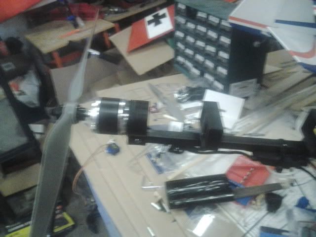

only picture I have at the moment.

we have a version that mounts permently inside of the plane once you get your cg where you like it. we can also build replacement parts (including your hatch, canopys, fuse joiners, motor mounts, firewall act. anything you can make out of plastic)and upgrade/modify existing ones, like building a thicker "wall".

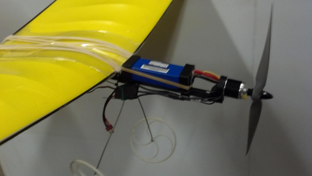

Here is a disign solution that we came up with
One thing that I always hated was changing my batterys. On a stick I was always afraid of the battery coming loose or falling off or just simply moving. While velcro and rubber bands worked it was a hassle. Remember if the battery is going to move it will move in a crash.
When putting batterys inside a plane it was hard to get the velcro straps tight enough with so little room. I mean we all want our planes to be as airodynamic as possible so we build things as small as we can right?
We want as long a fight times as possible so we tend to put as big a battery as is practical.
The end result is we have a big battery in a small place and we want the battery to be secure and that can make it hard to change out.
Well I have not seen very much inavation on battery boxes. I had been using the same battery boxes everyone else was. With velcro staps or pads or hinged compartments with latches and spounges. I am not suggesting that there is one battery box for every situation just that there are other ways of doing things. My son just happen to think of one that I think is good.
Not everyone has a 3D printer and it would be hard if not impossible to build these out of wood or foam. That is why I am making them available.
I am sure that this design will be improved upon. Isn't that what this hobby is all about? Just flying and having fun?
Here are some photos of our solution
This picture shows the battery and the cups but not the airplane. It shows the wires and the balance connecter after it goes through the cups.
To change a battery you simply slide the movable cup open take out the battery and put the new battery in place threading the wires through the holes and slide the movable cup back into position. The rubber band keeps everything in place and by only moving one side your center of balance always stays the same.
The rubber band has been moved up so you can see it. It would normaly be around the neck of the battery cups. One cup is hot glued in place while the other one slides. To put a new battery in you just slide the movible cup out and take the battery out. Then put the new battery in. Thread the wires through the holes and slide the cup over the fresh battery and your done. You dont have to mess with the rubber band at all.

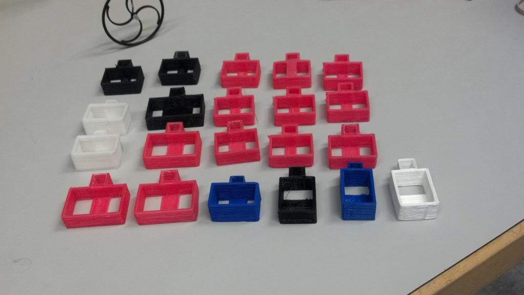

Here are just a few battery boxes I have made. It takes me about 5 minutes to design a new box. While 3D printing is slow I can still print a new box in about the time it takes to charge a battery. New battery? New size? No problem. That is what rapid prototyping is all about. Having made many boxes now for many people and that now includes a local hobby shop the one thing I need to know is dimensions of the battery AND where the wires come off the battery.

are you interested in one? this will fit any battery 2-3 cells 1000-2200 mah, I have these on hand now. they will not break or slide in a crash, unless you want them too. the way I set mine up, I glue the rear mount in place and then use the rubber band as a shock obsorber for a crash. it won't slide without destroying your airframe.
how about this, ill send you the stl file for free, and you can get your reprap buddy to print one off for you.
we also have a version that mounts on a popsicle stick (or carbon fiber rod, or we have a hinged version that you simply glue or bolt inside of the model)that mounts inside the airframe.
it is not only for slow sticks. we also have a laser cutter if you want to build a large heavy plywood mount for a slow stick like the first link,.that you also have to use velcro or several rubber bands anyways. this is not unique, its a plywood version of what the plane came with, but larger and much heavier. my mount takes up about 2 mm over the size of your battery.
I have one setup for either a 3000mah 4 cell or a 4000 mah 3 cell that I will soon be using in my 25 sized and larger models. I'm also working on designing one to hold 2-4 smaller 3 cells for use in .40 size and larger models.
