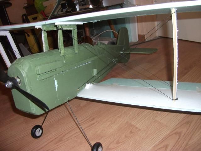

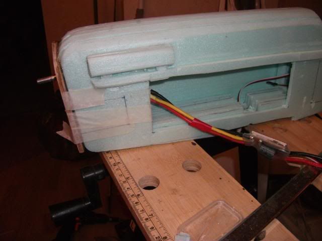

My SE5 - I scratchbuilt has a hatch in the fuselage side ...
You can see it here with the pull-tab ...
The front is held in place by a fixed tab and rear by sprung hatch latch.
Here's during building ...
I appreciate that mine has ample space and no formers to work round like a conventional build - but may help solve your problem. The beauty of this - the battery sits near the CoG ... allowing me to run a 1300 or a 2200 pack without CoG troubles.
