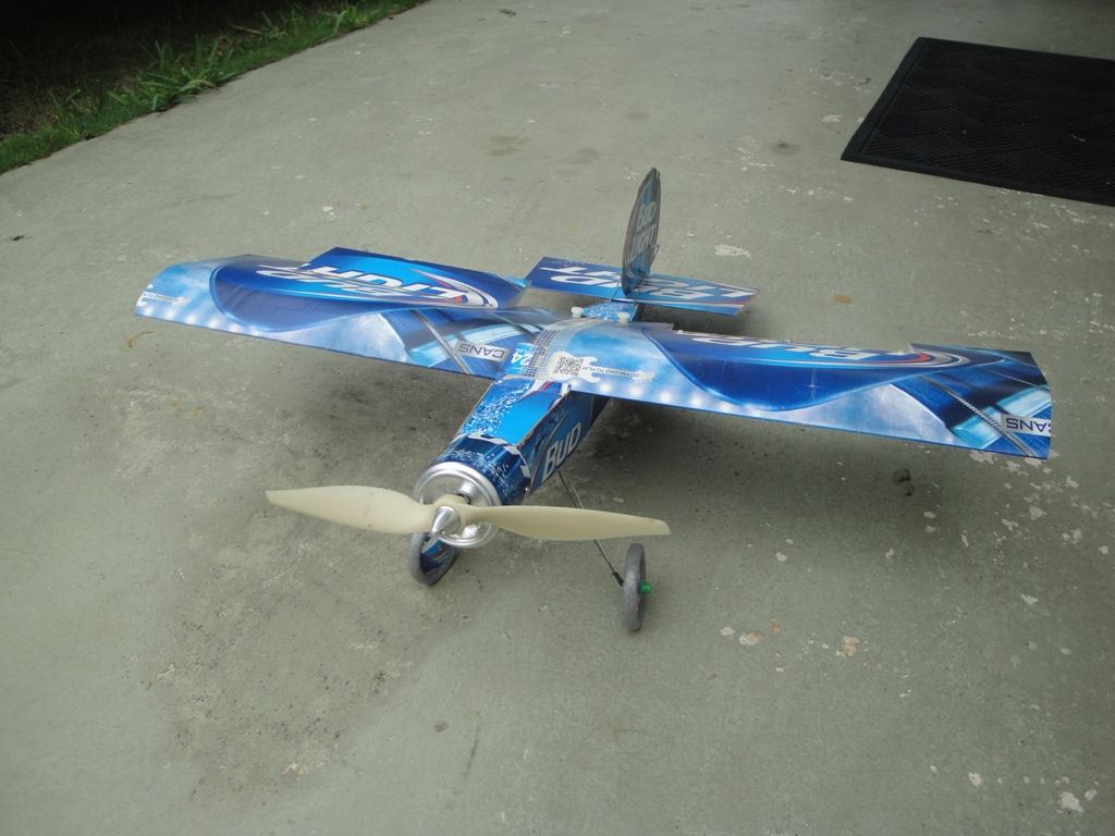

I'm making more progress on the plane than the posts, so here is the latest update. Mockup of airframe components to ascertain that the wing saddle doesn't have to be moved to make it work. I hate adding dead weight to a model, says poor design.
The fuselage and all its parts to check for weight and balance:
tail assembly ready to mount, kind of heavy.
top view nested.
looks like its gonna be fast.
Fuselage budlight case cardboard with 1/16” sq balsa stringers
Tail assemblies case cardboard and balsa w/ pinned nylon hinges
Airframe all up without landing gear 237 grams
FUSELAGE: The basic structure is almost entirely the exterior material comprising the strength and only uses 1/16” square balsa strip stringers to form a glue surface, Since the fuselage skin is cut first, the backwards logic of making the bulkheads and motor mount to fit the exterior is necessary to have a tight fit. I first matched the fuse sides and then glued the square strips to their edges – allowed to set, then the bottom was glued up attending to square and plumb alignment on the table in three steps just like the wing, center square section first – allowed to set, tail section, then the front end. The top covers are left off to facilitate the fitting of a firewall of scrap plywood, a built-up bulk just ahead of the wing mount, one behind the wing mount, one about where the front of the stabilizer will attach, and a piece of trailing edge balsa is fitted into the tail vee joint. The magnetic hatch is cut after the glues are all setup and done, reinforced with balsa strips and cardboard. Tail skid is glued up scrap piece of an expired credit card as well as the clamp for the landing gear wire. (That plastic will take a lot of punishment even after it won’t buy anything.) I used Elmer’s Yellow Wood Glue for about everything on this plane which means a lot of drying times when many steps are required, but it is very strong with cardboard construction. I did mount the wing attachment block and wire with 5 minute epoxy, because I wanted to finish the wing. Hope it doesn’t come back to bite me. To finish the fuselage, the bottom 1/3 or so of an 8 oz. BudLight can was used for the motor cowling. (Not always available, but available in Florida through the holidays the past three years, you might want to save a couple, I think I will.) This thing is bound to crash before I get tired of it.

Looks time is winding down, and I think the plane is ready, but my video equipment isn't, well, I guess I can always use the phone, but it won't be the same, I have a dumb phone.
Here's the cost and junk list:
BUDLIGHT Flyer - All beer case plane Marty Ivins Jan. 2014
Wingspan 30” 8-1/4” width and 1” chord w/large barndoor ailerons 239.5 sqin
Foam board ribs, skewers leading edge, 1/16 ” sq balsa trailing edge, pintype hidden robart hinges.
Airframe all up without landing gear 237 grams, all up ready to fly 550 grams.
Plane materials I had to purchase:
Control tubes and wires for tail & ailerons $3.00
Control horns tail $ .75
4-40 screws for motor and landing gear $1.80
Music wire for landing gear $1.19
Hinges for tail $1.99
Hinges for ailerons $3.48
Nylon wing screws $ .78
Foam board for ribs $1.00
Foam tire material (for 20 ft)used 6.5” $2.98
Misc scrap balsa for reinforcement and stringers $1.50
Glue , Elmer’s yellow wood glue (8 oz.) used 1 oz. $2.49
Build Cost $20.96
Complete cost of plane to include everything:
Motor $6.73
ESC $7.70
Battery $9.67
Prop $1.20
Hub $1.89
Servos 4 at 2.79 $11.16
Receiver $11.53
Hardware Cost $49.88
Total Airplane Cost $70.84
I know the electric part isn’t to count, but I added it up anyway!
I didn’t add in all the beer I had to drink up to get enough carton
Material to be able to match up the the logos.
Motor:
Spec.
Battery: 2~3 Cell /7.4~11.1V
RPM: 1200kv
Max current: 16A
No load current: 11.1V/0.8A
Weight: 57g
Diameter of shaft: 3mm
Dimensions: 30mmx50.7mm
ESC
Spec.
Weight: 22g
Max Current: 25A
Mini 9g servo
BATTERY
1000mAh 3S 11.1v 20C/30c Lipo Battery Pack
Basic construction scheme with beer carton build is an exo-skelaton design. Major structures of carton material are cut to finished size and glued to finished shape using various materials to form and reinforce the final contours of the design. (Its kinda backwards from typical airframe construction.)
WING: The ribs are fitted to the final covering to make the shape and glued into place, in this case in three steps: rear descending portion of the rib - allowed to set, front portion from chord apex to the leading edge notch – allowed to set, then wrapped over a BBQ skew – allowed to set. Wing is then fitted for dihedral – glued, reinforced with fiberglas drywall sticky tape – glued - allowed to set. Notches are cut for barn door ailerons with adequate room for leading and trailing edges of the mated surfaces – I used balsa strips glued and allowed to set – then cut the ailerons out of the wing. Since there is no free space at the joint in the hinged area and I didn’t want to slice any of the logo away, I elected to use Robart’s pin type hinges and notch the wing and aileron for a hidden hinge flush fit. Dual servos were used for adequate torque and simplicity.
LANDING GEAR: Music wire was bent to make a two piece sprung axle cradle fastened to the bottom of the fuselage with 4-40 screws and a scrap credit card mounting plate. Wheels and tires are made from beer carton material dampened then pressed into the indentation at the bottom of a beer car to shape the dished out portion of the wheel with two pieces per wheel. A dowel rod is center drilled to fit the axle and cut to fit inside the two dished halves of the wheel – glued, then fitted with the foam caulking saver strip material that has been half slit through glued around the edges. (Making these wheels is definitely more work than they’re worth, but after much disappointment, I just wouldn’t quit until I had something that worked.)
Weather is supposed to be good tomorrow, I'll attempt a maiden and con someone into videoing it for me. Wish me luck, I know it will fly, I just want to fly it more than once!!!!!!

Default It Flys!!!!!!!!!!!!
The Budlight Flyer does indeedy fly. A bit of adjusting, and tweaking, no twerking, should make it a nicely responsive flyer. I just had to get it in the air today, despite the much higher than predicted winds. Take off was at about 45 degrees and no roll tendency due to the way too active orange rxstabilizer. I forgot that even on significantly reduced transmitter input settings the stabilizer goes for the full throw at a average rate, and boy did it flex the ailerons. They quit flapping right and left as soon as I reduced the throttle to about 1/4 which was plenty for cruising and trimming. I elected to do a one turn around and land to prevent damage to the airframe. Nothing broke, but I landed pretty hot and my cameraman lost the plane in the sun.
I'll get some better video before the end of the month. It flys, what can I say?

Default Final proof of craft airworthyness video!
Well, we got some decent weather, and the new runway was to be complete today, which wasn't. Nor was the weather that outstanding; however with the help of Cush a very noob RC aircraft observer and great cinephotographer I have this the final chapter in the $75.00 Budlight Flyer contest chapter. I can't complain about the weather here in Southern Florida, so here it is on time and it does fly as designed. Not likely a winning entry, but a very eye catching and fun to fly entry. This plane will be my fun plane for the next few months. Marty
http://youtu.be/2m4CZBfPG5E
