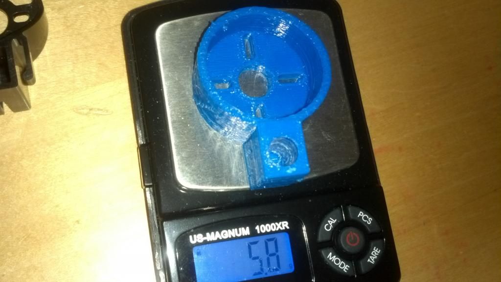

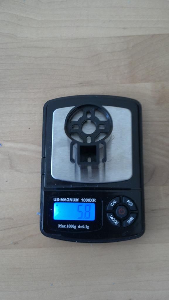

The way I came up with the idea of the open source airplane is a group of us started flying slowsticks in combat. We soon needed a reliably source of parts. Some of the parts that were failing were motor mounts, the fiberglass stick, and the landing gear. So to keep the carnage going I started to 3D print spare parts. It was not long and we were improving the origanal parts by making them stronger.
Here is an example of an improved GWS motor mount. The black motor mount on the left is a broken GWS motor mount. The motor mount on the right is a 3D printed repacement that is much stronger.
This motor mount was so weak that sometimes the motor mount would break instead of the propeller. Often the screw that held the motor mount in place would split the fiberglass stick.
The blue 3D printed motor mount just doesn't break unless it is a really bad crash.

One reason for the weak slow stick mount was weight savings. Powered as originally designed and flown the way it was intended it worked just fine.
They didn't really intend it for the abuse of RC combat though.

The GWS Black plastic mount is in fact a pattern mount and sold by many ... HK ... RCTimer ... etc.
I use these on high speed high power as well as low speed floaters. I have never had one sheer or break - even with serious thrust and crashes.
I have had the alloy ones break though in much less !
Given you can buy them in a bag for cents ... is it really worth it ?
What about converting to the flat plate stick mount that HK and others do ? Instead of the mount being slung UNDER / OVER the stick - it's a flat plate firewall mount with stick insert in the centre rear. This puts prop hub dead centre of stick and removes any offset thrust issues. It's also light and strong.

This picture shows the built in down thrust of 4 degrees.
RepRapper is offline

Default Motor Mounts and Weights
When I went to get a Slow Stick Motor Mount I found a couple of broken ones in the flight box. So they do break. If you use an APC prop a lot of times they break with one prop stike. If you couple that with the weak landing gear that comes on a slow stick and combat you go through a lot of motor mounts. My 3D printed mounts are a lot stronger and all weigh 5.8 grams and have down thrust. One of the things that make 3D printed parts so useful is you can make changes so easily. You can also change your print density from 0 to 99%. So you can pick your weight.
