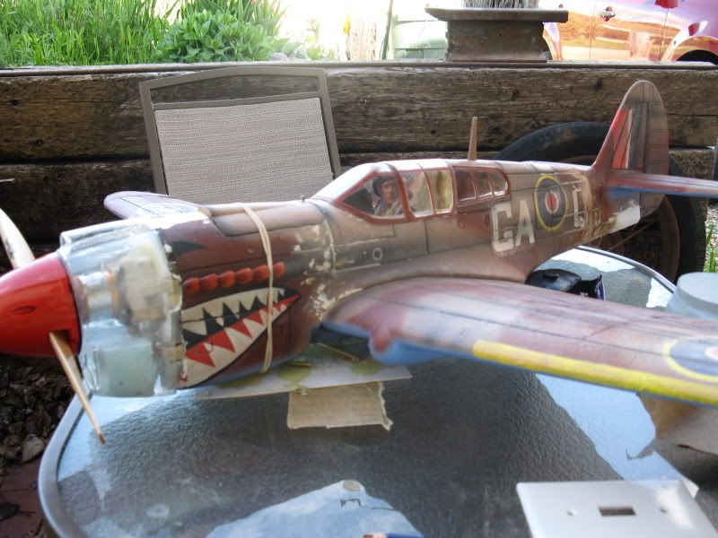

Now that I think some of the kinks are out of this pain in the a$$, time to repaint
I glued in a chunk of foam in the cowl and coated the inside w/5 minute. Might last more than a couple of flights now

Old 05-24-2011, 01:36 AM
  #260
TM4197
Dope&Fabric
TM4197's Avatar
Join Date: Jul 2009
Location: Virginia/Delaware
Posts: 1,355
Steve....
Dont paint that bad girl!! She looks battle worn Paint the cowling, rough it up and fly on. Damn thing looks like the real deal.
TM4197 is offline

Looks awesome. Mine looked the same way (clear cowl) just a few months ago! :o

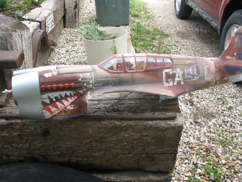

And a few hours later-
"Jigsaw 7, bogie's 6 o'clock!"
Still have to decal the port side and paint the bottom
Steve

LOOKS GREAT!! LOVE the DUKE!!

It really does look good. Where'd you get the extra shark's mouth decals? I had to order some additional ones directly from GWS, and have some extras in stock at www.KarglUSA.com if anyone needs any.

Thanks TM4197, LT. I painted the first set of teeth, so I still had the Flying Tigers style on the decal sheet. One thing that I couldn't live with is that the eye that's in the kit, so I painted the more correct eyeball
Its going to rain here all day, so I'll probably be done with her tonight
