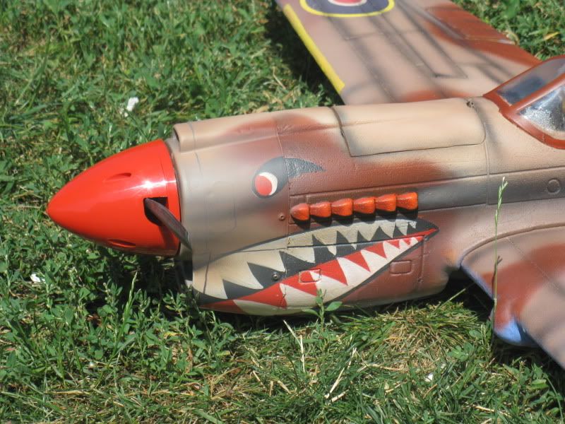

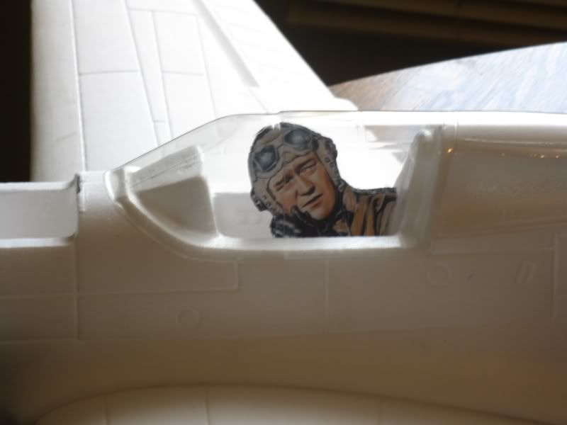

Old 08-02-2010, 06:38 PM
  #236
MIG17
MIG17's Avatar
Posts: 39
Never built a GWS foamy, went to together pretty easy.
I was going to do a Flying Tigers scheme, so John Wayne was the obvious pilot.
Opted for higher vis desert scheme, loosely based on 112 Squadron
Brush painted, (#4 lettering quill) teeth
I can't have John Wayne in a British machine, thats just godam un-American! So Michael Caine stepped up. (I see there is some moisture still from the Elmers glue, or he's got a girl in there, I'll get a better picture when it dries out)
Steve
MIG17 is offline

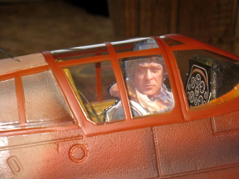

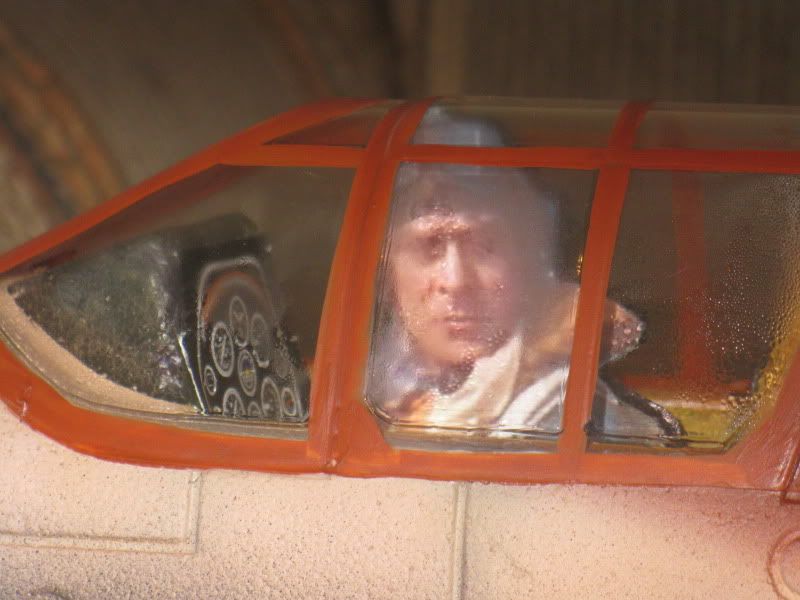

Old 08-03-2010, 02:35 PM
  #239
MIG17
MIG17's Avatar
Posts: 39
Thanks! Heres a better picture of Sq Leader Canfield
"The engine's overheating, and so am I!"
Steve

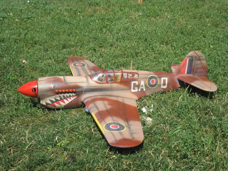

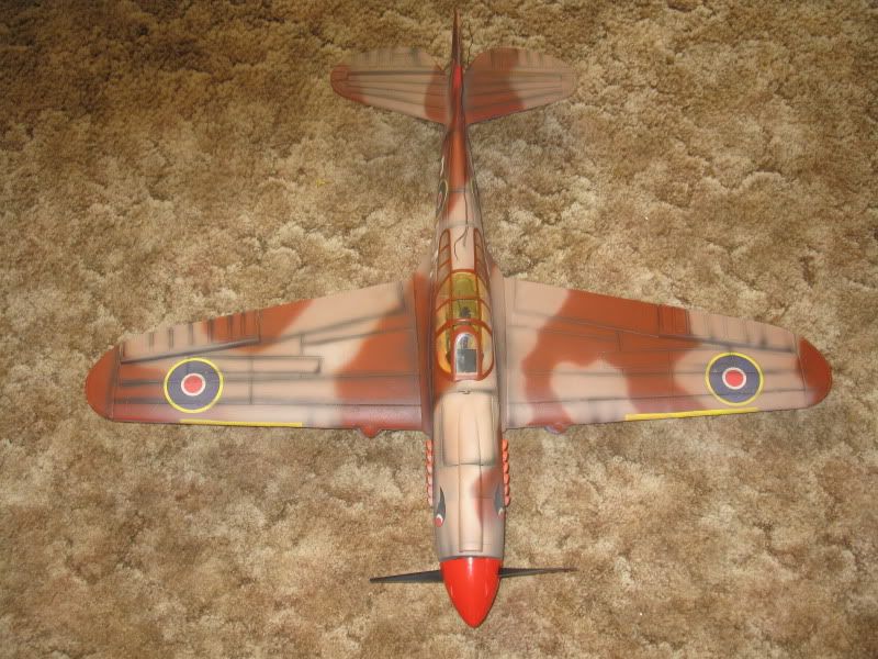

Old 08-08-2010, 10:07 PM
  #246
odieyodie
odieyodie's Avatar
Join Date: May 2009
Location: Lincoln, Nebraska (summer) Casa Grande AZ. (winter)
Posts: 170
Default GWS P-40 Pics
As promised here are some pics of my GWS P-40. I have not added the shark teeth yet and the stripes on the bottom were air brushed on so that my tired old eyes could see it.
Many thanks to the Lieutenant for his advice.
Tommy T. aka odieyodie
