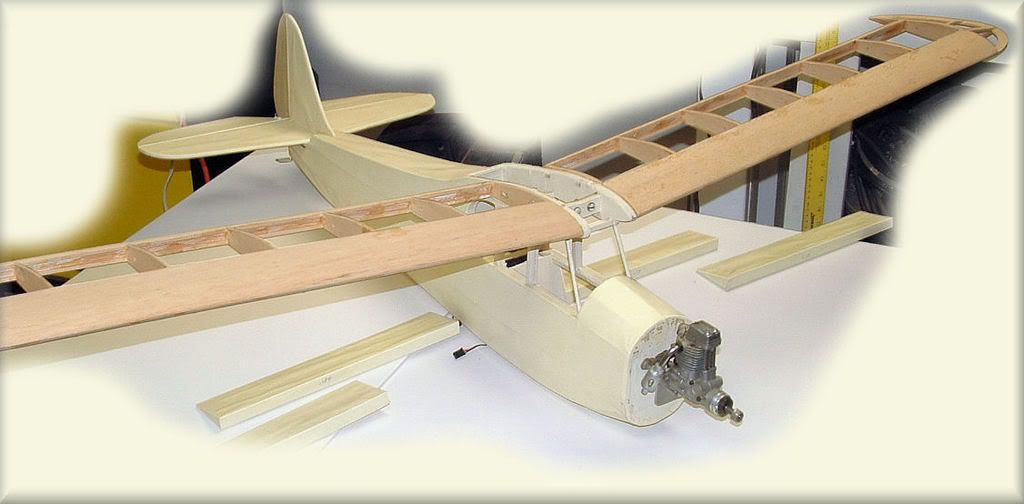

Default My Hat is off to you!
Originally Posted by salat View Post
I'm author of http://academodel.ru/plans
Server is keeping shutting down sometimes. Please do not worry, I'm working on that. No need to dump entire site because I'm going to keep this site forever and I have backup copy of all files. Contributions for plans not listed there welcomed as long as complaints about broken files (there are some there)
You have done a wonderful job of inventorying those plans!! and there are hundereds of some of the best old time rubber plans I have seen. I finally found an easy way to tile print a PDF ( I posted the details in another thread.) And have already nearly built my 72" Aeronca Chief. I just had to "wing it" from memory the first 72" Chief I built and even though it wasn't an exact copy of the Comet 54', it flew fantastic.
This one will be several times better as it is way lighter and stronger.
I'm attaching a current pic or two

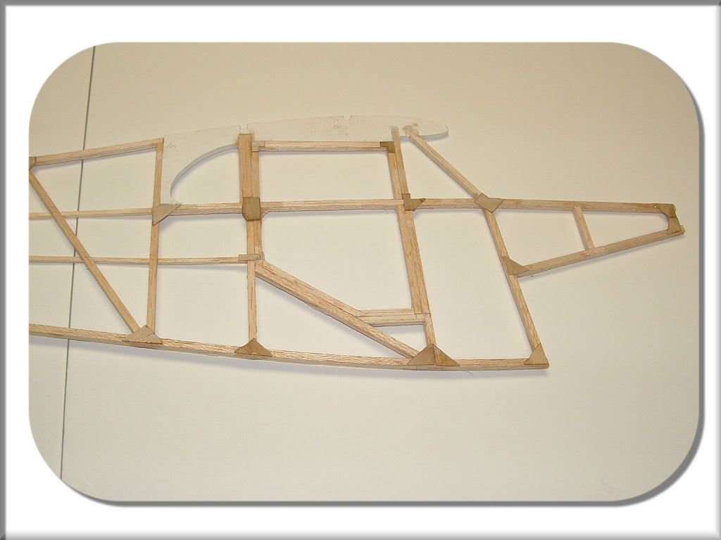

Default NEW? building method?
Originally Posted by pd1 View Post
It's looking good.
I built the Comet Taylorcraft and had a few problems when I joined the fuselage sides.
The Taylorcraft and the Chief are very similar in construction.
The top longeron kept separating from the door frame when I brought the fuselages sides together at the nose.
If I had it to do over again. I would have made the top longeron go from front to rear in one piece. Then If I really had to have doors that opened, I'd cut the longeron after the nose was brought together and additional structure was added.
Paul
ps. I like your use of foamboard.
Thanks Paul, I found some distinct advantages to its use.. I found a {new?} way to inlay a dowel in the perimeter of the flying surfaces and it makes for a very light , good looking and strong surface. Its very easy to do and quick.

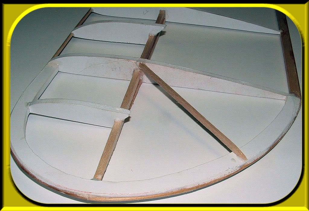

Take a look at what happens if you don't either fully paint or cover and finish this new building method I brought out..
This did not happen on surfaces without dowel edging and only to a mild degree if they had been finished in some way (ie painted or covered etc)
Suspect. The dowel is a hardwood (Birch) and has a different shrink coefficient than the balsa hinge strip and different than the foam itself.
If encased in a few layers of acrylic, the warp is only slight and in small surfaces like the Skampy, was non existent....but crank up the size and this happens. I gave up and tried to cover with an iron-on but surface is simply ruined.
Will have to tear them off and build new ones, covering immediately or just build an open surface (it would be lighter still).....but other than for the huge "honeydew" list my wife handed me when I suddenly had more time, I should be able to get this bird (and several others I started) soon to a completion stage.

Default This, I believe is better...and lighter still!
Anyone can do this, all you need is the foamcore board (or depron) and a balsa stripper that uses an xacto blade to strip off whatever thickness you need. Begin with a piece of say, 1/16 or 3/32 sheet and set the stripper to the thickness of the foam and strip off a few strips (whatever you need for the wing, stab, elev rudder etc.) after cutting surface outline ,then take a sanding block with 150 and square the edges.Use Gorrilla glue (new clear stuff) and only use a very small amount on edge. The thinner the original balsa stock, the easier the unwet balsa will bend to the outside of your surface piece.As you start from one end , use Blue painters tape (2") to anchor the end to starting point. as you bend strip to meet edge it will be glued with the glue you put on earlier. as you continue bending strip, keep putting strips (youve previously torn off and tack-struck to your bench edge--makes it handy) of tape on strip to make it lay down on edge of surface. You will eventually get all the way around surface and the strip will be perfectly tacked down until glue dries.
then peel off tape and sand away excess glue. and round edge with sanding block (here a 200-320 grit is good) and then sand whole surface to smooth).
This is a whale of a lot easier to do than to describe.
You can wet/soak-with windshield washer fluid, the balsa strip if you have a really tight radius to turn....but dry is faster for gentle radius'.
This beats the birch dowel, is more readily available, easier and lighter....but just not as tough (impact resistance) but will probably prevent what happened in above pics.
