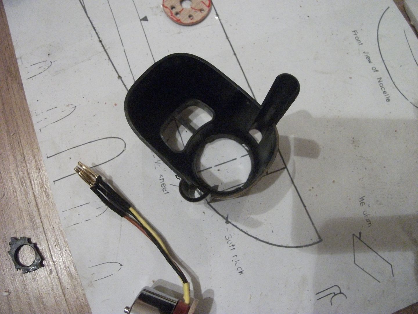

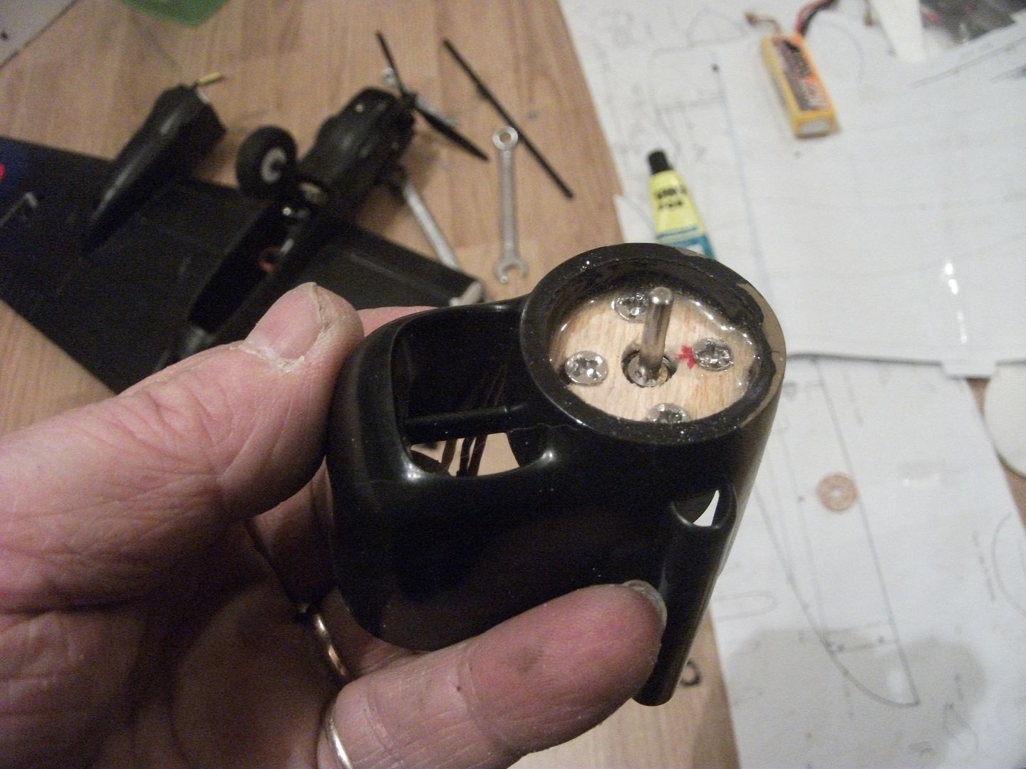

I had never taken the cowls of to see the motor mounts. That was a surprise to see how they mount !
The motors are front face mounted to plastic X as part of the cowl moulding. The damaged mount of course was that plastic X had just snapped out. I carefully fashioned a disc of 2mm liteply .... to fit up insude against the ridge. I filed away the last buts of the plastic X .... epoxied the ply disc in and then mounted the motor. Perfect AND it brought spinner close to cowl. Only downside was that awful shaft adaptor and the two threads stripped ! So loctite as a temporary solution till I get new adaptors ..... edf's use same adaptors.

Motor cowl with broken X to the left :
Motor bolted to new ply disc :
Disc and motor in cowl ready to epoxy :
Epoxied and finished ready to refit :

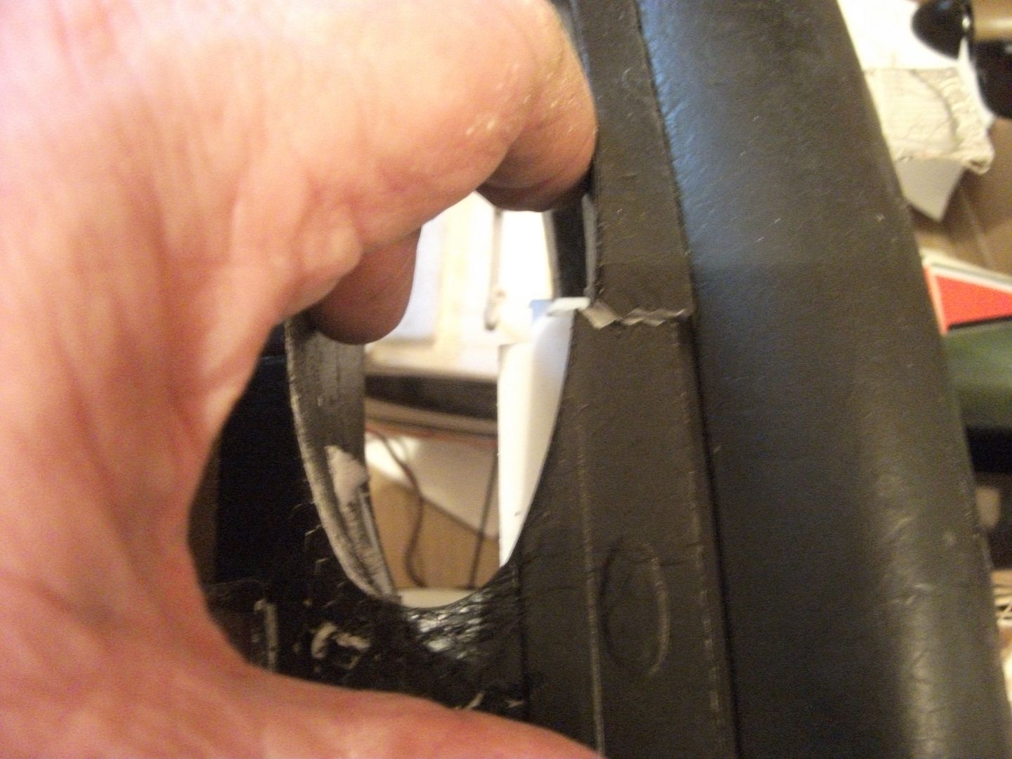

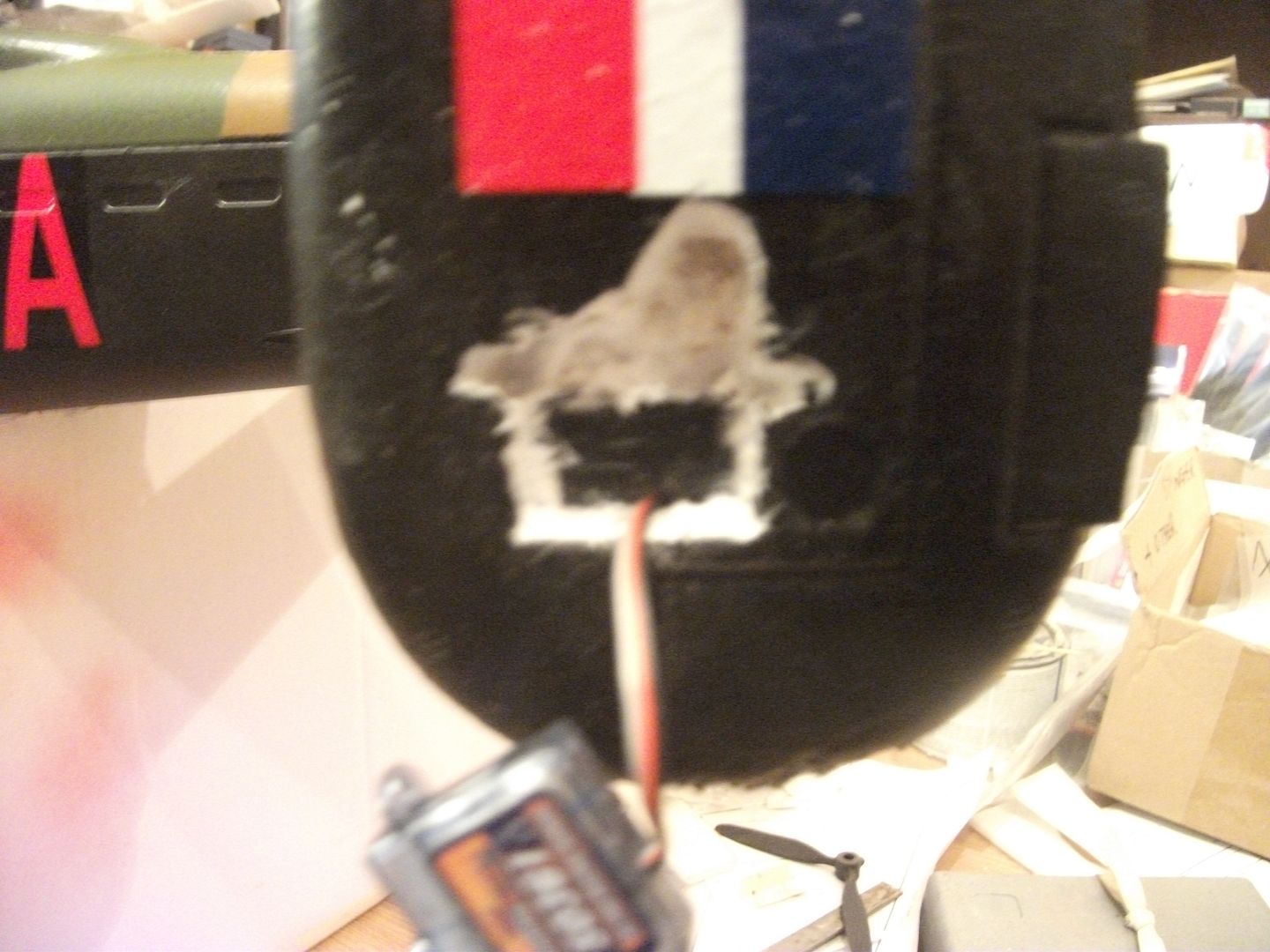

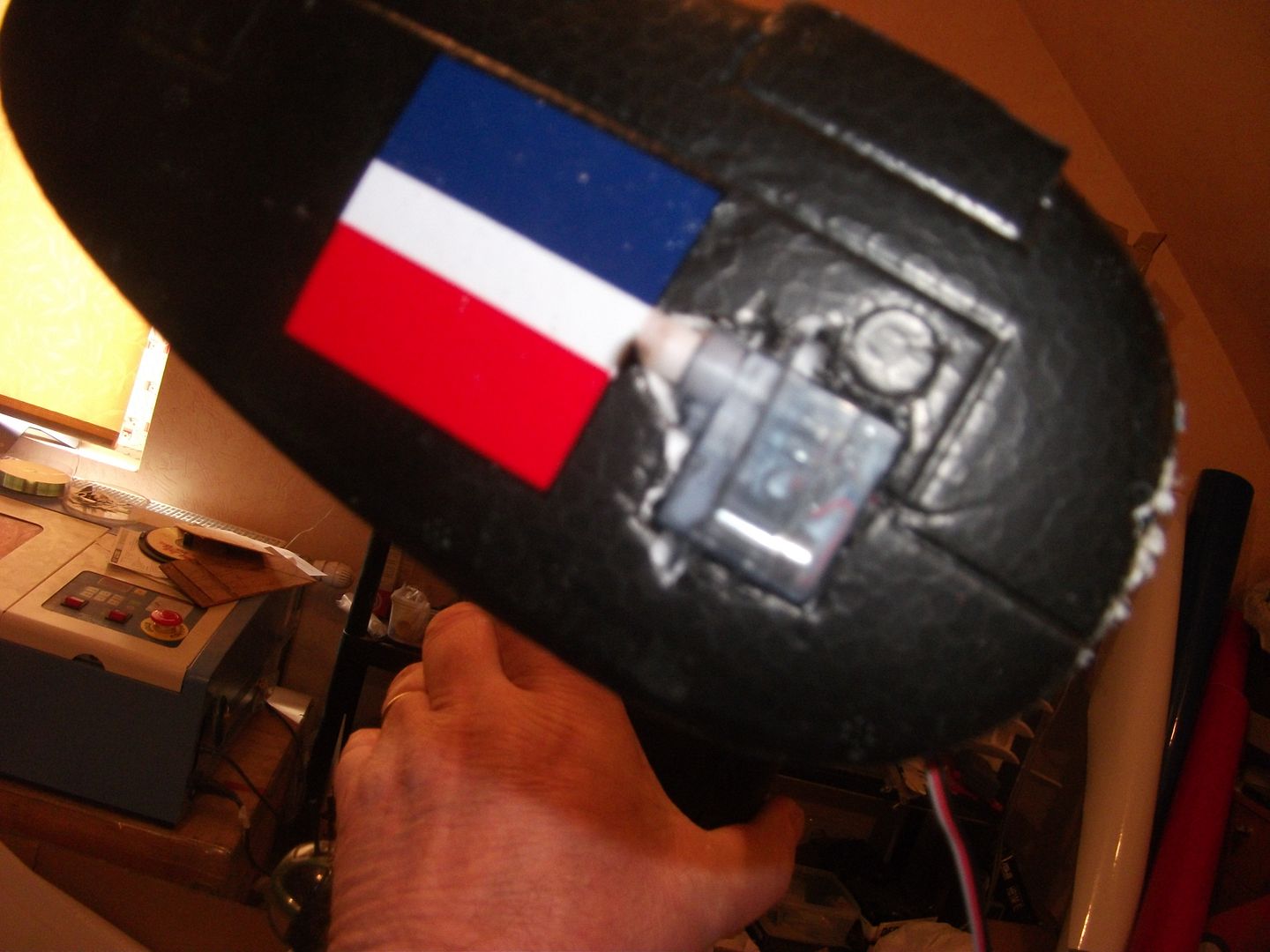

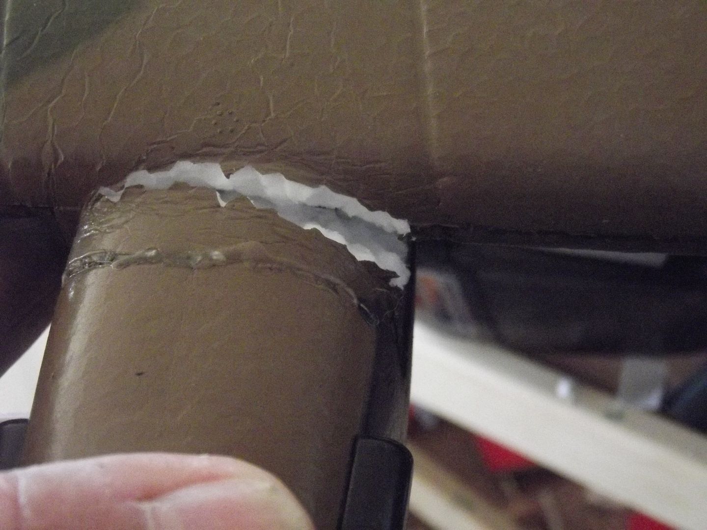

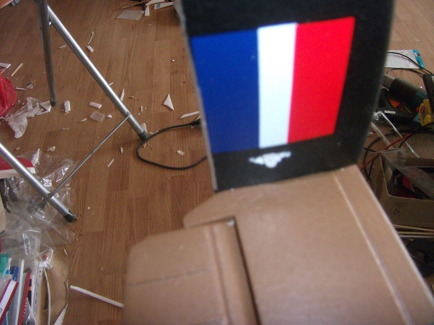

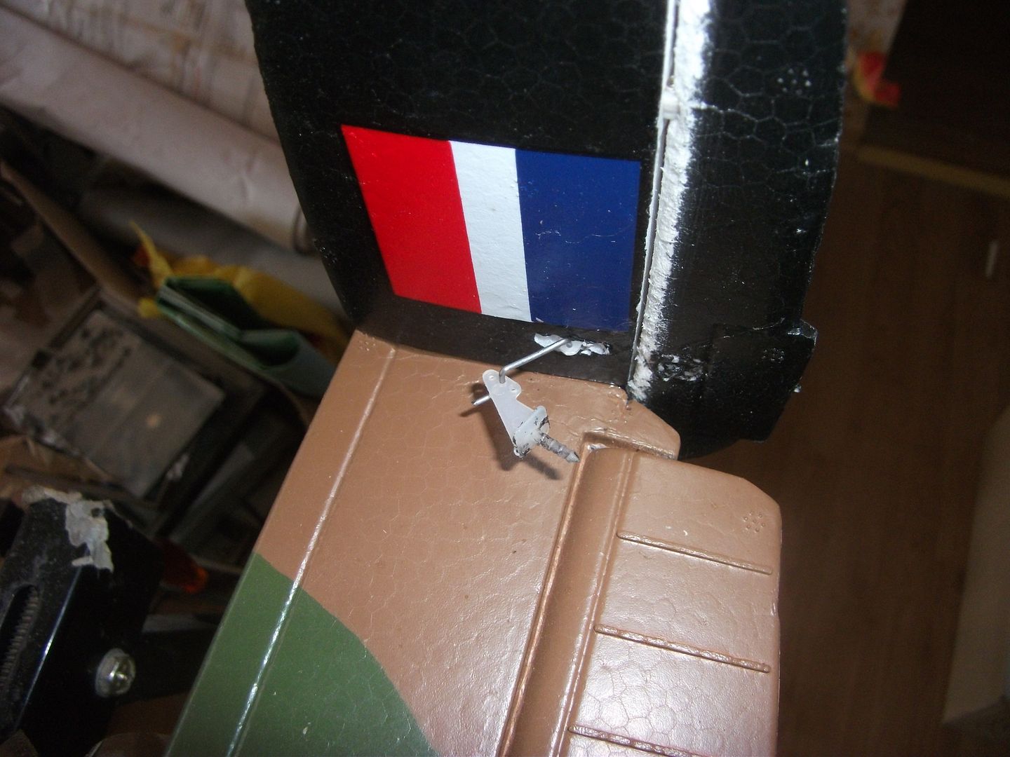

Well my mini 4.5gr servos arrived ... so :
Ok ...
tiny servos to embed into fins ...
Leads exit below stab... and then will lay under stab to Y into prepared lead through fuselage.
Using the longer arms on the servo allows me to have link inside fin instead of external ..
Indoor model horns are good and small ...
Pin hinges used ..
Rudders in place waiting for glue to set ..
Fixed links with Z bends ... if adjustment needed - will bend to suit...
Just need to wire up .. glue horns into rudders and then test. Fingers crossed that servos direction matches tail wheel !! Bet it doesn't.
More to come ...

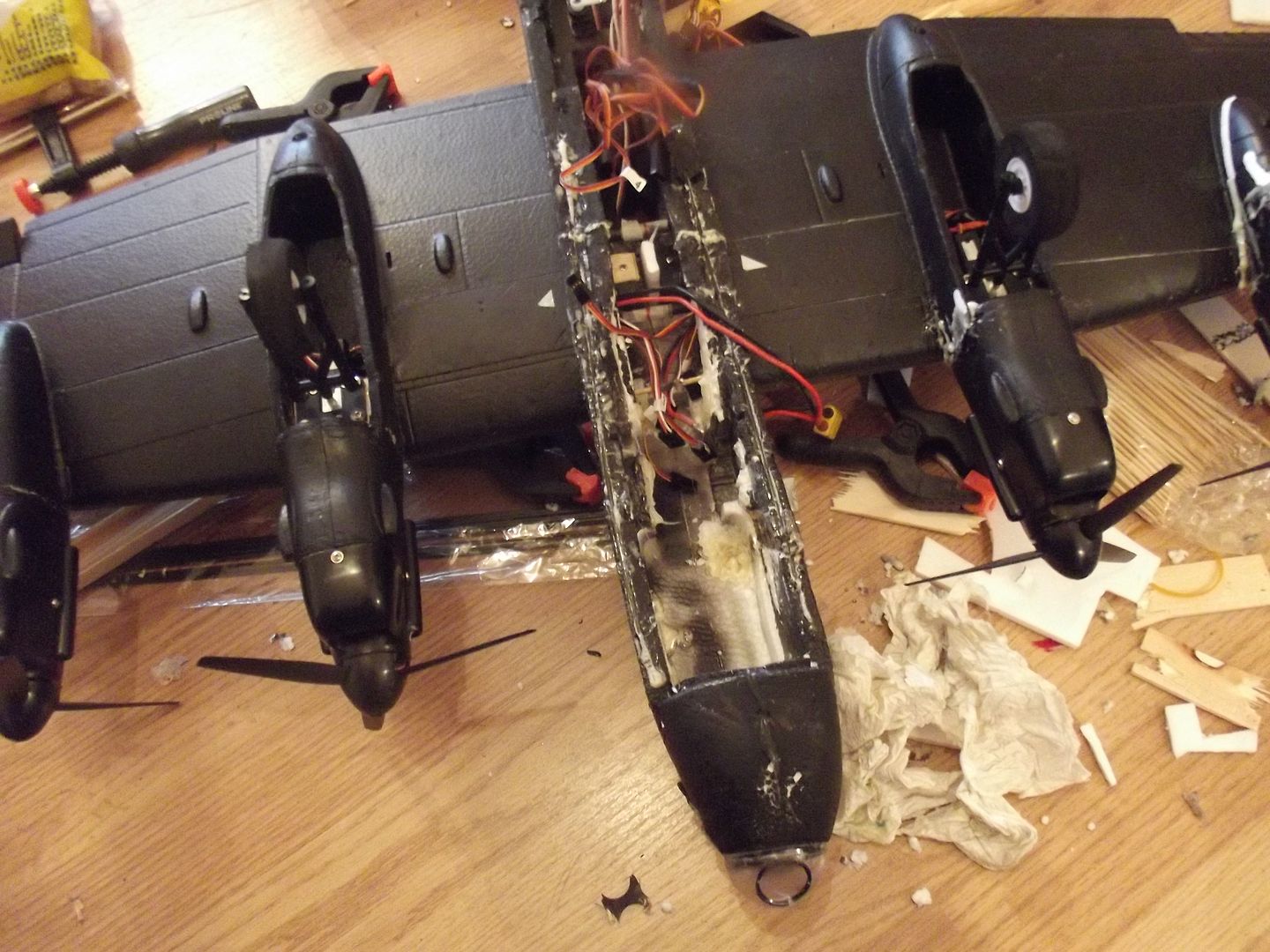

10 June 2017 .............
TV guy videos my Lanc .. all fine ... but silly me - I put in one of my tired old batterys instead of a good one ... TV guy thanks me for flying and I decide to carry on for a few more minutes. Battery dies and in she goes !
So here's the repair story as it unfolds :
OK ... typical split and folded front end :
Nacelles c racked joints :
Fuselage typical failure at weak area at wing with usual nose UP result ...
Once breaks and splits sorted ... fuselage will have stiff bars clamped along to bring back to uniform straight :
Here's bomb doors still intact but hinges popped ....
Battery box removed and its unplug all the bits ..
I decided to remove wings and here you see the wood pegs I use when rigged to reduce the movement of wings in the root pockets :
Wings removed :
Here you see the 'nose UP' crash result !
Typical broken wing seat :

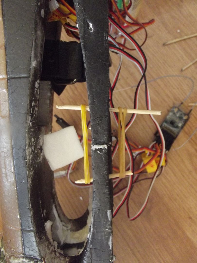

How to hold broken foam together while glue sets ....
Foam modellers best friends .... thin BBQ sticks !
OK - both wing seats now with PU glue setting up with peg & band holding all in position ..
Nacelles - how to close and keep them straight while PU glue sets :
Once these are set ... takes about 1hr for PU to go off enough to be workable ... I will then start on straightening the fuselage.
I have a few short vids that will go on here as well.

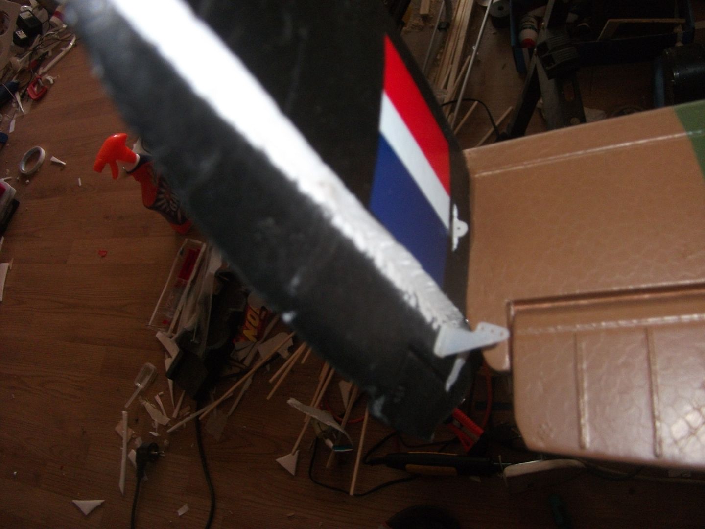

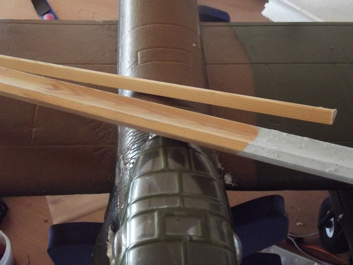

OK ... most of the splits and cracks have been PU filled and now its time to straighten that fuselage line.
While clamped - knife blade runs along to create a slot and a 2mm CF rod set in ... glued with PU ..
I have removed the plywood tray from the front and will replace with my own to create a support structure to maintain straight form. Once battery box goes back in - will be back in business.
One side though has had too much damage to actually get it fully back to form again - so will be looking as to ways to sort. The top of fuselage just below the cockpit glazing is a box affair with inner moulding and this prevents getting side back to shape again. Maybe I will cut out a section inside to be glued back once side is sorted.
Like most repairs - we start with an idea and modify / alter as we go. In terms of weight gain - this will be minimal and anyway - I can always remove the metal disc weight up front if needed.

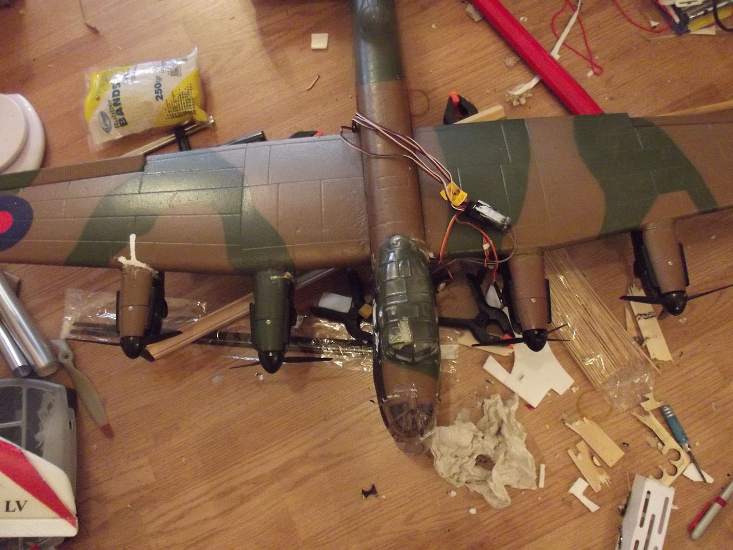

Coming along ... trouble is I have a lot of work to do and I cannot devote time to the repair ... so I jump from my Home Office to the model room when I can ...
The ply plate I will cut will be also with depron formers to get the final shape to the front end removing that last 'bow' ... and it will also be helped by the refit of the battery box.

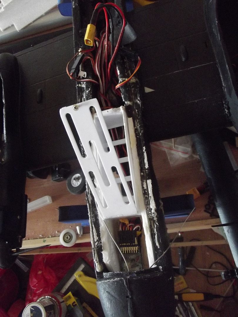

Depron sides added to stiffen along with a ply shelf ...
Battery box back in ..
Rx back in and all leads fed through ..
Because she's getting on in age - decided that modification to bomb doors was OK ... so I only need enough to get to battery box and wing bolts. FRont and back sections glued in place and held while PU sets up.
Once done - I will pin hinge the doors over the battery area as well as my BBQ skewer pins through Fuselage and wings to stop any 'skewing' as the wings are somewhat loose now.
