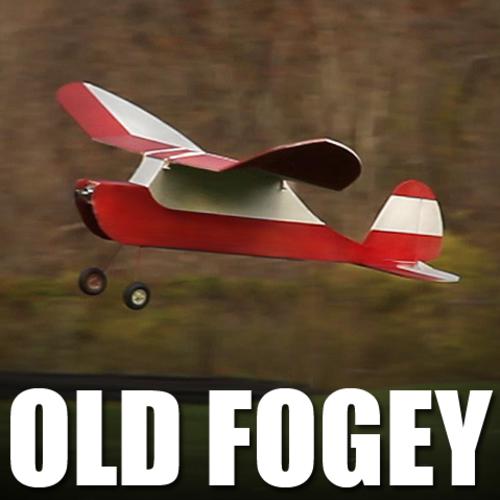

Polyhedral (like the Old Fogey or the first of your 3D sketches) is a little more efficient that conventional 'straight dihedral because it places the dihedral close to the tips where it is more effective due to having a longer lever arm to work on. This is why you see it often used on RC sailplanes.
