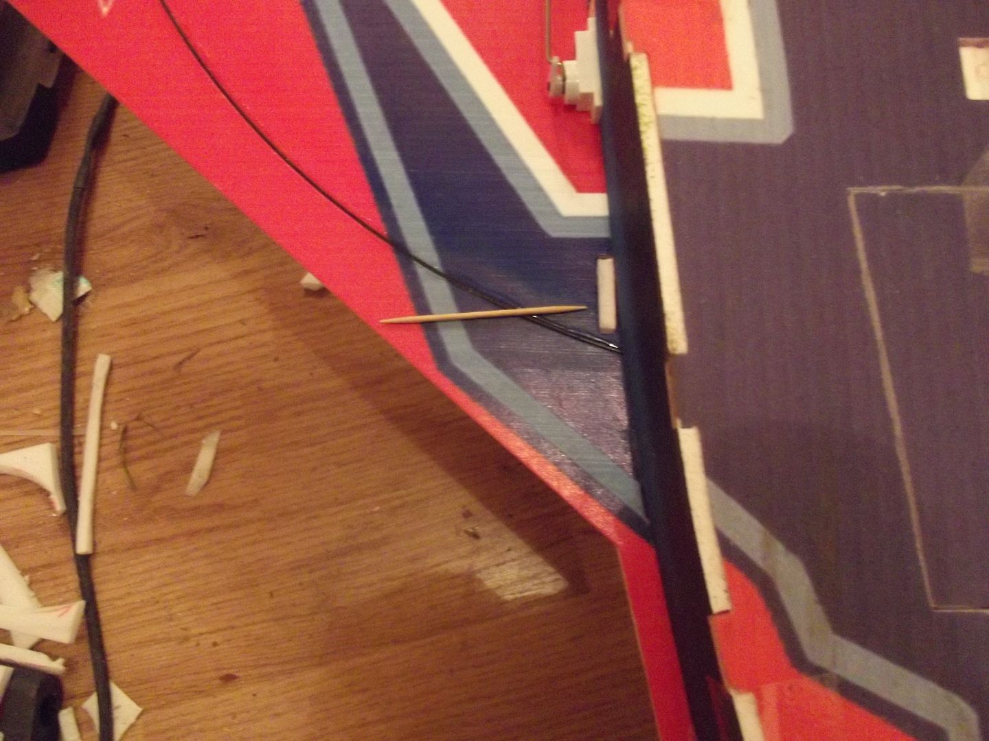

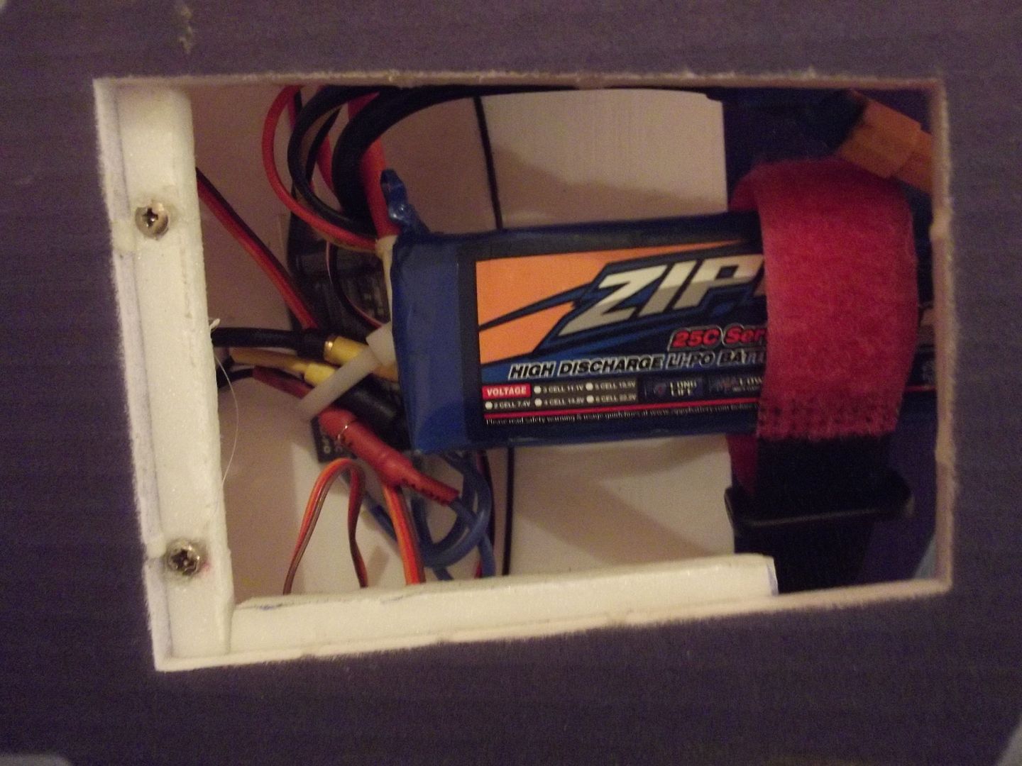

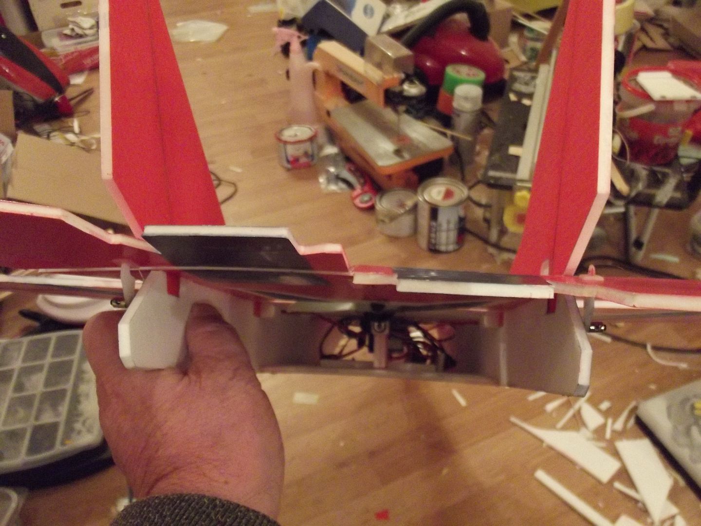

Old 01-31-2017, 10:15 AM
Posts: 12,370
OK here's some photos taken ....
Placement of the 2200 LiPo as far forward in the box as possible ...
Cocktail stick pointing at CoG position :
View inside box trying to show items :
Finally ... massive trim adjustment !! Trying to understand why because its opposite to torque expected ...
Hope this helps anyone.
But its a great flyer ...
