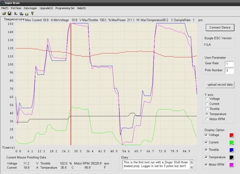

I can tell you that I've run a Turnigy 2217-20 motor on my Slow Stick for three years and the $13.00 motor has been a 200W beast. It has a quality finish that impresses, tons of power, 20 minutes of duration on a 3S 1350mAh battery. I could have spent three times as much money and not got a better motor.
I run a Turnigy NTM 35-30A 1400Kv motor on my Grim Reaper and it's been 560W of flawless performance for $18.00. That's a quarter the price of the name brands and you won't get four times better for spending the difference for a different name painted on the can. This is a proven motor, used on hundreds of combat flying wings with great success.
That being said, Turnigy sells both good and not so good motors. Check out threads here and elsewhere, read the customer feedback. A little research can save you major money over the "default" Eflite alternative, which is adequate, but not stellar, in quality.
Since this is a non-standard installation where you can't readily check to see what everybody else with the plane is using (a cheap way to engineer a power system provided the information is credible), I recommend you buy a wattmeter and then go one step further to buy a data logging ESC. The data logging ESC gives you real world, in flight performance data, which is often very different from test stand data. You get continuous graphs of battery voltage, amps drawn, rpm, throttle position and ESC temperature for an entire flight. It's the true gold standard. I bought my Turnigy Super Brain 40A data logging ESC for less than $30. It also has been stellar and is the ESC I use for maidening all airplanes. It's overkill for a 20A Slow Stick, but you can replace the ESC with another of a more appropriate size when you have the data you need. It's been the single best expenditure I've had in the hobby.
Here's a graph of a test stand run of the Turnigy 2217-20.
