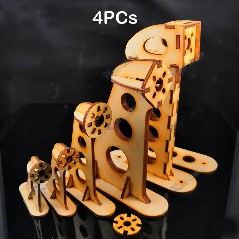

The old way was to create two curved legs that were held by the wing band rods ... or with a plate under just the bands,
Another was to make a leg that had two holes matching the wing spars ... slide over the spars ... join wing trapping the leg on centre line.
The usual shape was like a curved triangle with motor sitting over the CoG so it didn't upset the balance ... prop often on the front as a tractor.
For thrust lines etc. - I would suggest having a look at the Bixler and similar where top mounted pod motors are used.
These any good to you ?
https://www.aliexpress.com/i/33030644903.html
At least they give an idea for CIY ...
