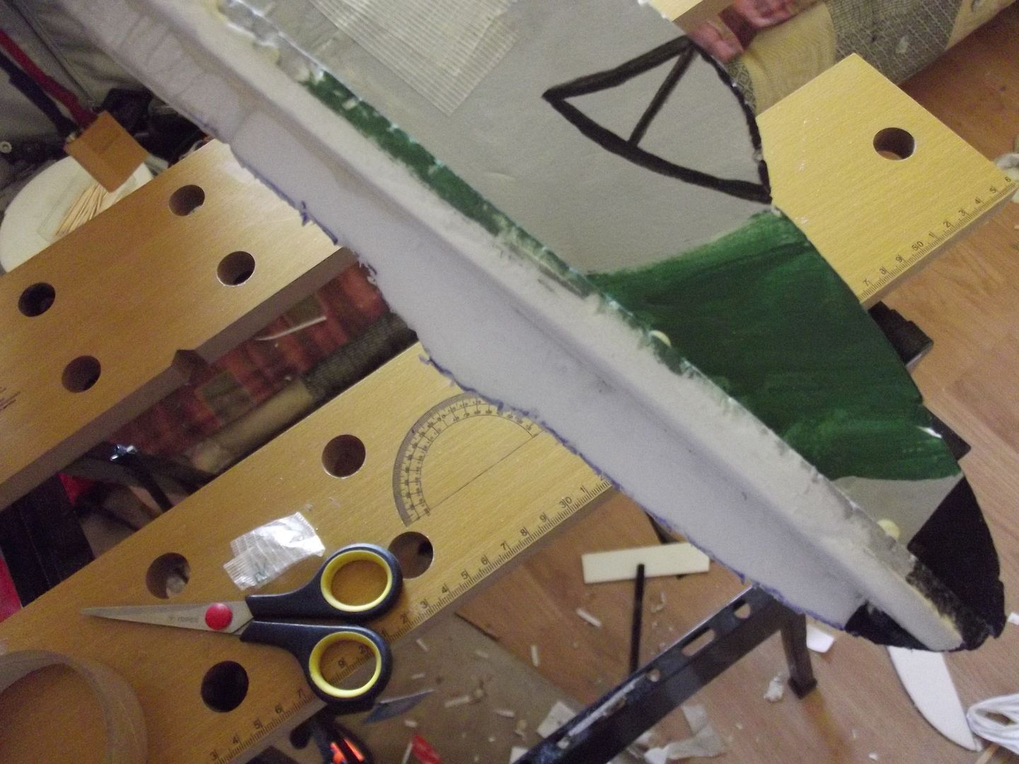

Now cutting second sections for doubling ... decided that a full double thick wing may be better... this allows me to case the CF between, while having the two sheets glued stiffens a lot as well.
12mm wing depth .. I can bury the servos more.
Old 06-18-2019, 05:24 PM
Posts: 12,370
Serious CF spar work embedded before laminating the two wing sheets :
Doubled wing ... doubled fuselage ...
Boy is this baby STIFF !!
