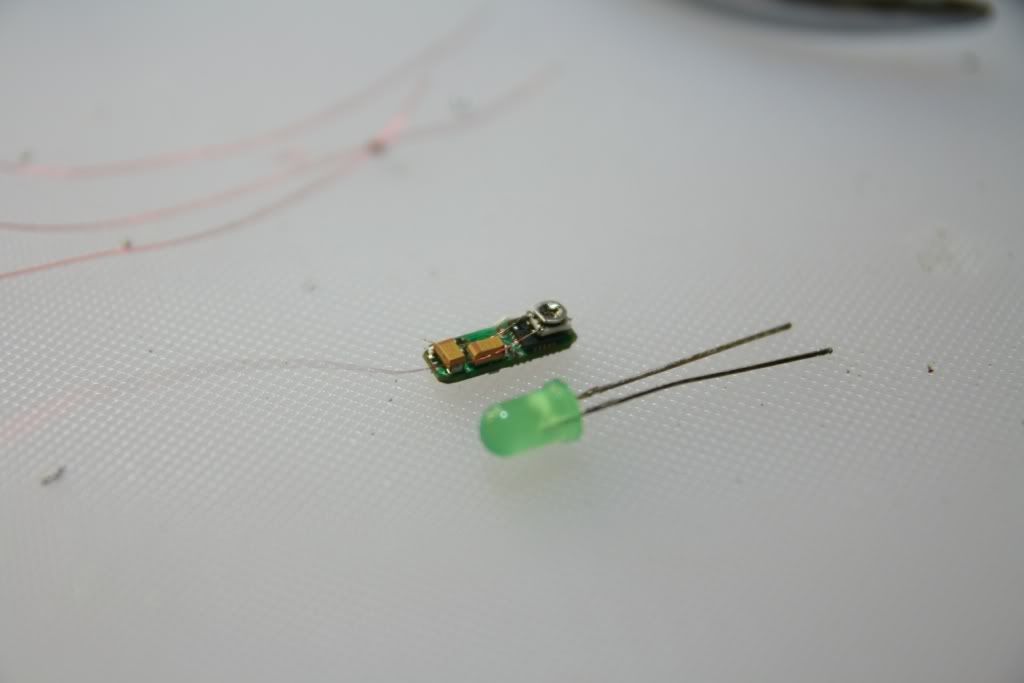

To complete the circuit, i added a 2nd walkera 4#3 servo controller board that will drive the aileron magnetic actuator. Here she is with the trim pot added. I used thin wires to make it light.
Adding the rest of the wires that will connect this controller to the aileron channel of the 4#3 2.4Ghz 4-in-1

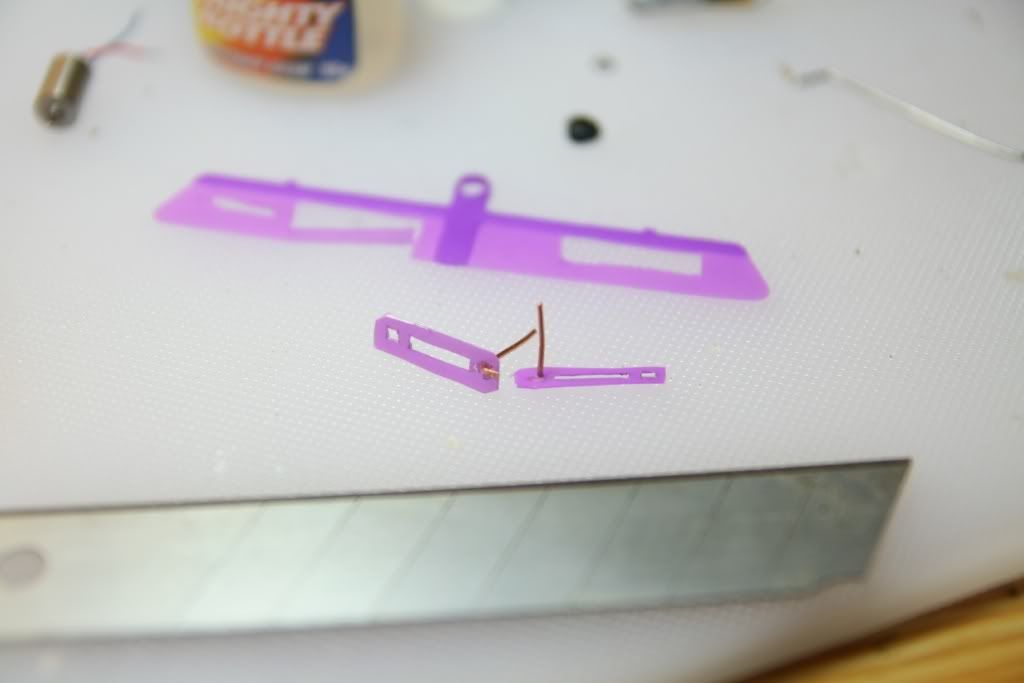

Now for the slide pin, instead of metal, i used thin hard plastics. Specifically a tail fin from an X-twin plane;
Using a knife cutter, i made two "plastic slide pins" for the aileron and elevator channel. I used a thin solid copper wire as poles so that i could easily bend them when the time comes in "fine-tuning" the cyclics;
