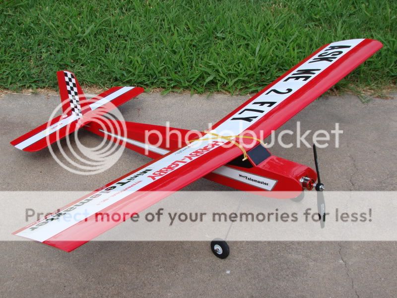

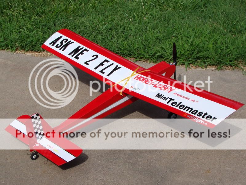

Hi: Well due to the snow falling almost every day of December, I have been inside my hobby room building my first KIT model, the Mini Telemaster. I have built 3 ARF Senior Telemaster 8ft. Wing span and ONE 12ft. ARF Telemaster. I use the 12ft. Wing span TM for training and taking Videos for the Forest Service. The Telemaster is without a doubt one of the most stable and consistent RC model planes I have ever flown.
If you are a first time builder of the Mini Telemaster might I suggest you go to Hobby Lobby and download the instruction manual for the " ARF Mini Telemaster"? The instructions that come with the Mini Kit are very lacking in photos but the ARF version will give you a lot of photos and insight into what the poor mini plans lack. I would not have been able to complete the kit without reading and seeing photos of the Mini on this forum. A million thanks to all that have contributed there impute to the Mini Telemaster build forum.
Thank You
Izzak

Issak - it looks great! Nothing flies like a Telemaster....
