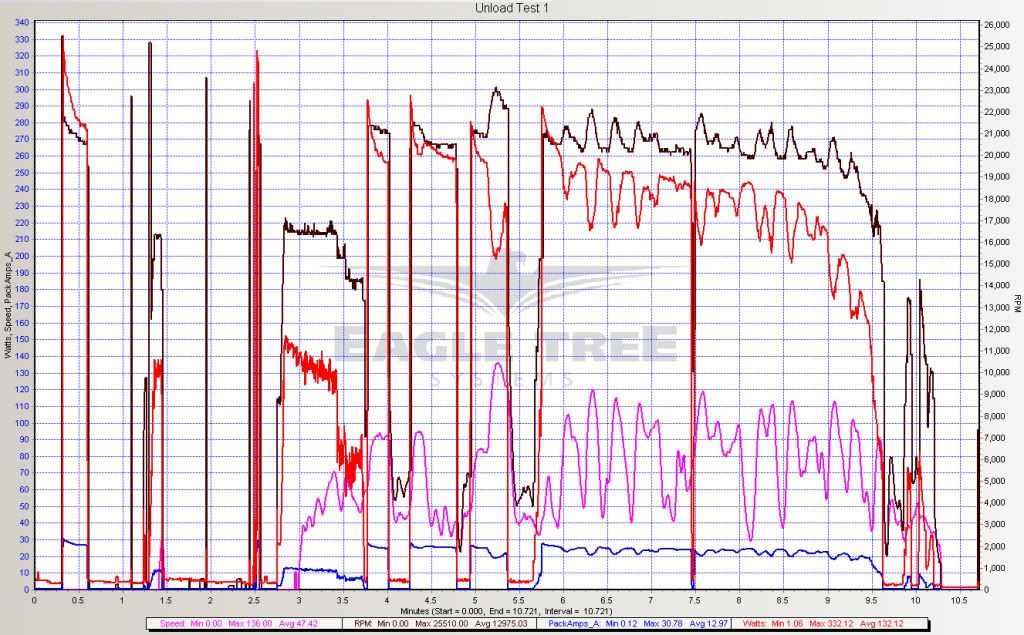

Old 09-19-2008, 07:32 PM
Tram
Purveyor of EPP goodness.
Tram's Avatar
Posts: 249
Larry-
I've performed the test you laid out..
1)Plug in the pack and do a full power static run up for 5-10 seconds then chop the throttle.
Can be seen in the graph from around .25 to .60 minutes is the static run.. I did 20 seconds worth..
2)Take off and climb to altitude at a lower throttle setting and get lined up for a speed run.
2.75min indicates the actual launch.. Everything between is a botched launch, I was trying to keep the throttle low and the VecJet needs some push on the launch..
3)allow the plane to slow down as much as possible without stalling then briefly chop the throttle then go imediately to a full power straight and level run for say 10-20 seconds. At the end chop the throttle again briefly.
3.75min is the chop then back to full.. Followed by a level run at 3.75 to 4.0min..
4)get lined up again for a speed run then chop the throttle and go back to full. Fly level for 5 seconds, then pull to a full power vertical for as long as possible. Chop the throttle again.
This is exhibited at 4.25 to 4.75.. Looks like we may have reversed the time of the runs in part 3 and part four..
This is the vertical climb, as exhibited by the drop in speed.. This thing gets high, quick.. Also gets very small..
5) stay up hi as and in fact climb as far as you dare - then chop throttle again and go back full. Now start a full speed level run for say 5 seconds and then go into a full power dive and hold it as long as you can then chop throttle.
[/quote]
Throttle is off from 4.75 until ~4.85 and then the full throttle, vertical dive is commenced.. Recording a 136mph dive..
From just shy of 5.5 to the end of the recording is me just out and playing around with the plane.. Had juice in the batts, not gonna waste a flight..
Here is the graph..

Originally Posted by Tram View Post
Larry-
Here is the graph..
[/quote]
Excelent!
Can you attach the data file here or send it to me again? Id like to be able to zoom in and get exact numbers at specific times.
Thanks!

Im specifically and mostly concerned with whats causing the power drop off in the air compared to static - is it the unloading or is it mostly battery voltage drop - or some combination.
Secondly - are there some prop diameter/pitch ratios that act differently than others?

Still have any of those old graphs or data files laying around Charles? Thats what Id like to see.
Im not really saying that props dont do some unloading - especially in a dive situation. Although Id still like to see some actual data
Im more focused on power side of it.
How many times have we heard some one say something like this:
"Im pulling 60 amps static and I know my motor, packs and esc are only rated for 45 amps - BUT it will unload in the air so I'll be fine."
Then they show an Eagle Tree graph where the power drops off dramatically during the first few seconds of the flight and say - "See - that proves it".
On the one hand - who really cares WHY the power drop occurs. If the power goes down to a safe enough level once he's in the air - then he IS fine.
Im still curious about the real why. I believe that power drop is largely due to voltage sag rather than unloading.
