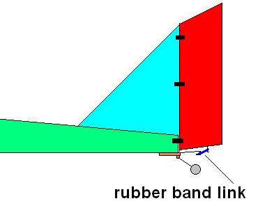

The rear wheel is a personal choice ...
For a safer and less stress version for rudder :
The above puts the stress to the fuselage instead of to the rudder hinges.
On this model I chose different but wished later I hadn't ... I mounted the wheel via a wire leg into the rudder itself ... this stresses the rudder hinges ...
