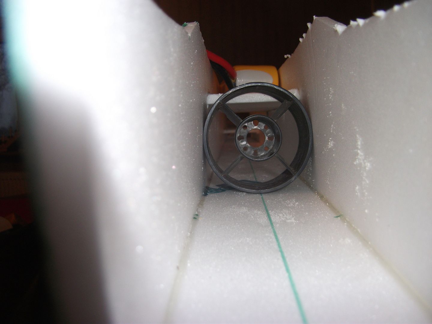

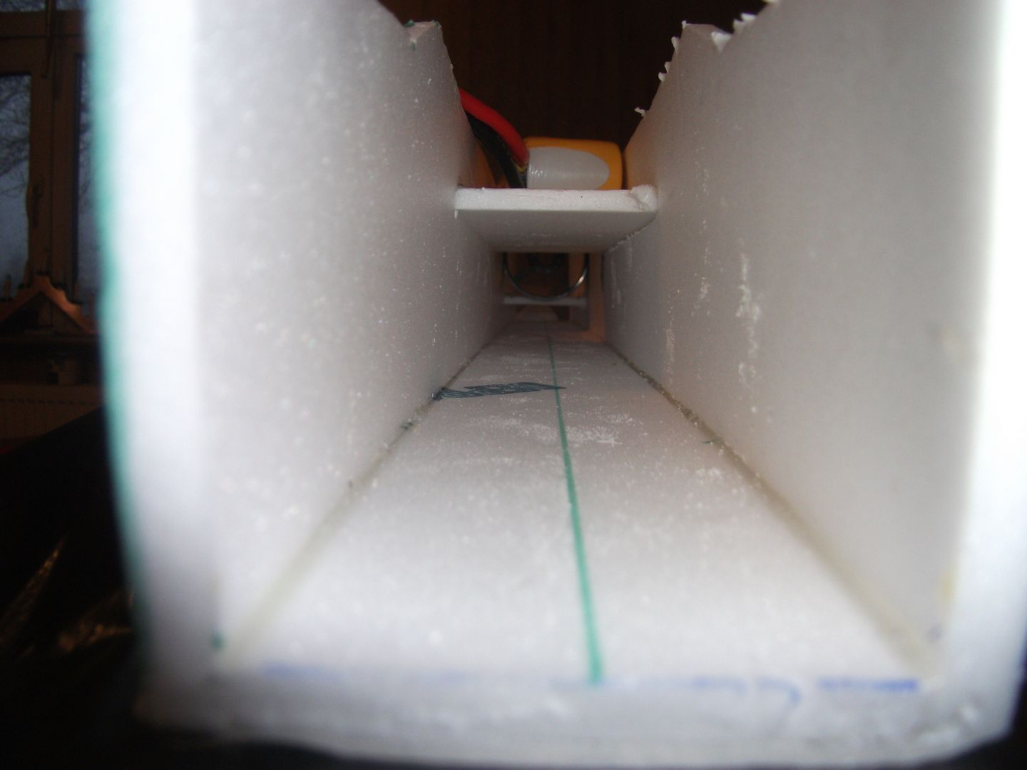

Ok ... I have scaled up a Jetex plan 140% to produce a P1 Lightning ... P1 is the Prototype No. 1 of the record breaking awesome EE Lightning ... After various changes to design / increased power ... fuel etc. - the final P6 variant gave new meaning to Climb Rates and Vertical performance ... even to repeated intercepts of the supposed untouchable U2.
Anyway ... I am part way through the build, chose the P1 because its basically a hollow straight tube with wings and tail !! .... and I have to decide whether to fit a 50mm EDF unit or go for a prop.

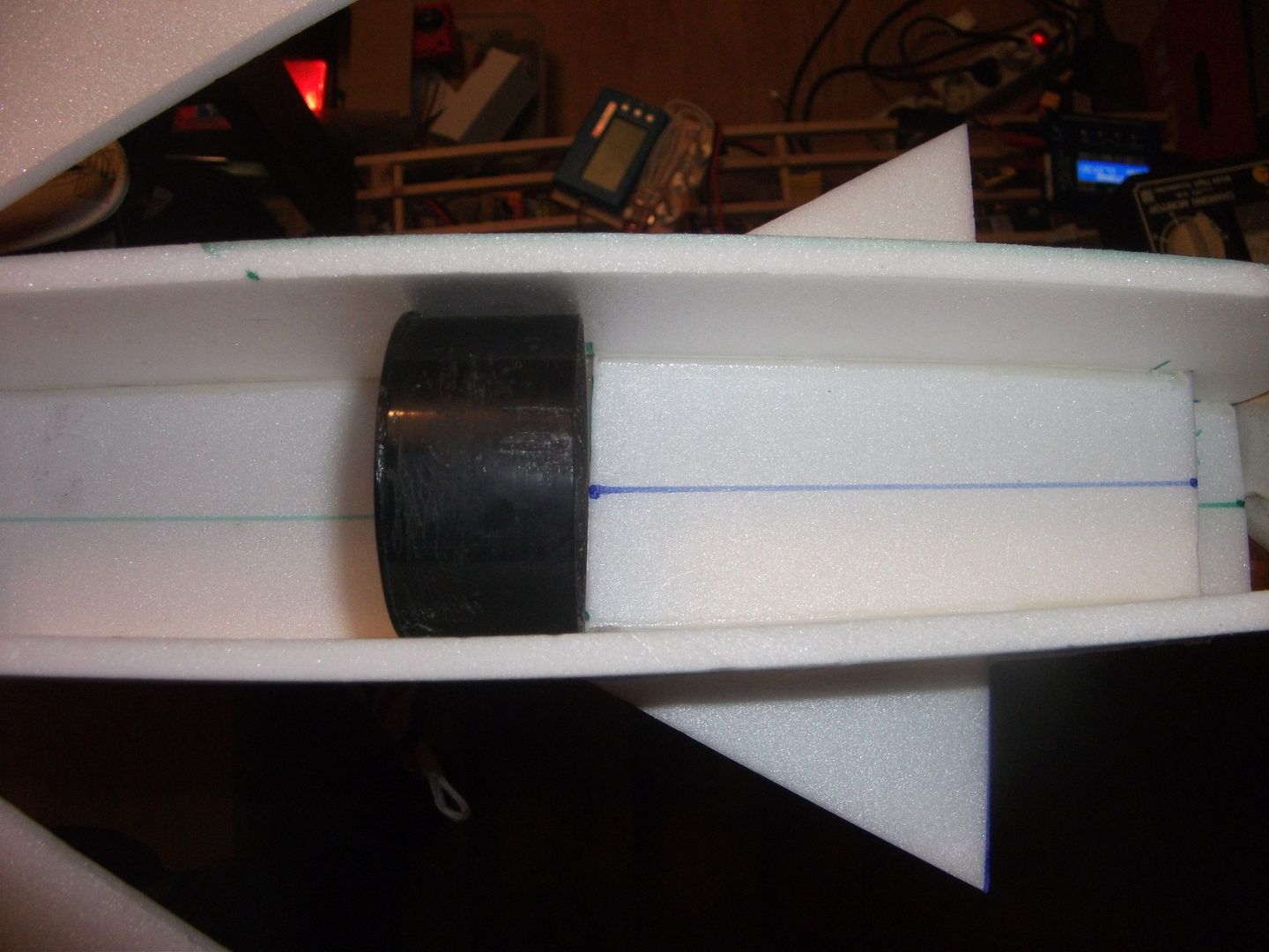

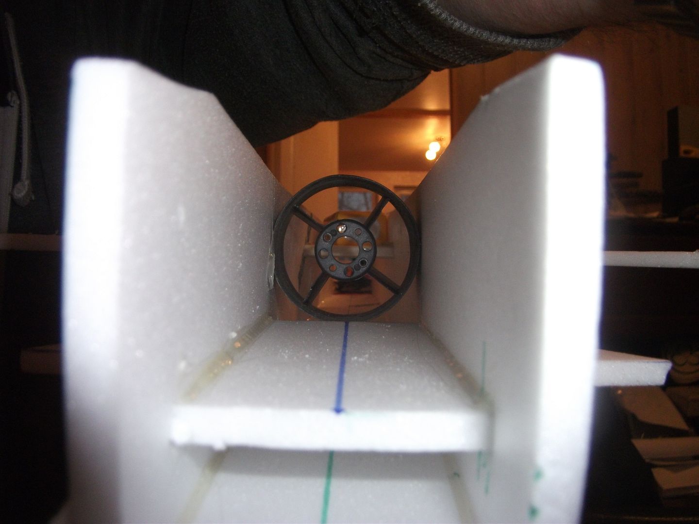

Here are the photos so you can see my dilemma ...(51mm EDF unit used to ensure 50mm unit will fit)
Overall :
51mm unit sitting in front section ahead of main wing .. shows I have enough airflow UNDER wing :
51mm unit sitting at front of tail section :
51mm unit seen from exhaust outlet :
Looking down length of that 28" fuselage :
Proposed position of battery and gear on top of wing inside fuselage :
OK some dimensions so people can help me :
Overall fuselage length : 700mm (27.6")
Span : 460mm (18.1")
Fuselage width internal : 51mm (2.0")
Fuselage depth internal : 78mm (3.07")
Wing root chord parallel to fuselage : 205mm (8.1")
Tail plane chord : 130mm (5.1")
Fixed tailplane with hinged elevens to give pitch and roll ... no decision yet on ailerons on wing due to the 60 deg sweepback !
She will have no bulkheads in the lower section to allow full air passage ... but will have bulkheads to divide up above main wing to give battery / Rx / ESC areas.
Area above and below tail will be without bulkheads to allow max air exhaust.
Now question is ............. would you fit the 50mm EDF or go for a prop and allow use of bulkheads / wider range of battery choice ? If Prop ... Tractor or Pusher ?
Help !!

I love the Lightning. A company not far from here has one parked outside their premises. They overhaul gas turbines and buying an old Lightening was the cheapest way to get a couple of Avon's for their technicians to use for training.
A prop will always give better performance and be easier for the reasons you mention. Main reason for an EDF is aesthetics but on a box construction foamy where scale fidelity takes back seat to practicality/ease of use then i'd have thought a prop would be more in keeping. A pusher would be my choice.
I think your aileron authority might be a bit marginal if using 'tailerons' only?

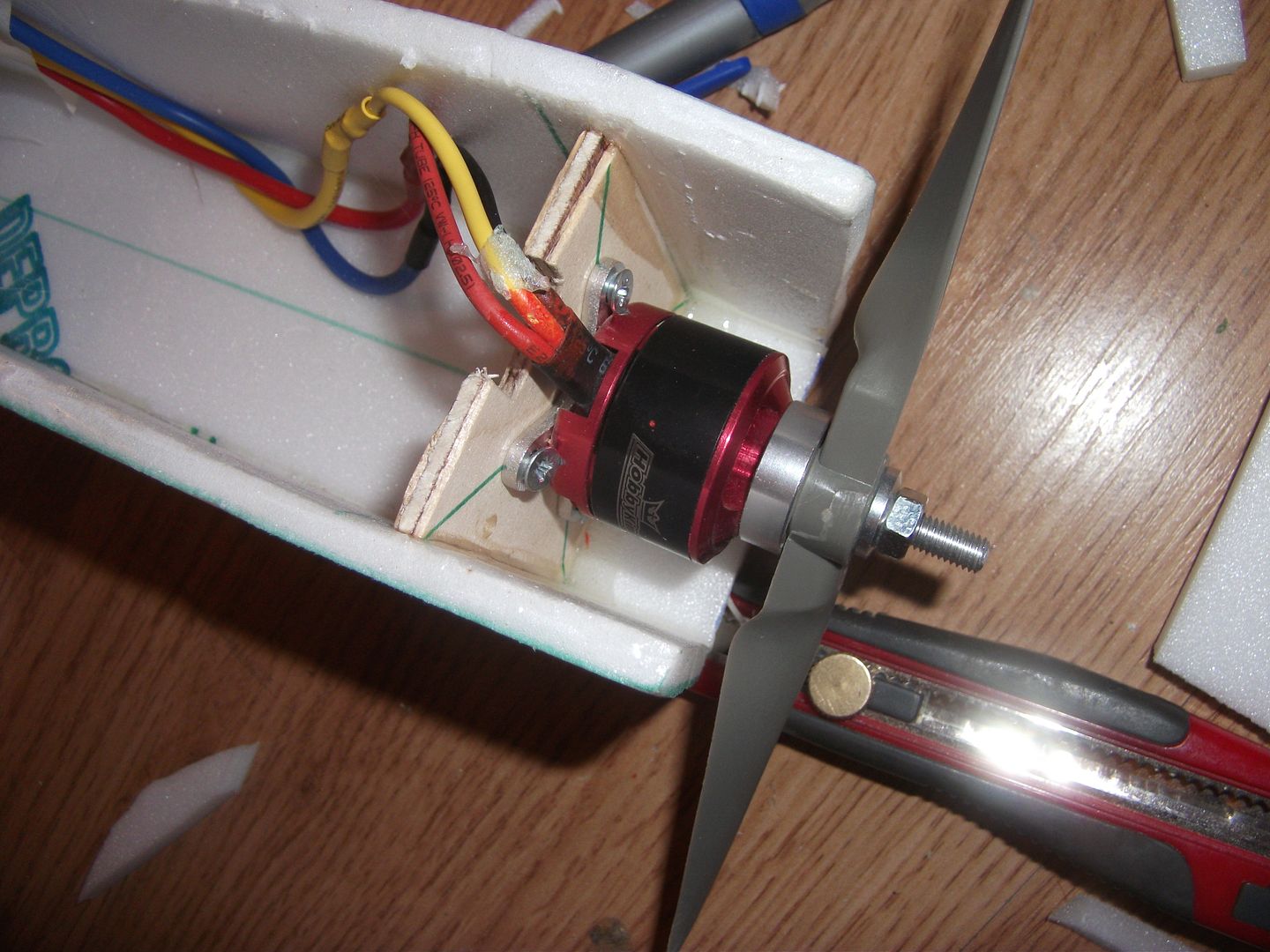

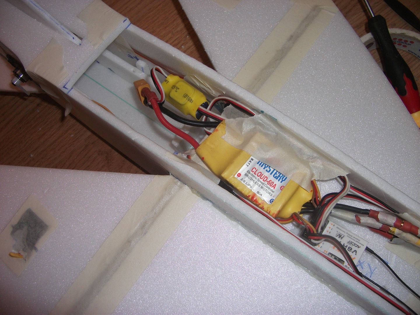

I know well what I'm getting into ... have EDF's ... Pushers ... tractors ... as well as all the others ... currently over 50 RTG models in the hangar.
Decision is for a Funfighter 1950 KV 4S capable motor up front ... 60A ESC + SBEC halfway down fuselage ... 1600 4S sits as far back as I can get it !! I may have to shorten the fuselage front section if I cannot get LiPo back enough.

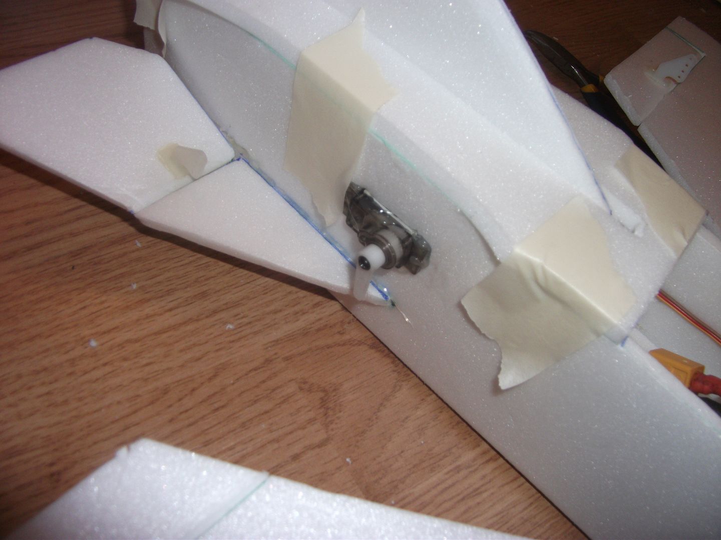

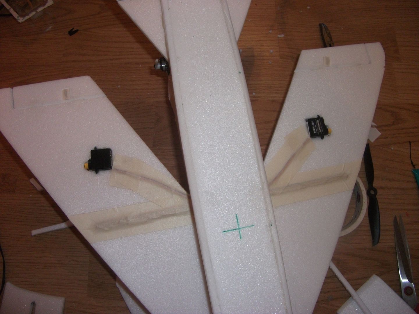

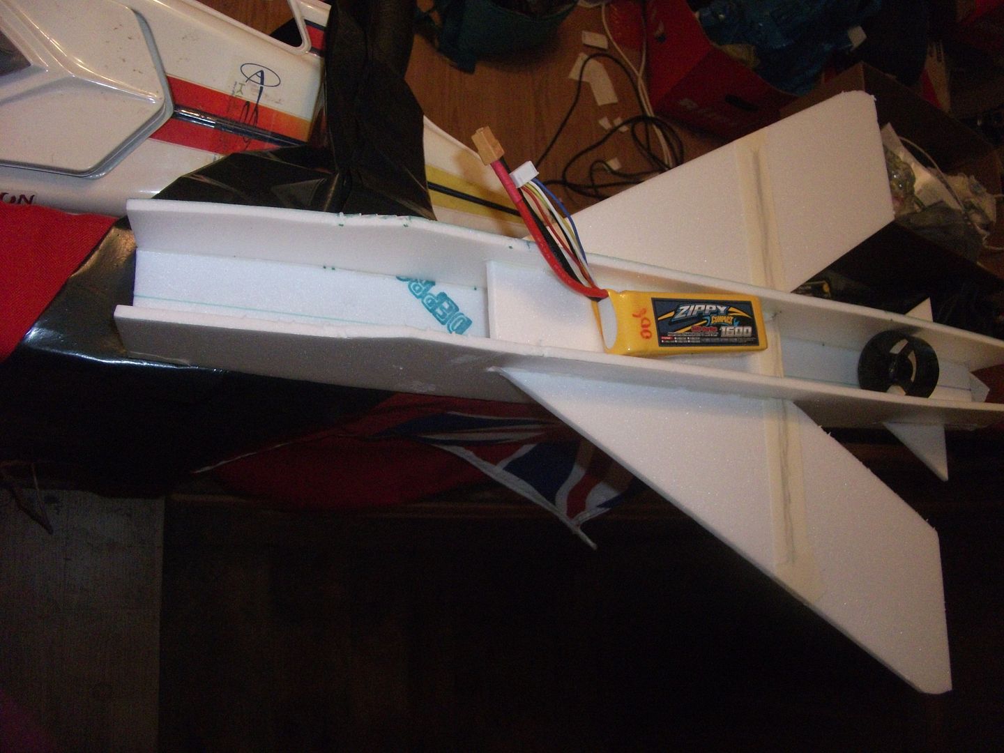

Anyway .. I took your point on ailerons and agree ... so here is a series of installation photos .... only thing is I elected for safety as it will be hand launched ... tractor prop.
I did experiment with mixing ... having the 4 servos via a Vtail mixer to give pitch and roll via all 4 in unison ... but I would have to open up servos to do a bit of reversing .. so elected in the end to use a 7 ch Rx and keep servos separated ...
The elevators I think will be enough ... the ailerons out on the wing 'ends' ... can't really call them tips !! .. will give a lot of authority.
I only had two 5gr servos left ... so they are the aileron servos ... with two 9gr servos for elevators.

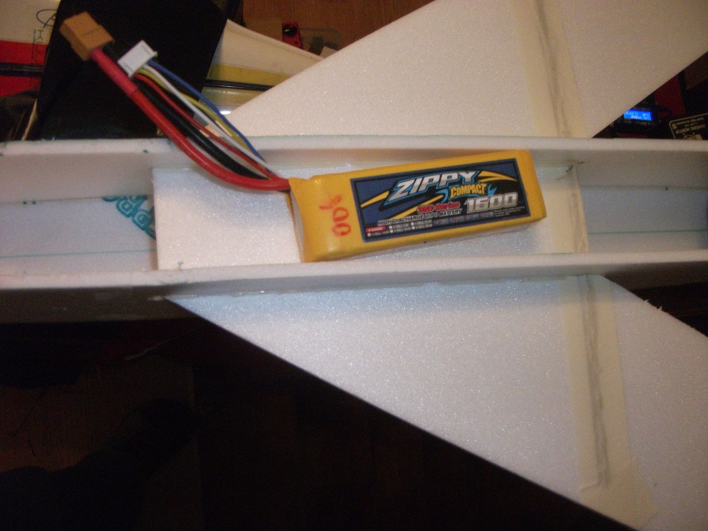

The LiPo ... 4S 1600 will sit in a box just in front of the tail plane. If you look back at photos - you see the XT60 is at rear of ESC ... drops in to the box.
She is turning out to be quite heavy ... given the wing area. So she will need to fly fast ...

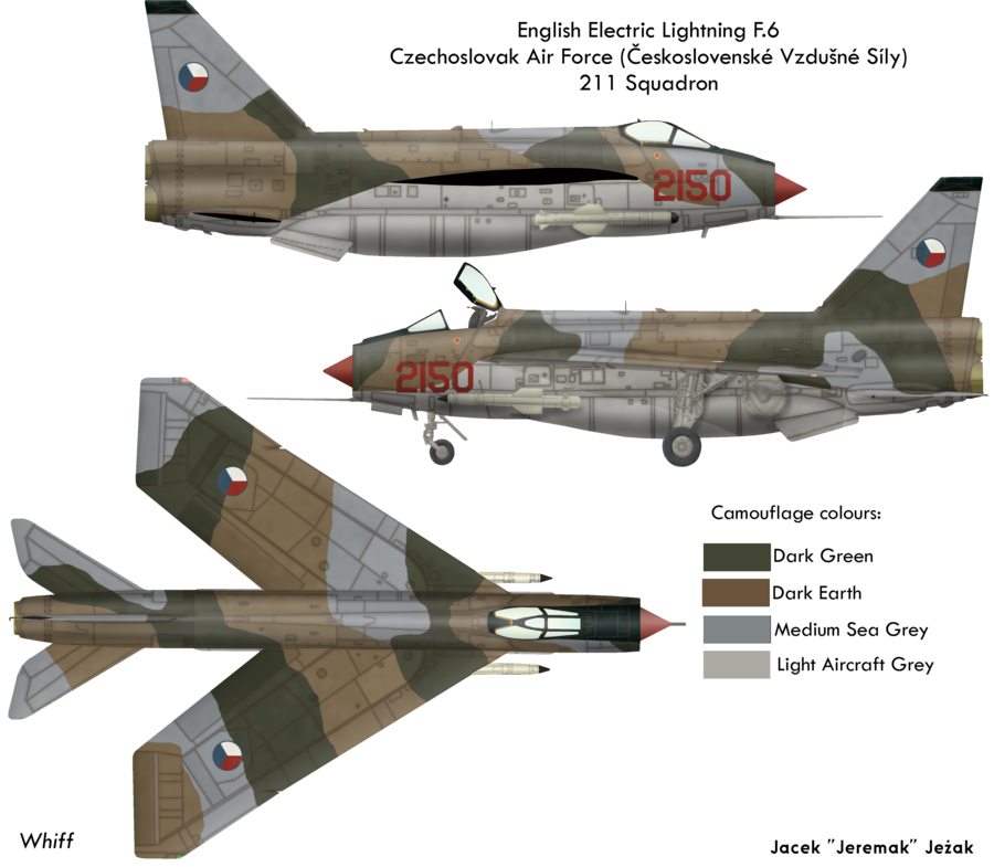

Ok ... onto colour scheme ... interestingly I found a reference to Czechoslovak Air Force flying the Lightning - that was a surprise ! Picture attached.

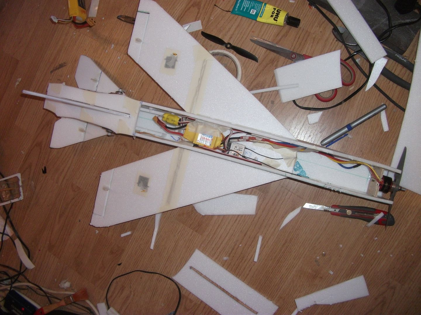

OK ... top is done ... hatch made ... battery box sorted ... balance is spot on as calculated without additional weight.
She's in 'paint shop' so no photos at present ...
Note before final piccies .... this follows my simple routine of box fuselage ... removing the need to plank and shape skins. My Concorde may be 'cartoon style' but in the air she gives that iconic shape illusion .. so has convinced me that the box style works.
The P1 was a basic tube and wings added ... unlike the later F3 ... 6 etc. which had shape and form. Later I wish to build a better scale EE Lightning ... so this is really a test bed to see it all works ...

Maybe, but the launch still looked poor to me. Looking at it frame by frame it was pointing up at about 60 degrees on release and seemed to immediately yaw sideways.
The tractor prop might be causing some longitudinal/directional stability issues too which might explain why it seemed to want to point in any direction other than the one it was supposed to be heading. Larger tail surfaces might be in order to compensate for the tractor prop?
Old 03-21-2016, 12:35 PM
The attempt to launch it appx 45 deg up is just wrong. That's a good way to make any plane crash. General hand launch should be aim it at the ground about 50 yards out. If it doesn't have more than 1:1 thrust to weight the high climb angle launch will fail every time. It will still fail many times even with above 1.5:1 thrust:weight.
From my EDF experiences... Its often a good idea to hand launch at a reduced power. (barely more than needed to maintain altitude) then ramp up power as you build airspeed.
High power = high torque being applied and you're at low airspeed (near 0) so the wings have no authority to counter it.
Good formula for having the pilot try to use aileron, inducing adverse yaw and snap-rolling into the dirt.
I'd try a take-off dolly. This eliminates the issues of hand launch and doesn't need the strong point to mount a hook for the bungee launch.
