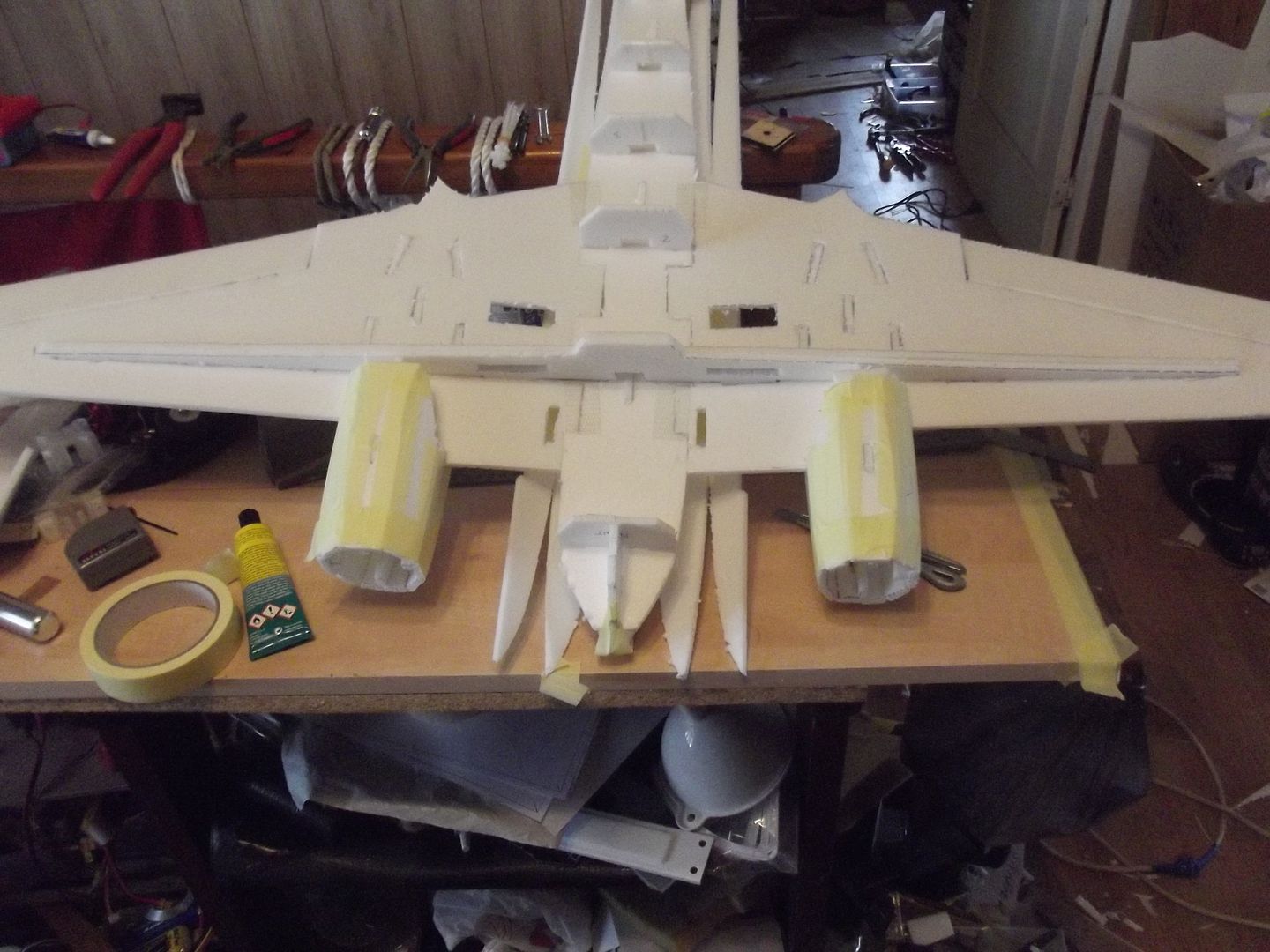

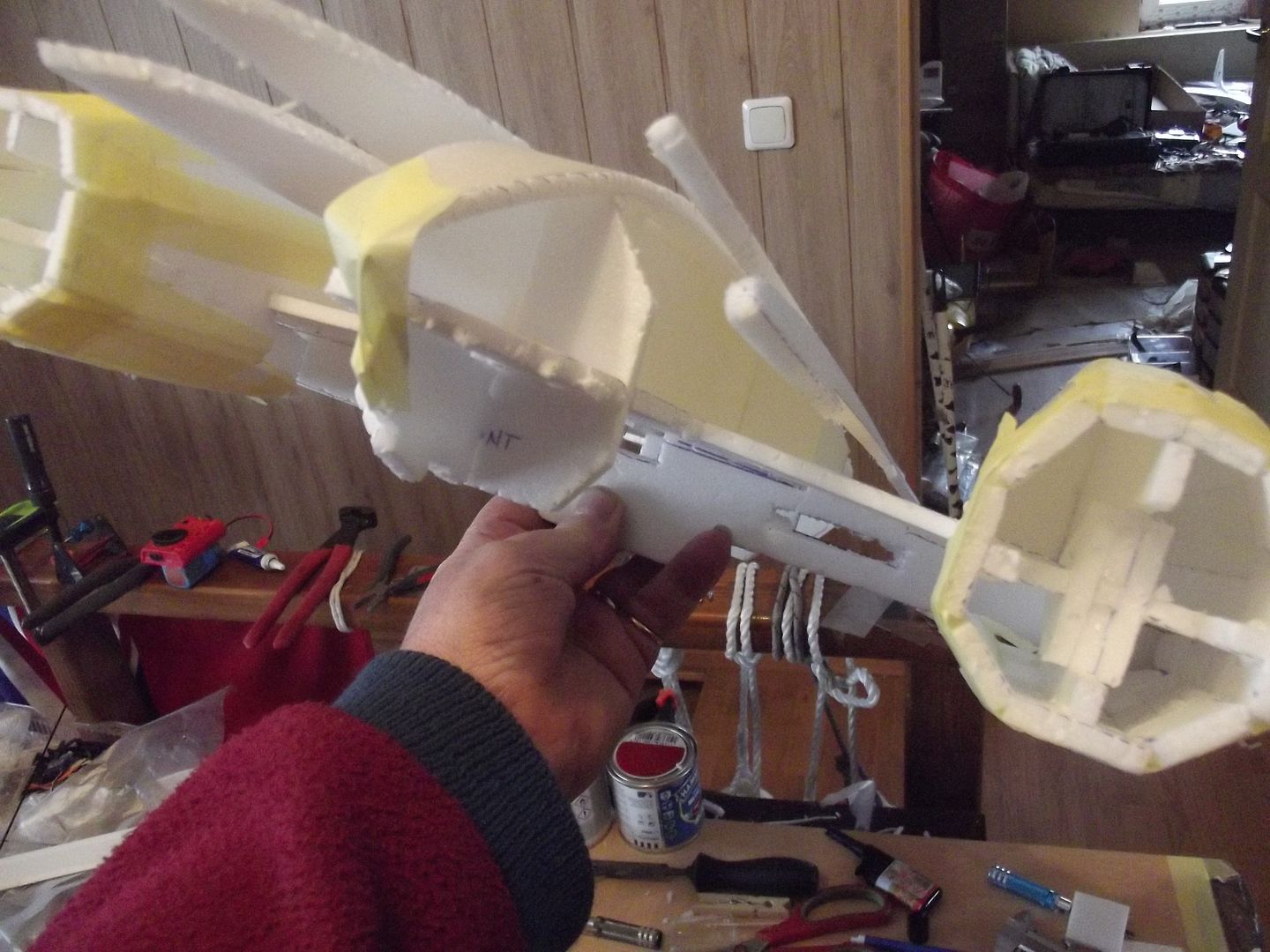

The build is coming on of the Mossie ... my workspace is like a bombsite !! so excuse the mess !! Stuck for space until I get workshop done.
Ok ... basic fuselage as a flat plate and then spine and formers added ... wing is half sections glued to the flat plate fuselage. Imagine a profile model - then formers added ...

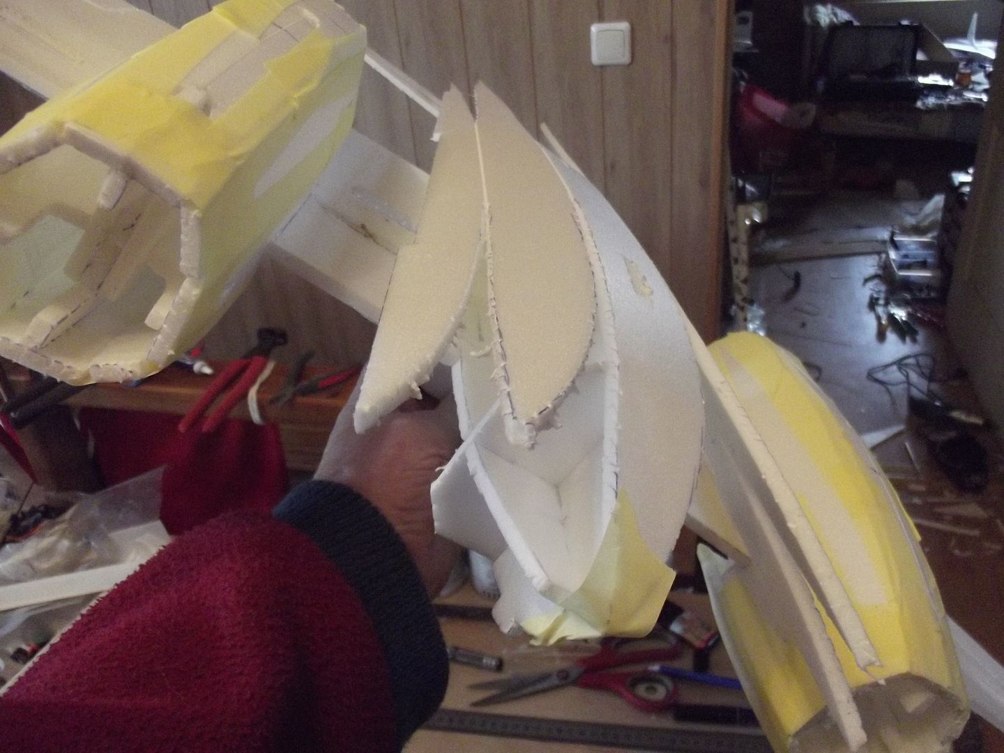

The engine pods 'nacelles' are created by using a spine and then 'folded' foam casing.
The same folded foam system will be used for the fuselage shell.
The folded system of course leaves the 'trenches' where foam is cut and folded ... so i will be looking at ways to fill without adding weight. I may cover the model with lightweight Nysilk with PVA ...

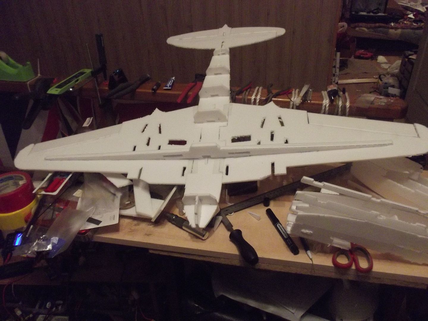

Wing ... best way to describe that ... again flat plate base .. with what is similar to a KM layer but folded and raised by a spar to create an aerofoil form.

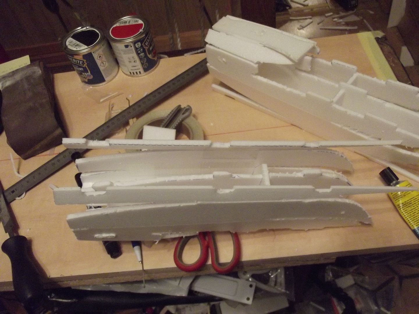

Well it all goes together !!
Wing spar etc.

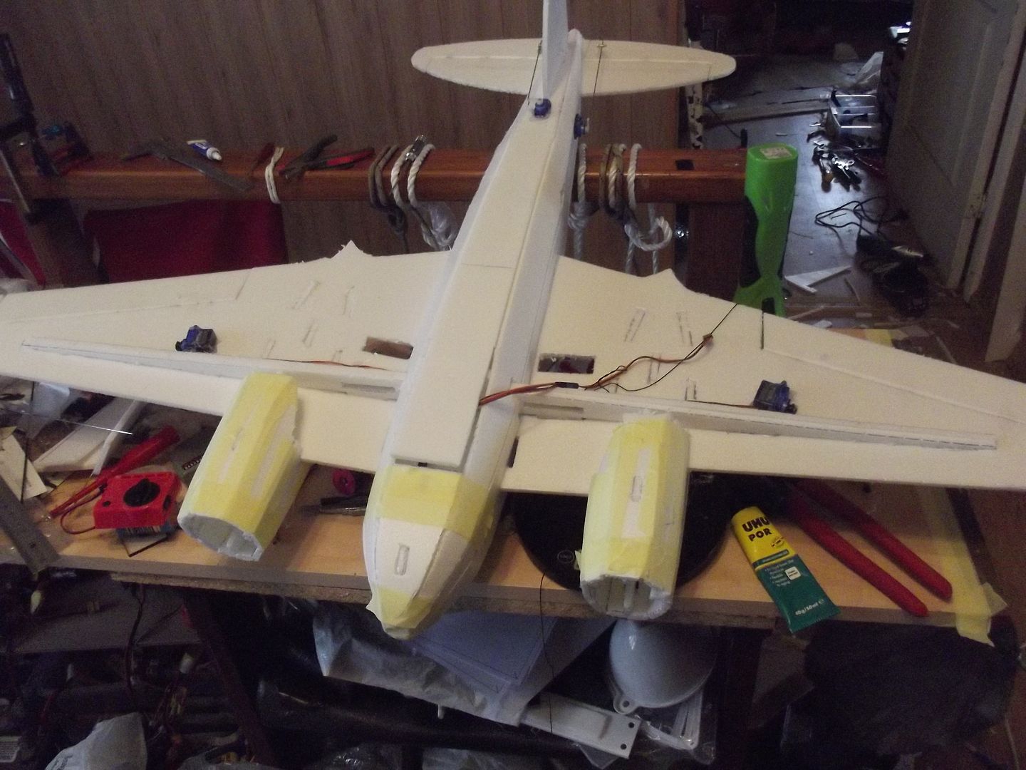

Fitting folded fuselage shell

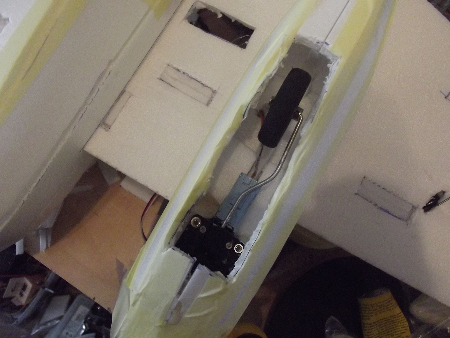

Starting to fit gear

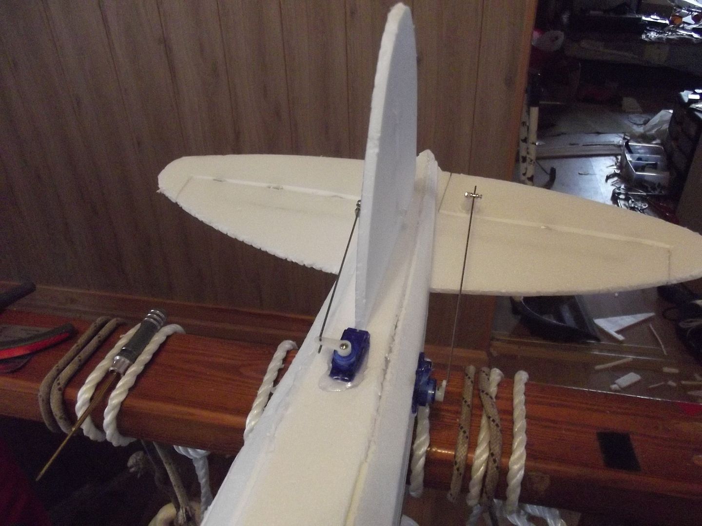

Because I am waiting ESC's and motors ... I cannot glue on top wing panels yet.
back end controls

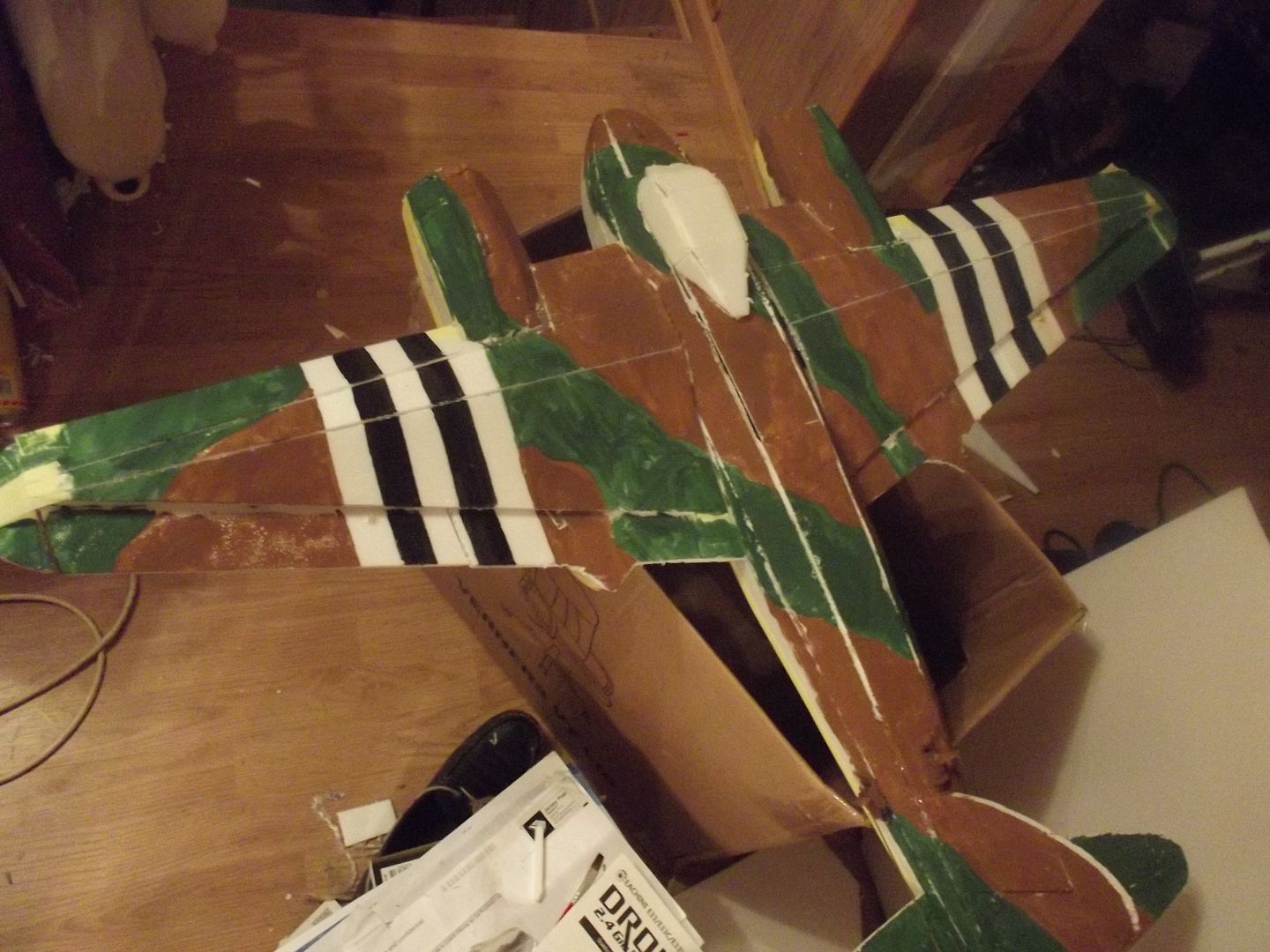

Yes - I have fitted retracts
Wing panels laid on to rough out the paint scheme ...
Plans indicate 8x4 3 bladers but eCalc shows that 6x4 3 bladers are more than enough to get this baby going on 1400kv .. and 3S
One panel in place now that ESC's arrived and I already had one motor (2210 Bell motor 1400kv)
Once other motor arrives and wing panel fitted ... the folds will be filled and final painting done. With an overall matt varnish to complete before decals applied.
Really looking fwd to this !!

Just waiting on that last motor - very frustrating ! ... then fit ... glue wing top on .. paint and then recheck location of gear to balance on the spar. I need to leave that top skin of so I can feed and fix motor wires / ESC in place.
Reason she leans is that the tail skid is not fixed and has collapsed !
She will have HE SuperII Stab, FrSky 8ch, Soloshot mount, arranged inside.
Retracts along with the usual ailerons, elevator and rudder.
Motors have 15% differential programmed in to give me better handling on ground.
Over-prop'd with 9x4.5 3 bladers contra props on the 2210 1400KV with 3S lipo ... but that's to keep the throttle lower and sound better. Originally I was going to use the 6x4 or 7x5 ... but that would mean higher throttle and high pitched sound. Not really in keeping with the Mossie !!

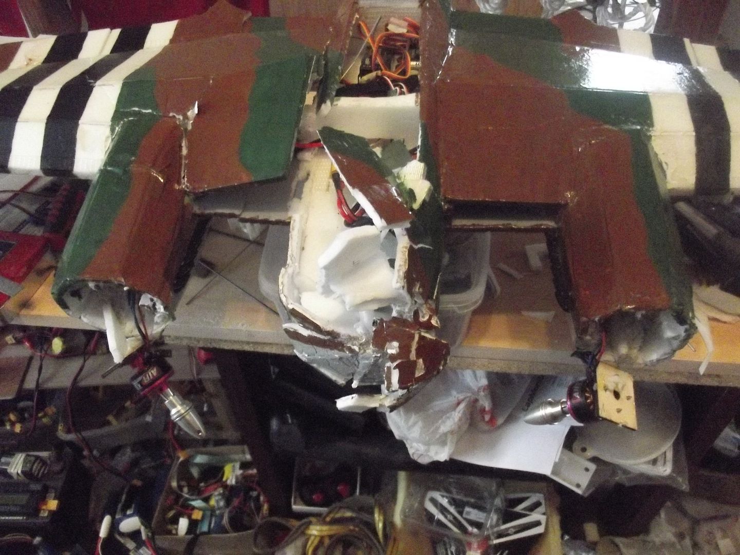

Damage is repairable and she will be back again.. smashed nose, split stbd nacelle and both motor mounts loose. Wing sheet split top and bottom but clean splits. Fuselage side pieces on stbd side - but its just plain jigsaw puzzle to fix.
But she was gorgeous in the air ... well worth effort to repair.

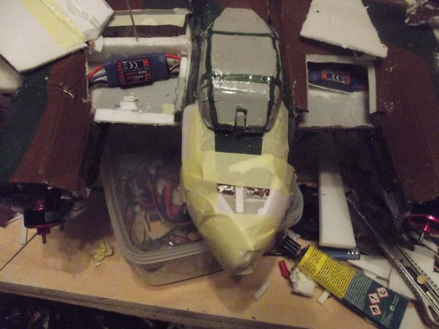

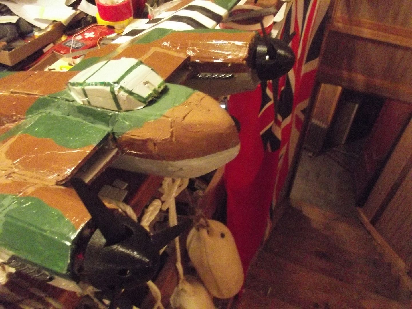

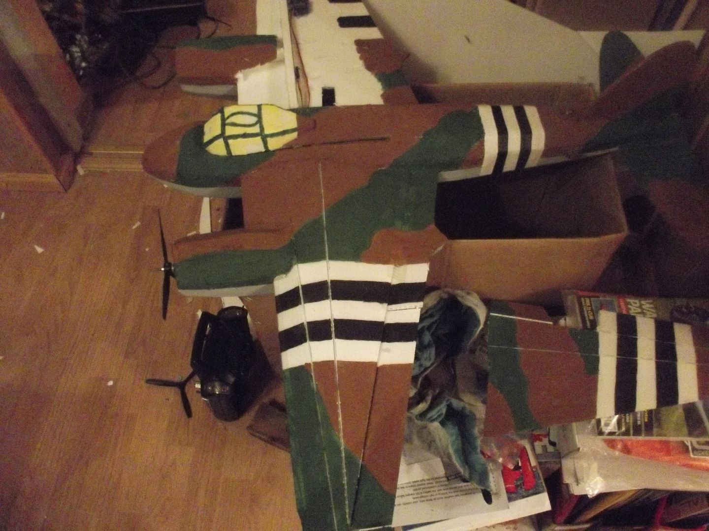

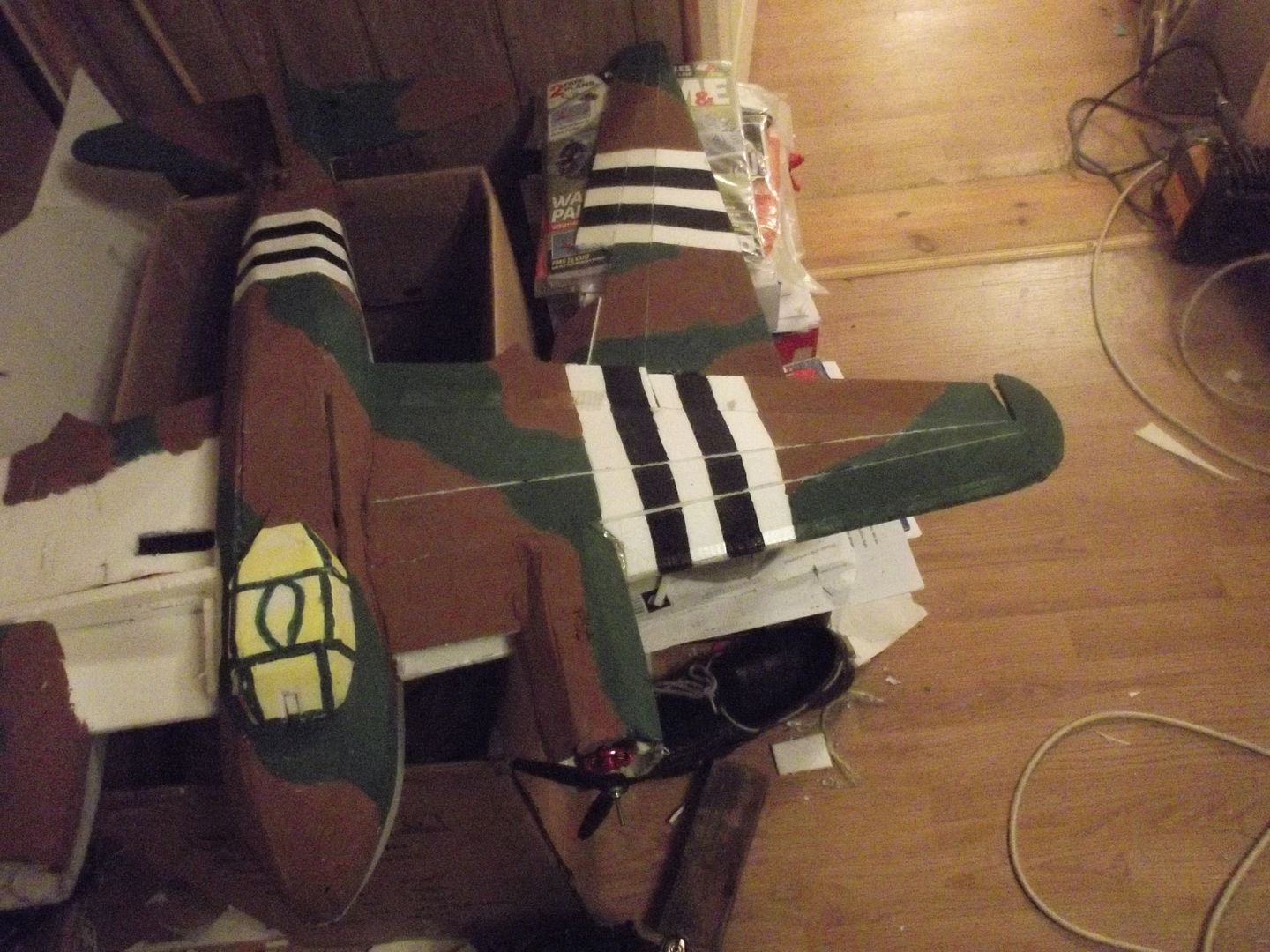

OK .... repairs completed ... just need to varnish the water based paints ...
Here's the run of repairs ...

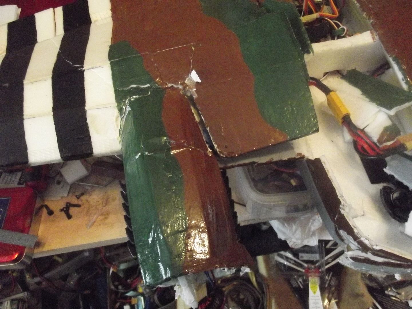

Crash damage :

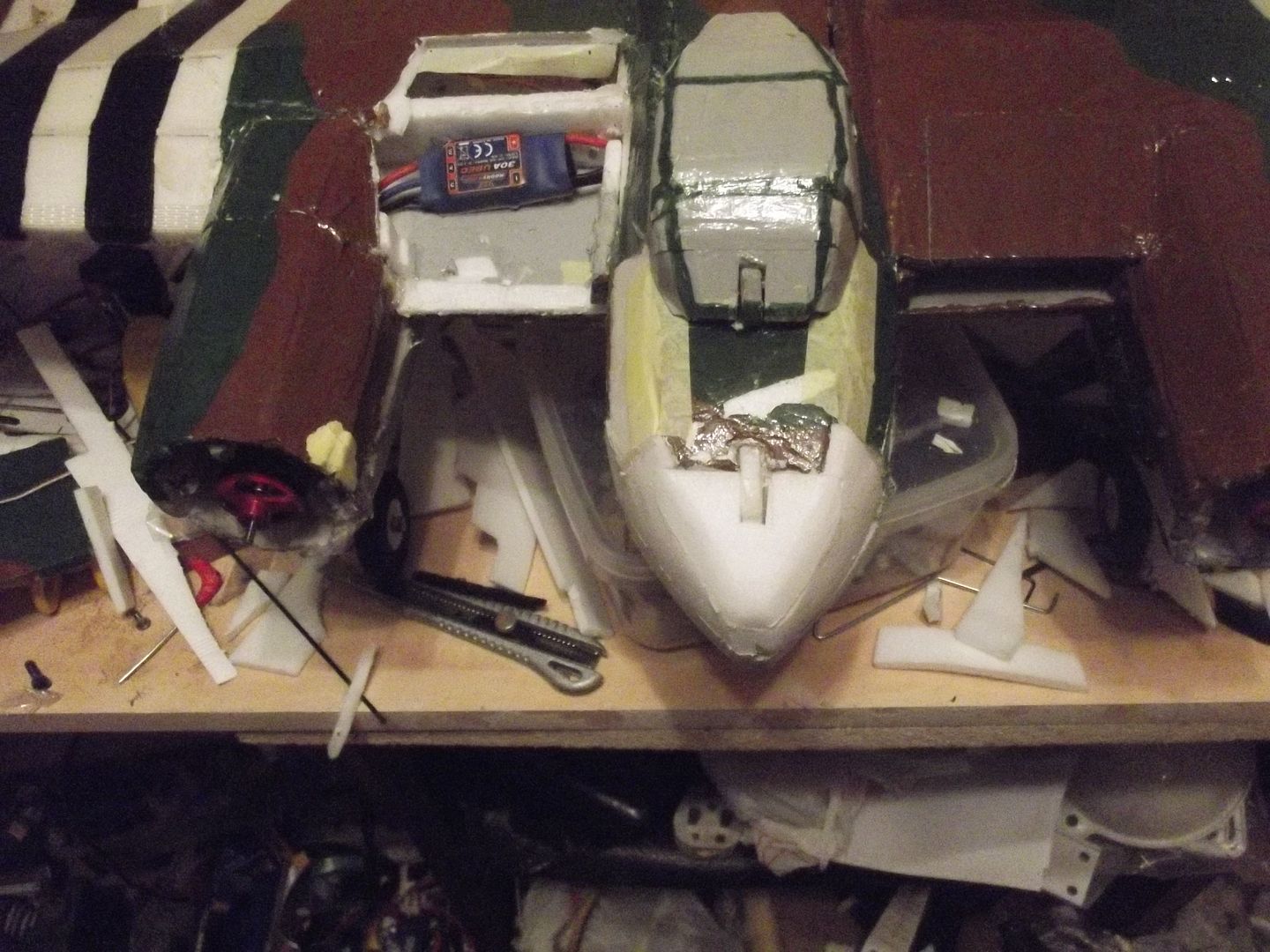

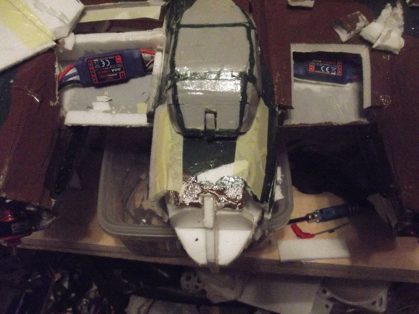

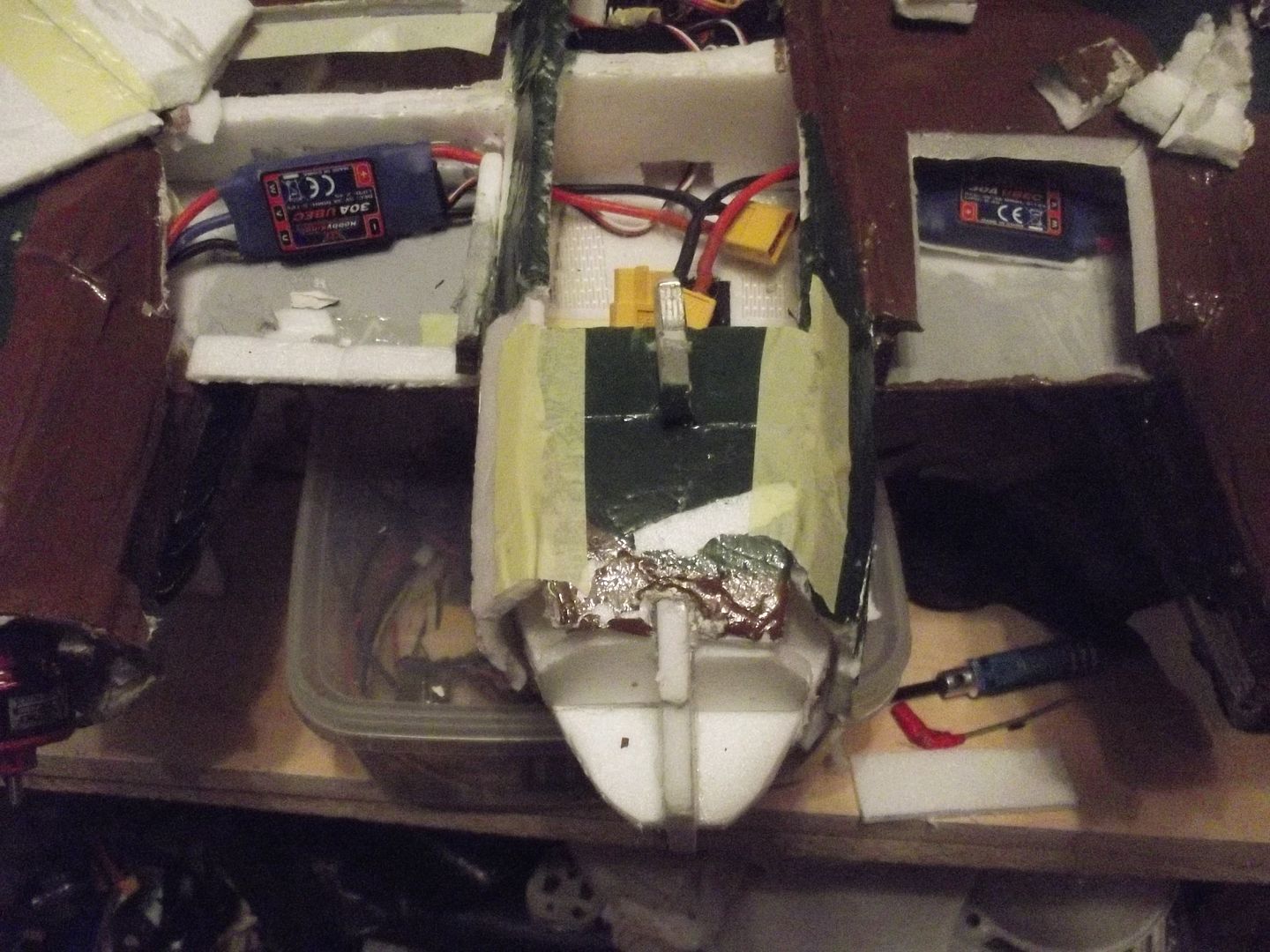

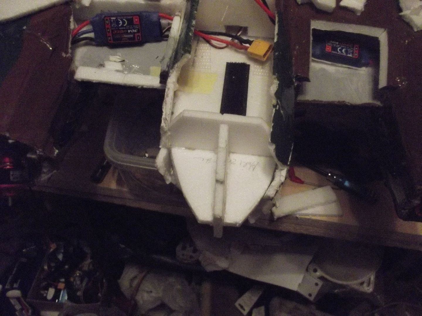

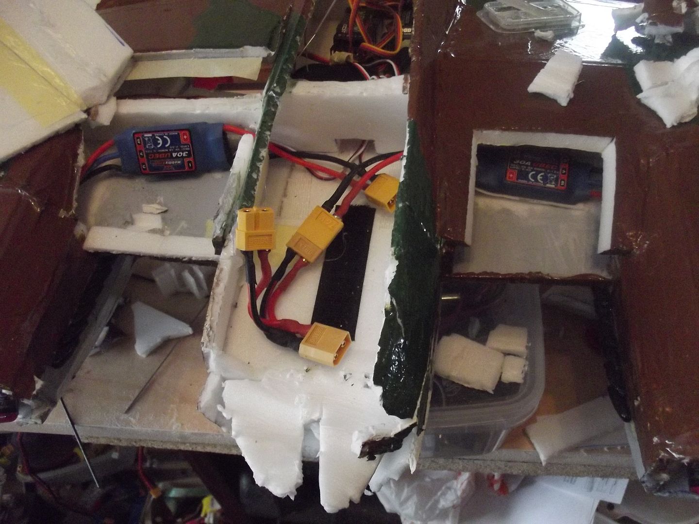

Cut out concertina'd foam and also get to ESC's etc as I have a cogging motor and possible ESC failure ..

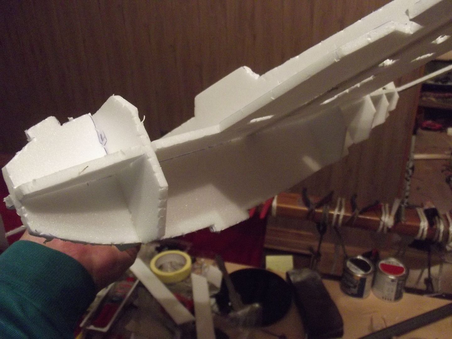

Scafr in new formers and spline for the nose ..
Piecing back like a jigsaw puzzle ..
Make sure hatch still mates ..
planking up nose ..
May not be Concours ... but will do for test second maiden ... then will set to fill those 'holes' ... she still has to have her varnish top coat - that then darkens the poster paints and will blend all in ..

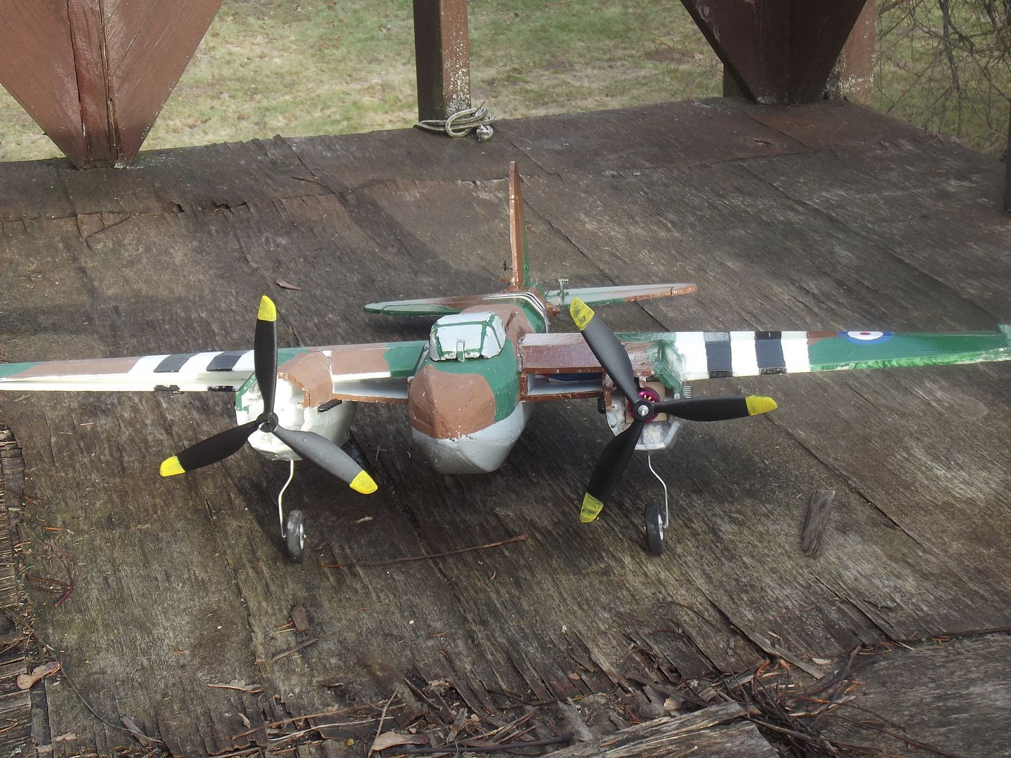

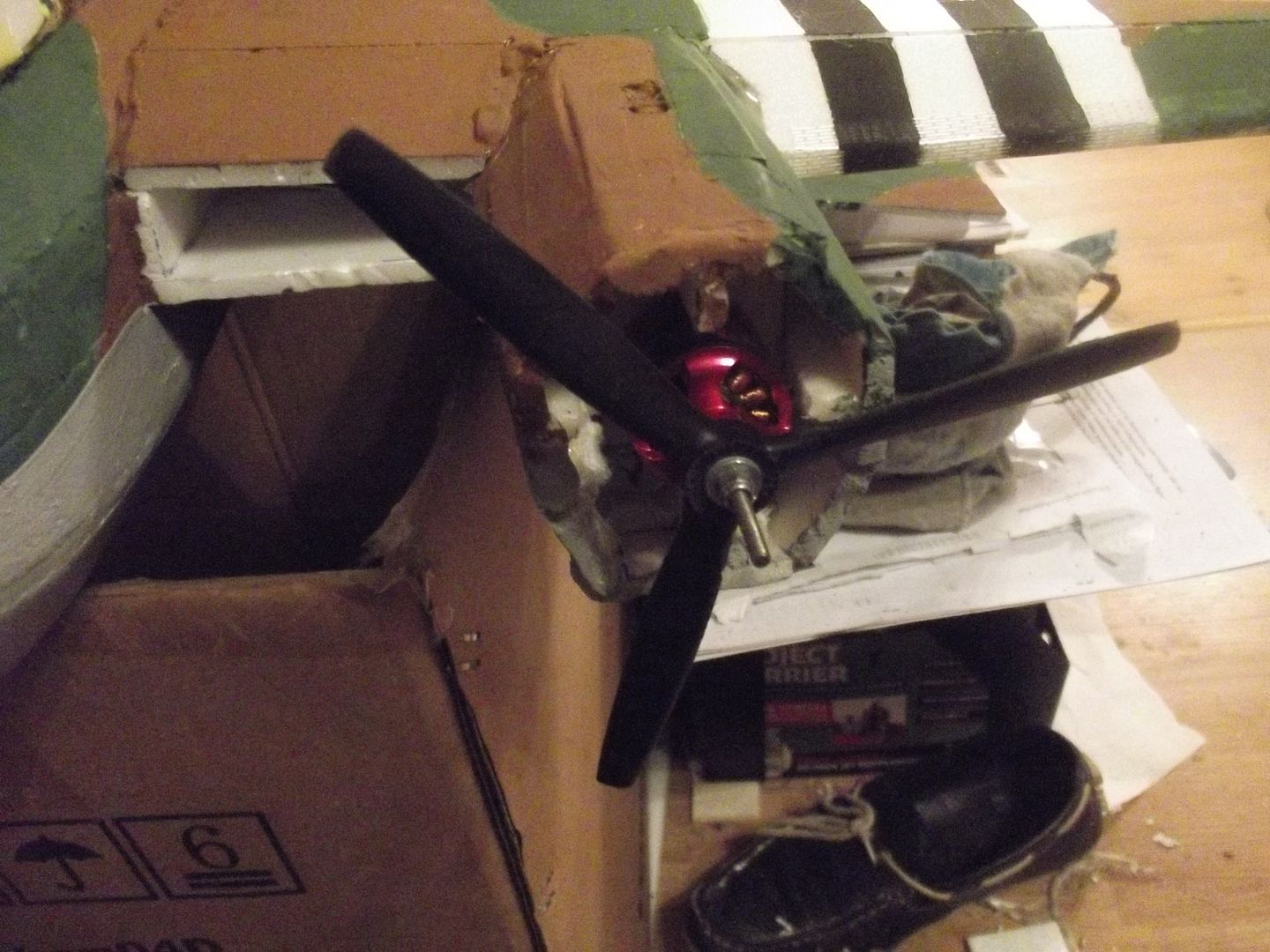

Motors are out ... swapped to Floaterjet motors and 7x3.5x3 Gemfan flexi props ...
Spinners are 3D printed specially for this model.
ALL works ... even that retract !!
