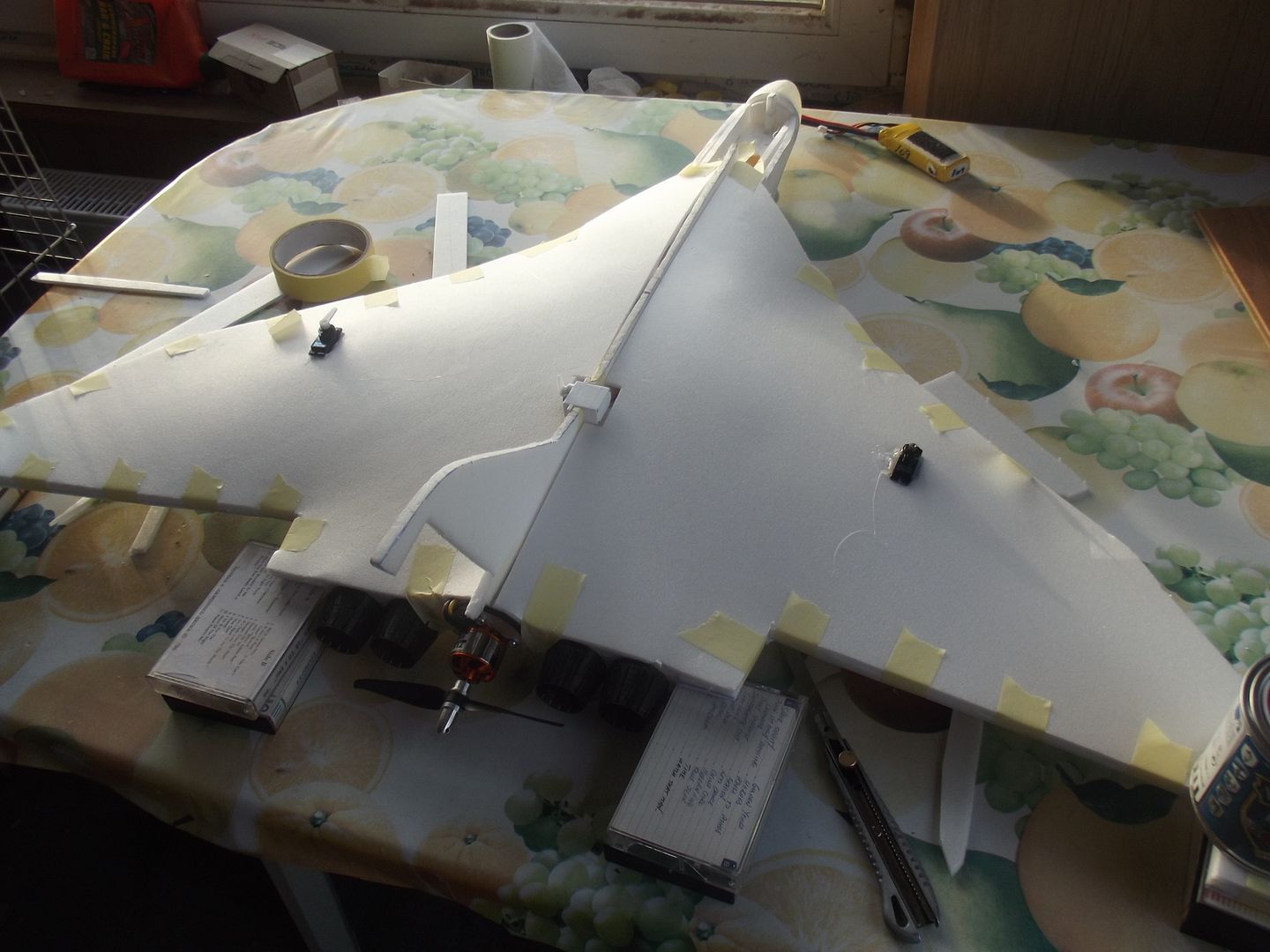

Just laying out wiring ... then its sheet top of wing... making sure all propped up level to avoid any twists.
I know I'm not the most tidy when it comes to laying out the wires !!
Top sheet on and letting the UHU POR really take ...
Because of the compound curves involved ... there is FG tape round the wing outer circumference

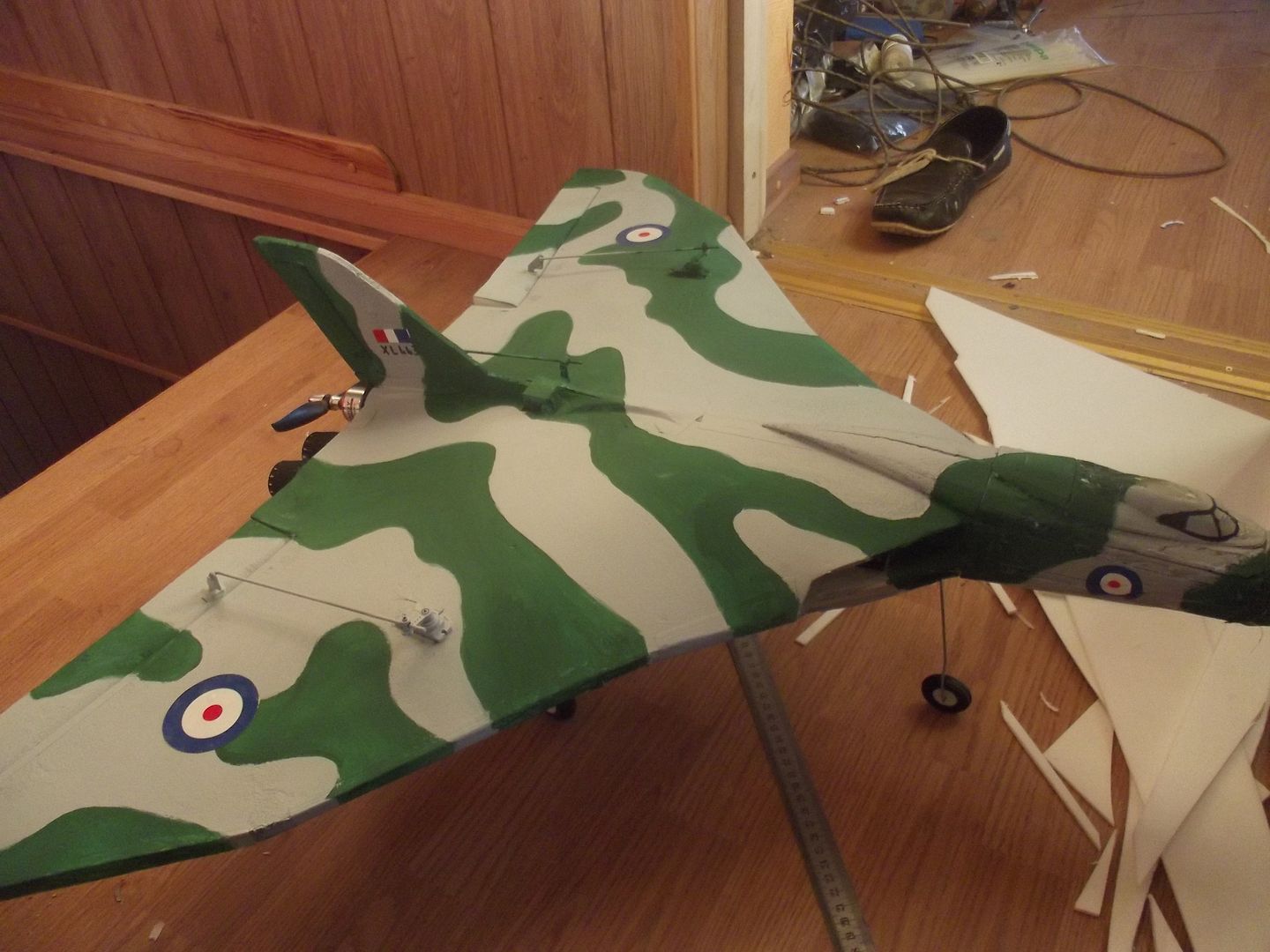

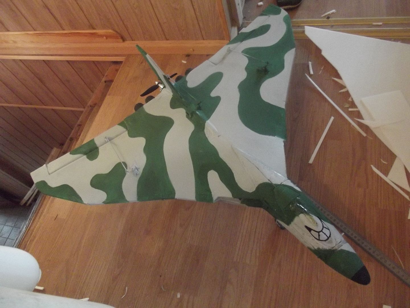

Painted ...
Before decals
With
She does have one area that worries me ...

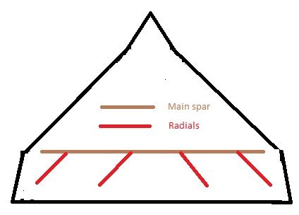

Looking from nose back over wing ... the left wing (starboard) top surface has dipped behind that main spar ... enough that when viewed along wing to set ailerons - you see it. I don't think it will stop her flying - but may introduce some aileron trim ...
I'm think adding the stabiliser was a wise decision as that will help me overcome this.
If I was to build her again ... I would add some radial supports back from that main spar to support that top sheet.

I wouldn't worry too much. Deltas generate far more lift from the underside area and the vortex effect than the actual section particularly at smaller sizes. I doubt it will even be noticeable with the generous aileron area.
A nice thick wing yet the elevon servos stick out through the upper surface. Just saying! .

I know ... servos struck me as an eyesore as well !!
This happened because I was trying to find a way to mount the servos before sheeting over the wing. I set them into the wing sheeting before laying onto the spars. Without the arms and rods - it looked fine. Add the arms and rods .... UGH !!
I'm sure that after a period - I shall be building another .... things like this will be addressed.
