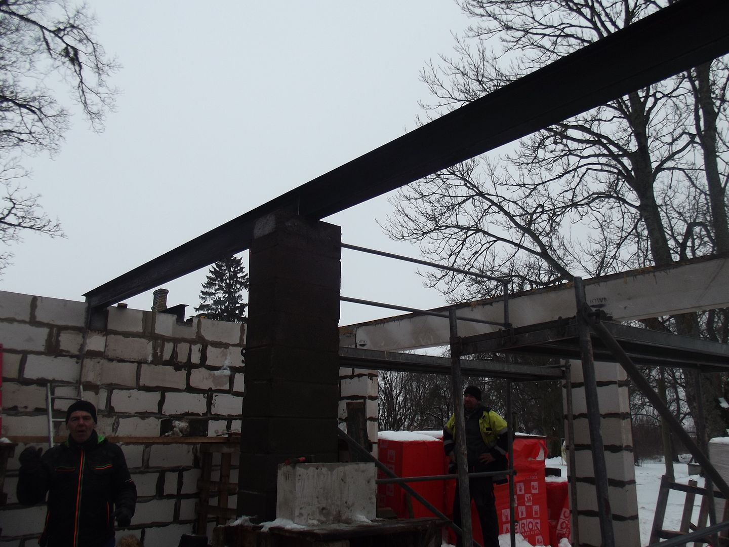

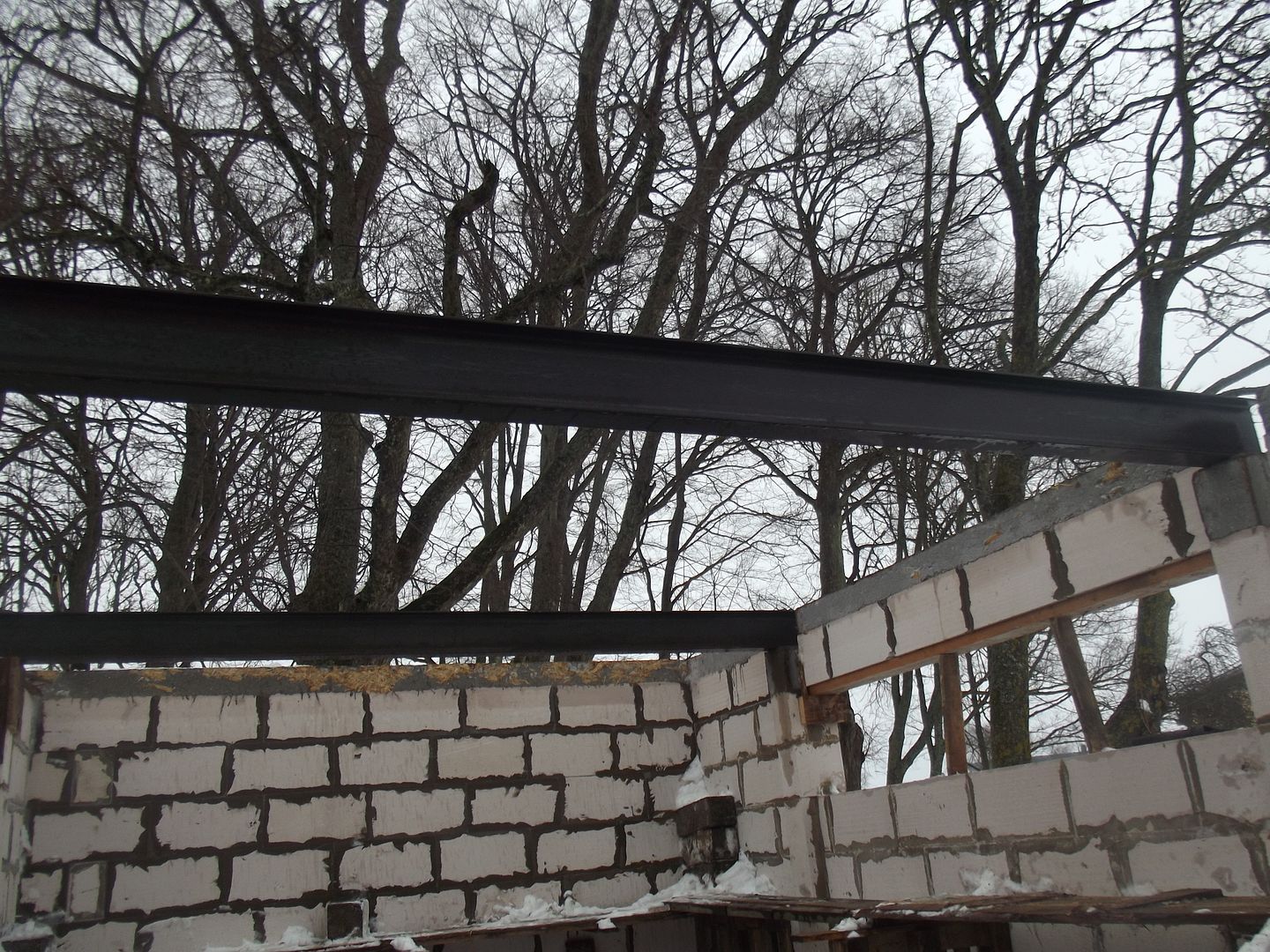

So yesterday we were 'drowned in snow' .....
Metal floor support beams in ...

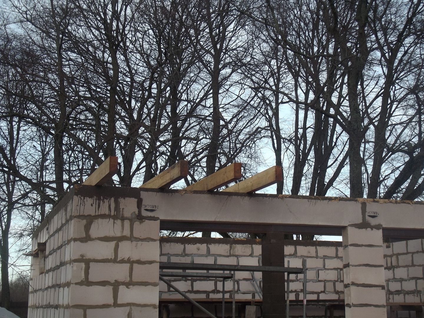

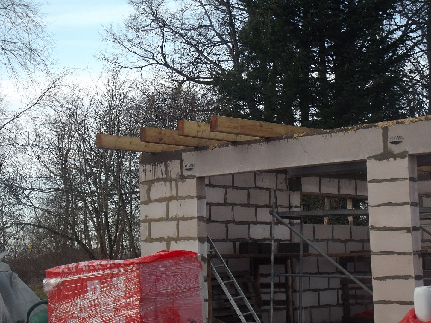

Today putting wood floor beams in ...
Where beams are longer than necessary - I've asked for the overlength to be left (4ft) and we will use that as a 'balcony' at front !! We'll revise the plans to give me a door to get out to it from the 'lounge' ...

Good idea Nigel and it will also keep rain off the garage doors and stop it coming in if they are open.

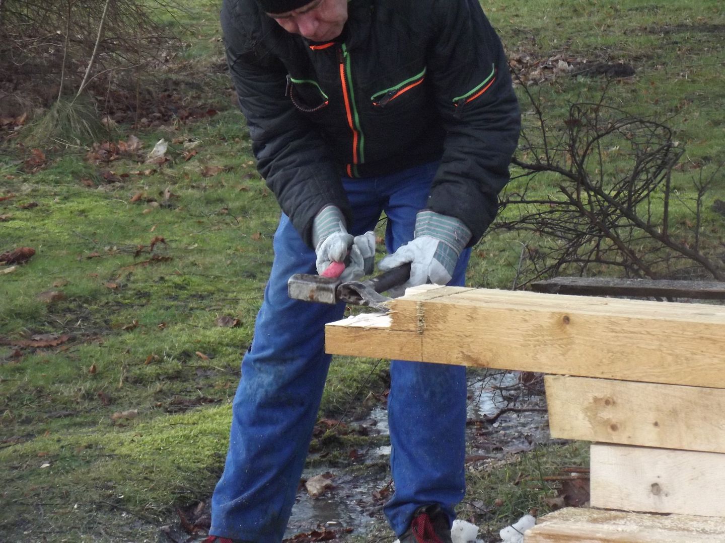

The beams are two per line ... with bolted joint in middle over the metal I beam. Because the timber mill has set length cutting beds for the logs, I had to go next length up.
Each beam is 4.8m long and 100 x 200mm section. The overhang each wall is 1.10m ... the rear will be cut off and used to create the verticals for a low balcony rail at front - where the beam overhang will remain.
Already pals are talking about 'cocktails' out on the balcony !!
I did consider moving the beam joints along and pushing further out at front - but then I would have to start looking at columns to support the balcony. With only 1.10m - its self supporting.

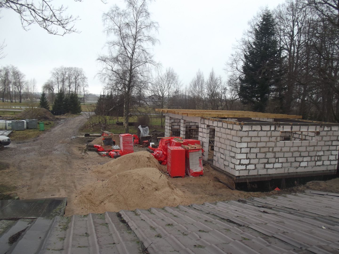

This is the view from my upstairs Office at home and you see the beams being joined before moved to final position for the garage part - end store section as you see has two metal I beams due to stairs etc.
