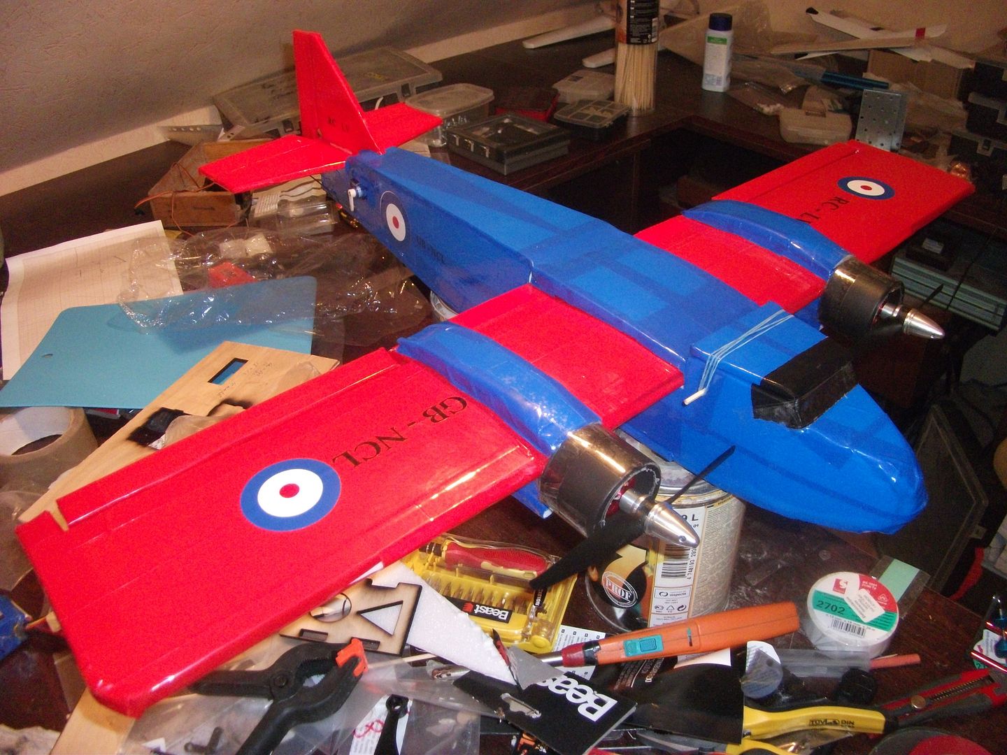

Posts: 12,786
Donkey Twin is on board being built now. Wings made ... just sorting nacelles and starting on Fuselage.
Simple cosmetics - packing tape ! I have RED, BLUE, BLACK, GREEN, ORANGE and YELLOW.
Wing has been changed to two sheets of 6mm separated by 3mm pine dowel glued inside. Sheets then pulled together at edges and taped up. Will mean fashioning a bridge piece over top of wing to fair to fuselage. But the wing is much easier to build.
Old 04-19-2015, 02:14 PM
Posts: 12,786
Decided to change motors to Emax 2S jobbies ....

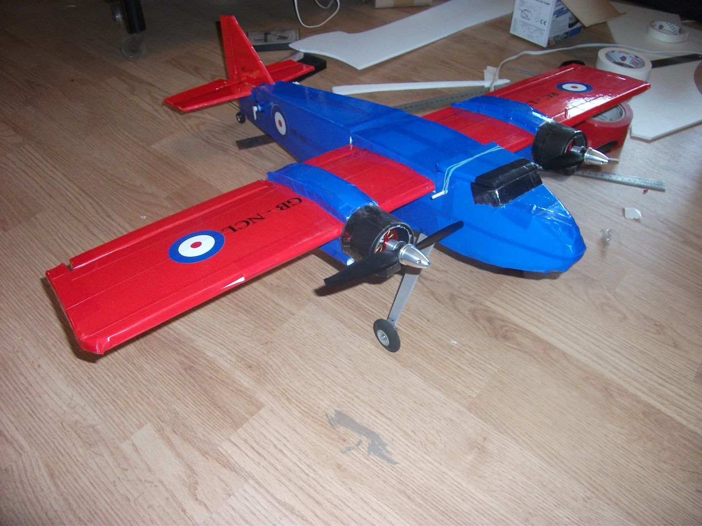

Here's the model coming on ...
Side on - it has a sort of Bomber look ... actually quite pleased with the lines ... simple but seems to go together well.

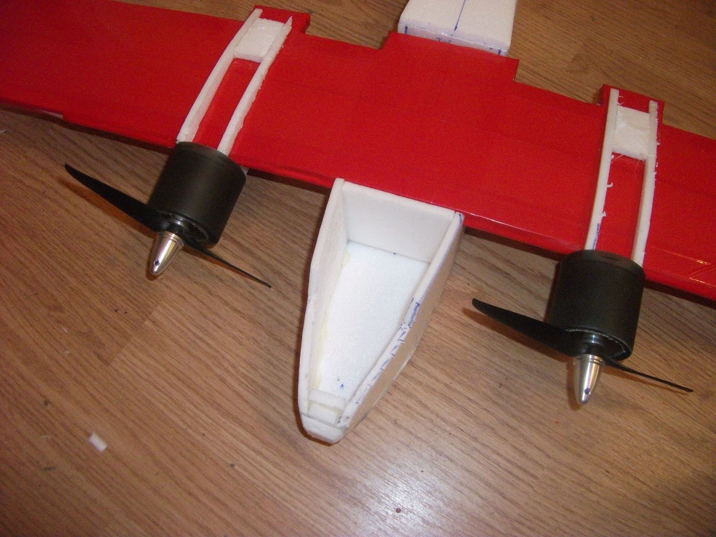

Couple of wifes Hairspray caps as engine cowls ...
5x5 props .....
Ailerons with 6gr servos, Flaps single 9gr, elevator 9gr, rudder 9gr ... she's going to get tail-dragger form U/C ... I was going for trike - but can't find my spare Stinger nose steering job.

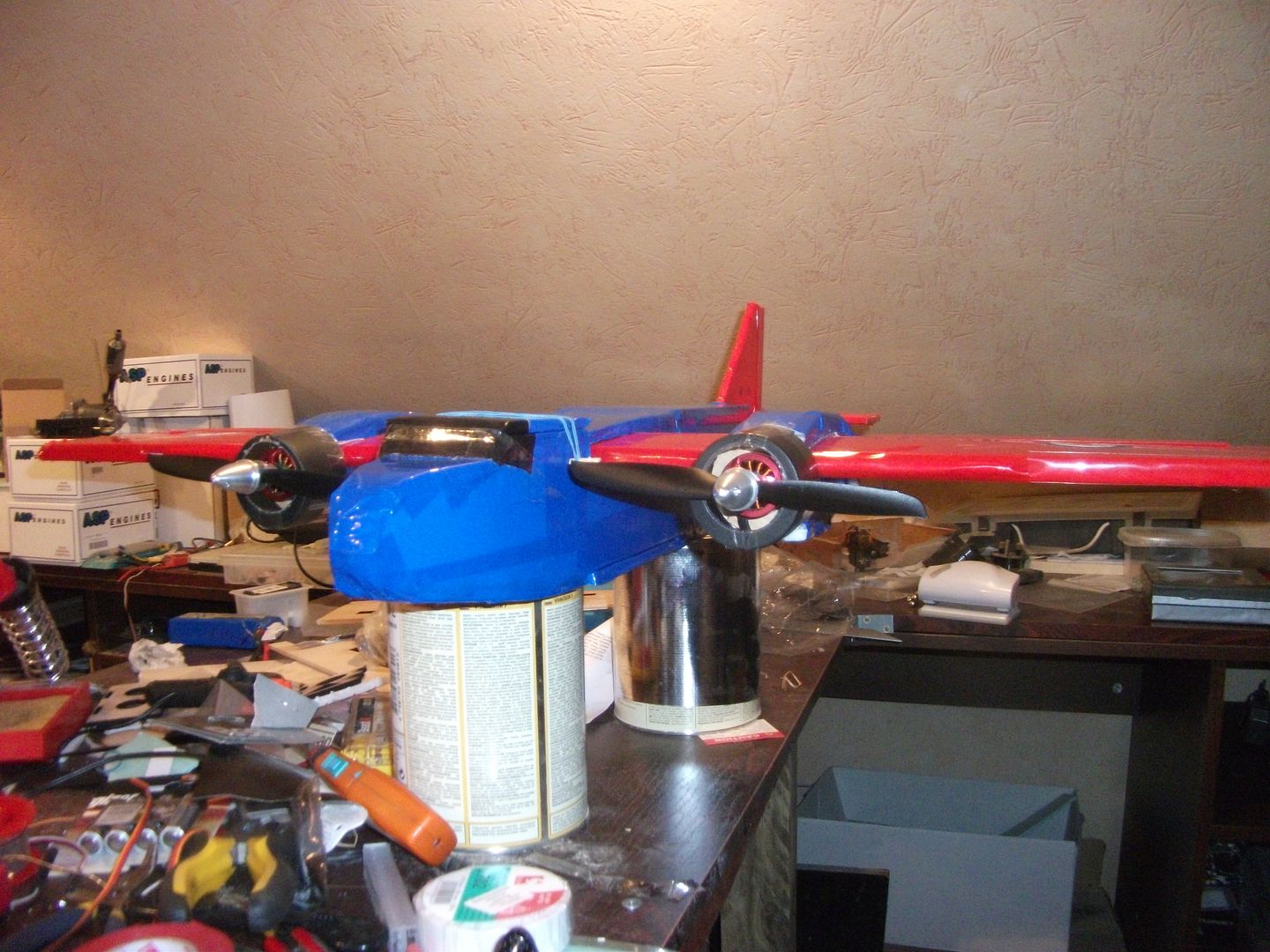

Posts: 12,786
Forgot to show !!
Changed to 6x4 props ... 5x5 was a bit small against the cowl frontal area ...
COG is spot on NOW !! without any gear. That's good ... I will put the LiPo's and ESC's at CoG under wing ... The Tail servos at tail ... instead of running control rods .. Rx will go in the nose ...
Once the alloy wheel job is fitted - that will offset the rear servos.
I'm hoping for more than 1:1 power to weight ...

Posts: 12,786

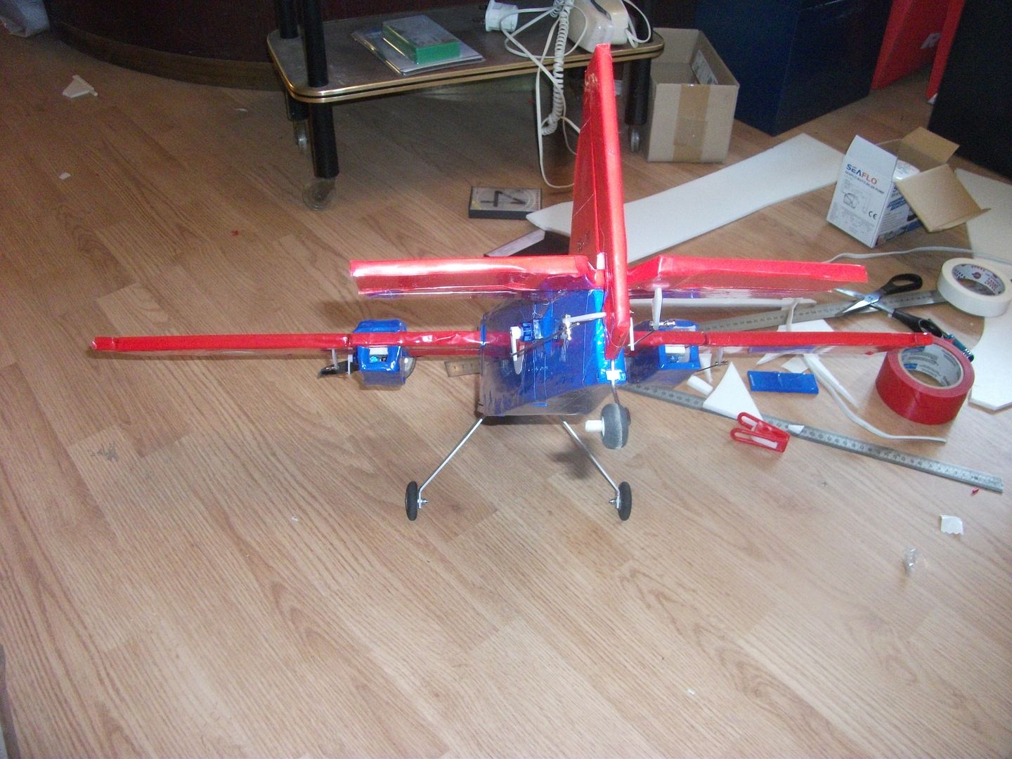

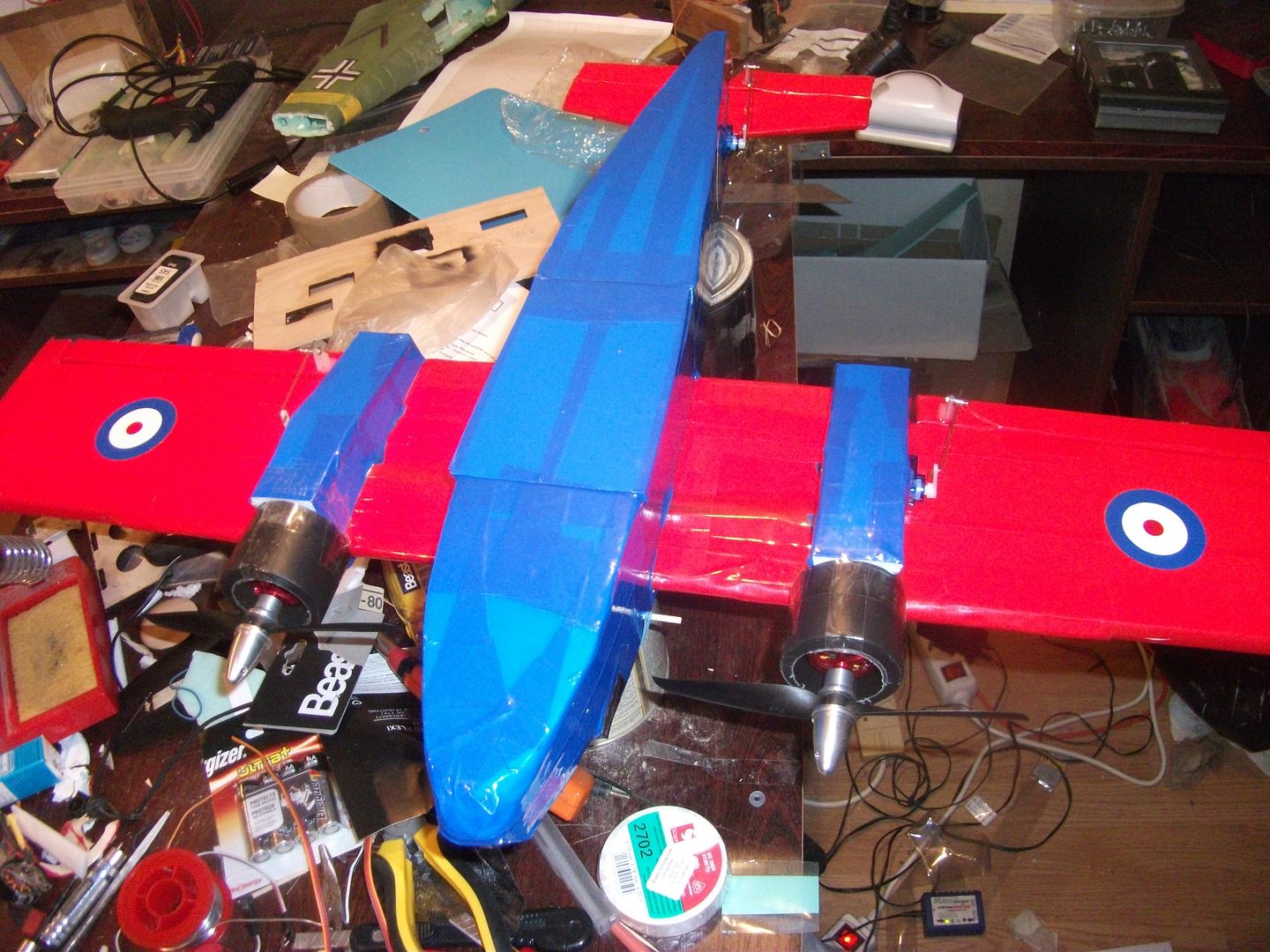

Just waiting ESC's ad fit U/C .....
Turns out that LiPo's are now right up front ... ESC's will be under wing ... Rx is set under wing also.
I decided to do without flaps, but so I can fit later if decided - I pinned them in place and taped up. Just means slice tape ... pull out and hinge.
Quite pleased for a quick sketch .. cut and build !
Old 04-21-2015, 12:26 AM
Posts: 2,035
Looks very nice
But if it were me.......
I would double the size of the fin (4 times the area) and probably 1.4 times (double the area) the tailplane too!
quorneng is offline
Old 04-21-2015, 08:33 AM
Posts: 12,786
Originally Posted by quorneng View Post
Looks very nice
Its funny .... I used another plan for the foundation ... ie ratios of parts.
I agree that the tail parts look small in the photos, in actual they are not so bad.

Posts: 12,786

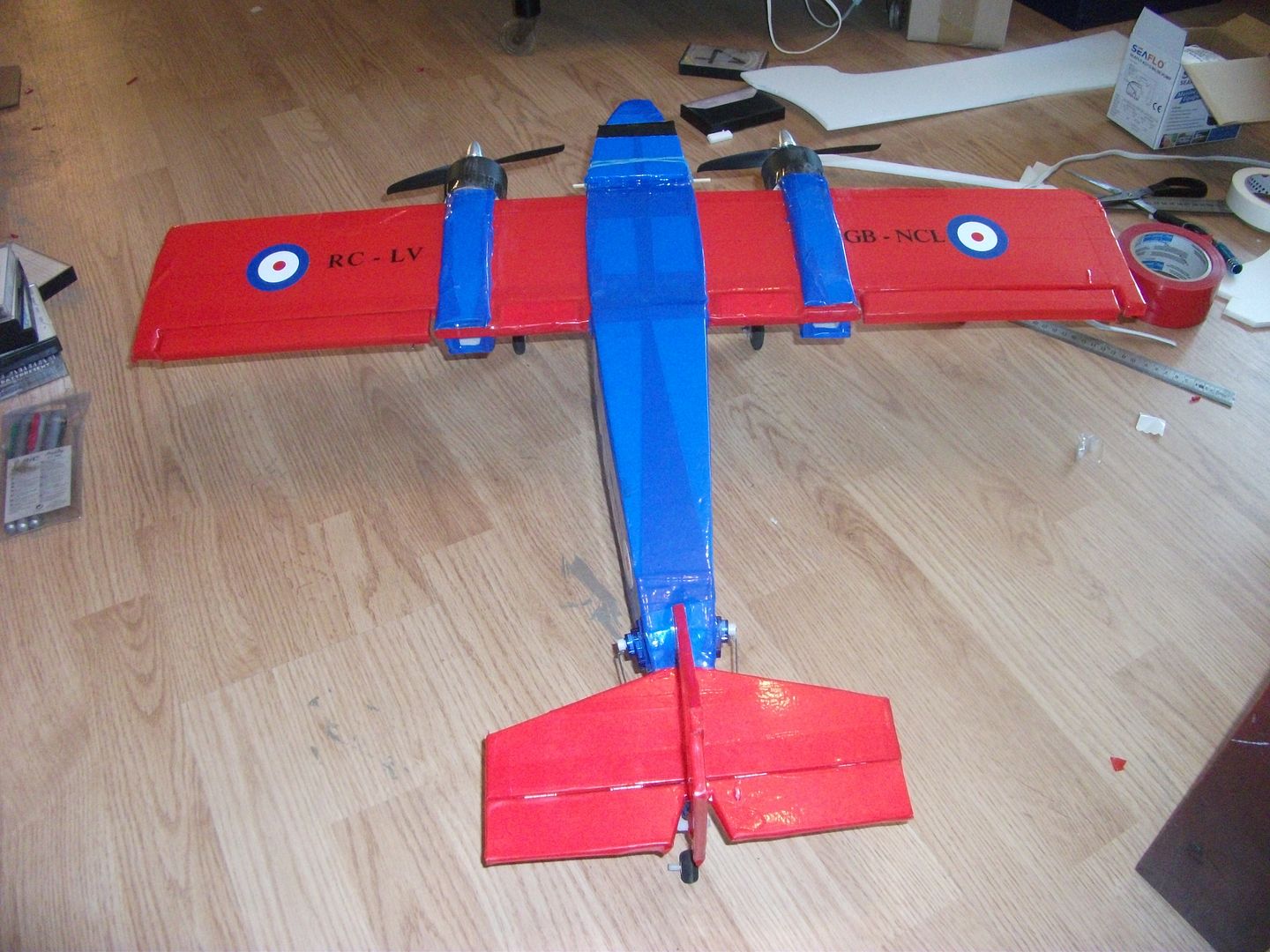

OK - She's already to go ....
Tested the motors on 2S and 6x4 props .... WOW ! ..... and I kept them going for reasonable run .... no sign of overheating or hot at all.
She has easily more than enough for vertical ... on storage charge LiPo's ... she was trying to leave my hand !
Q ... now view from rear shows the tail is not as small as first appears ... but I do agree with you - it could do with a touch more ...
