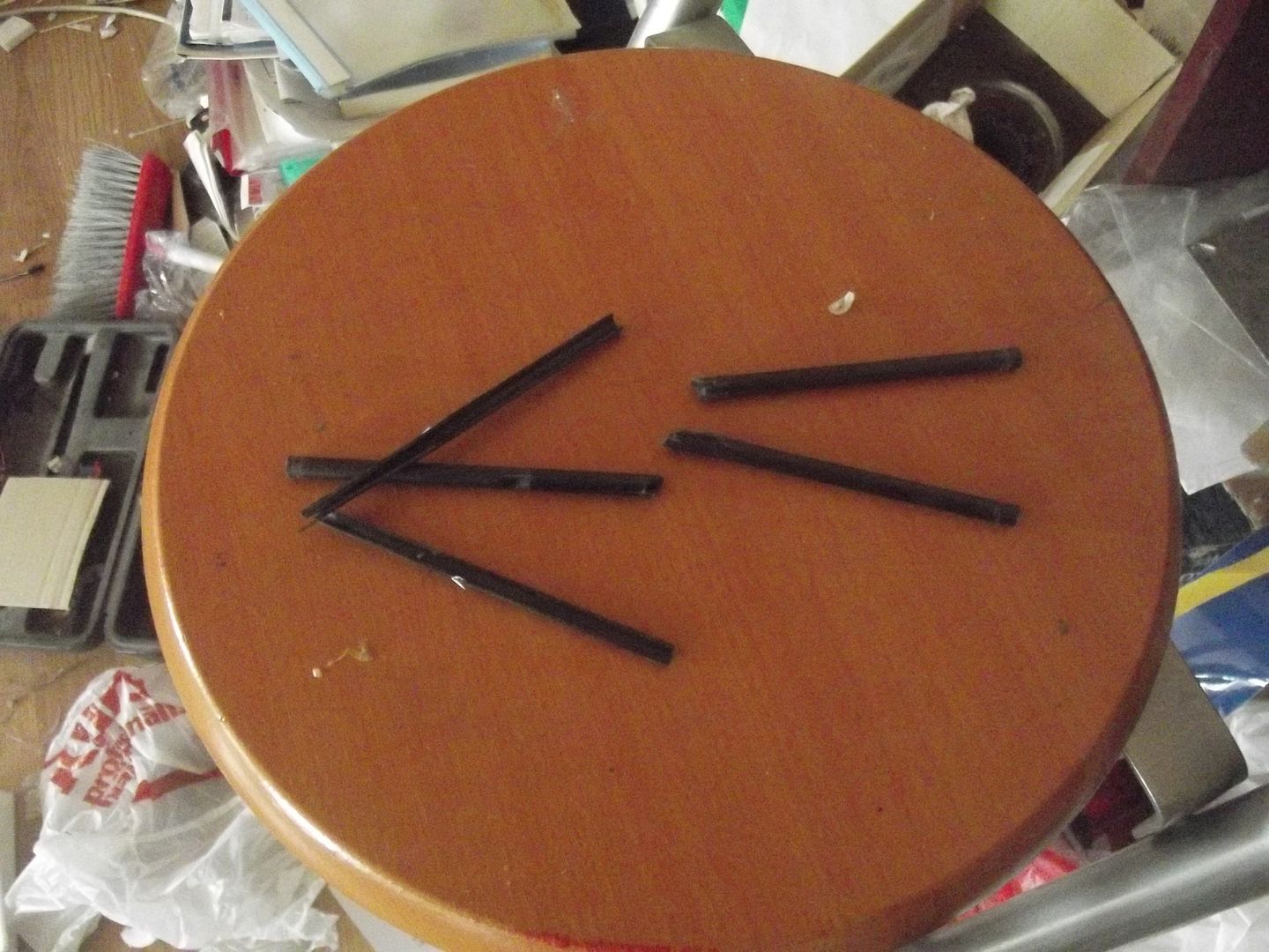

CF rods in the fuselage can be seen to have splintered ..
They pulled out and basically fell apart ..

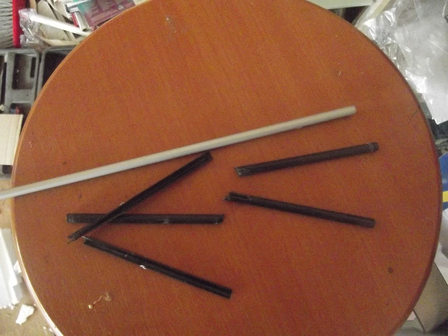

They are 6mm OD and it just so happens I have 6mm OD alloy tube ... which would make a good substitute. Weighing shows the alloy to be 18gr and the CF removed about 10gr. So not a problem I feel.

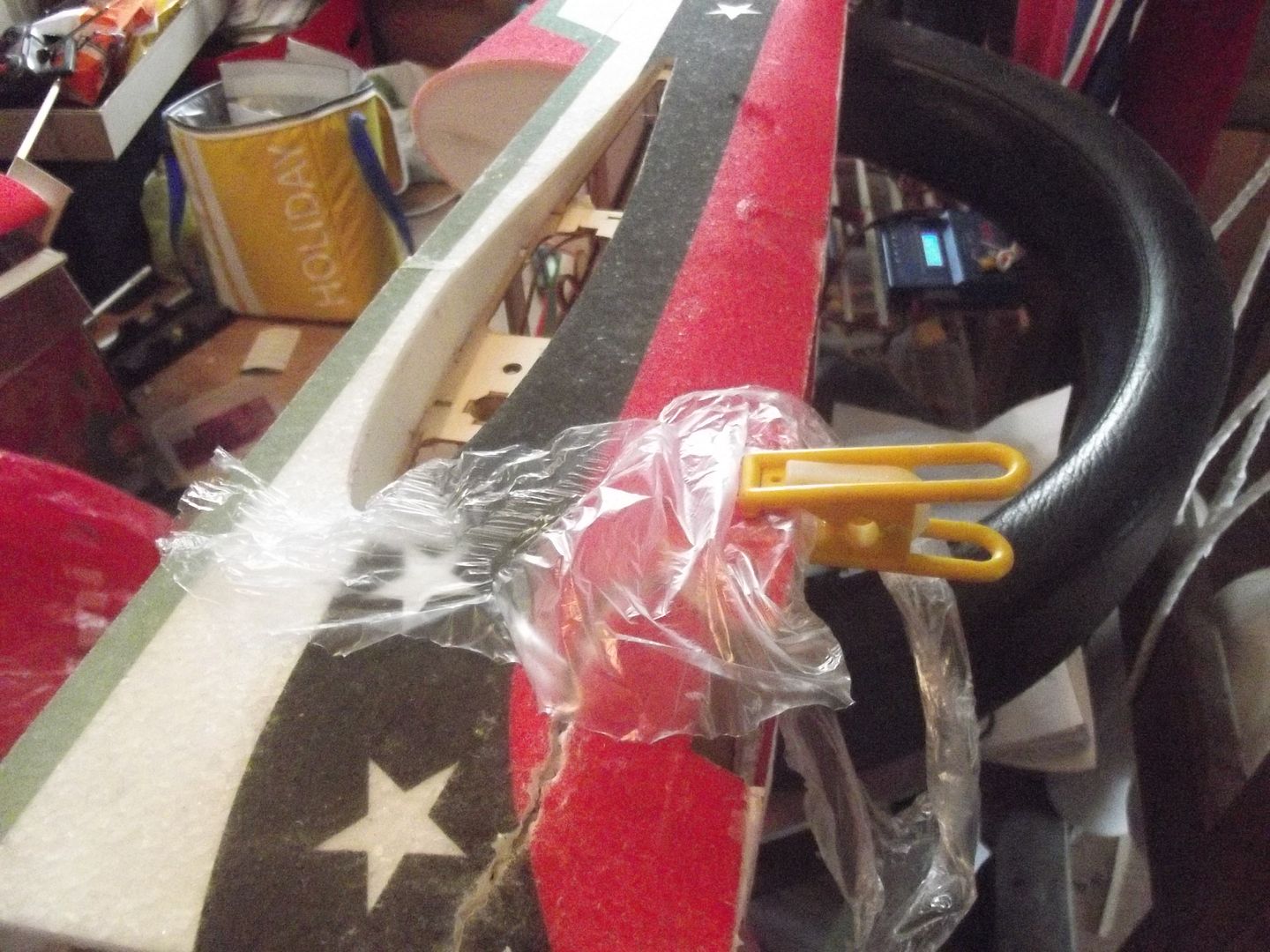

Start tacking the split EPP back together to form the shell ..
Clamps and flat plates to get lines back as best as possible ...

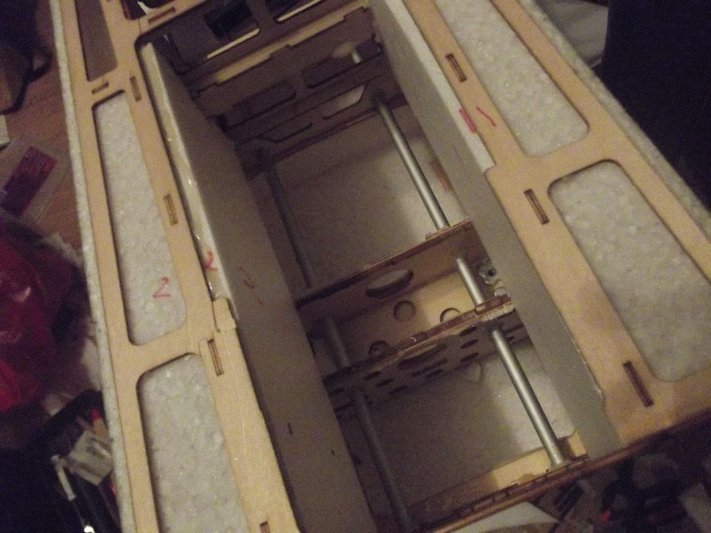

Alloy tubes in and start to fit faceplate...

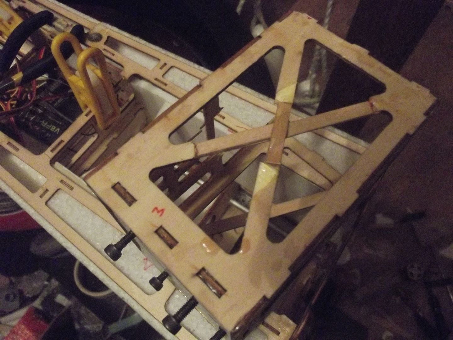

I have a bagful of Coffee stirrer stcks that are excellent for recreating these skeletal frames. They can be scarfed in / butted / doubled to create strong formers.
I also intend to use Depron here to make sure I get stiff structure but lightweight.

OK getting nearly there ...
Motor box is repaired on 3 sides except for bottom where I will splice in a new battery tray once its fitted to faceplate ..
I have stiffened up the front box round battery area with 6mm depron either side and will then get cross brace strips to keep sides apart ! ...
The new battery tray also locks the undercarraige box in place with the rods.
