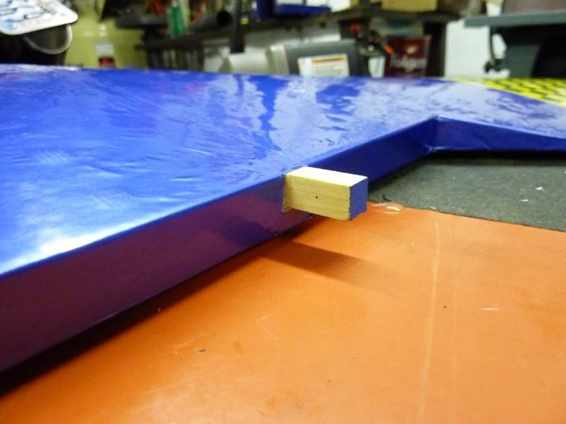

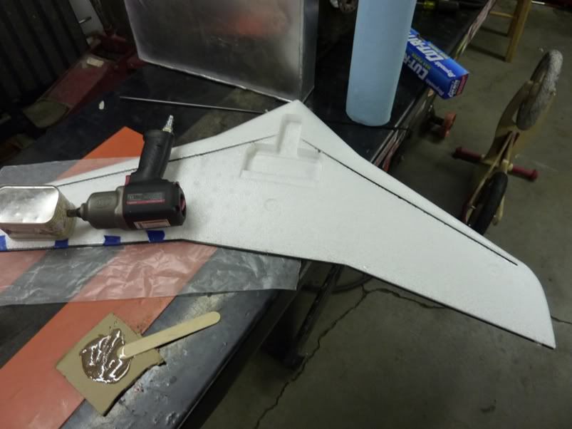

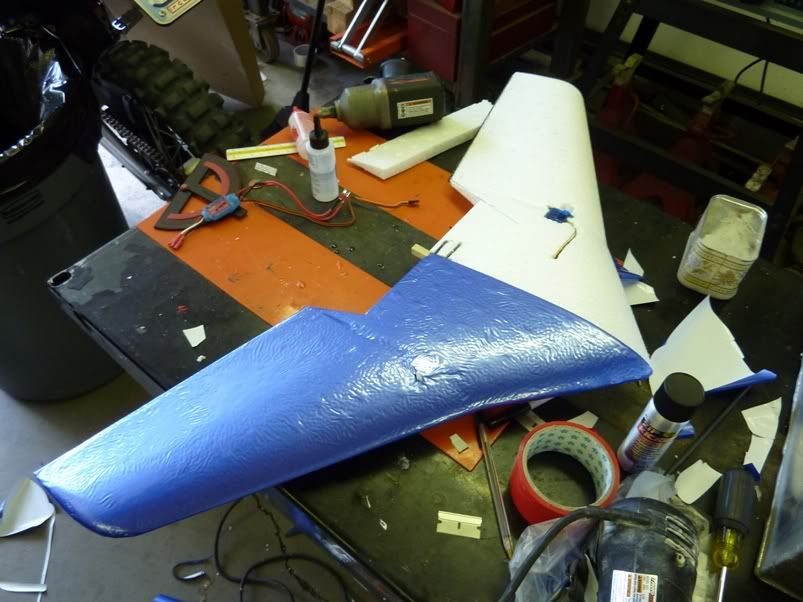

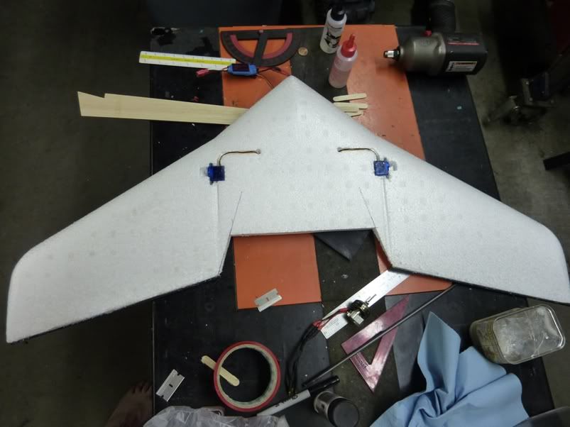

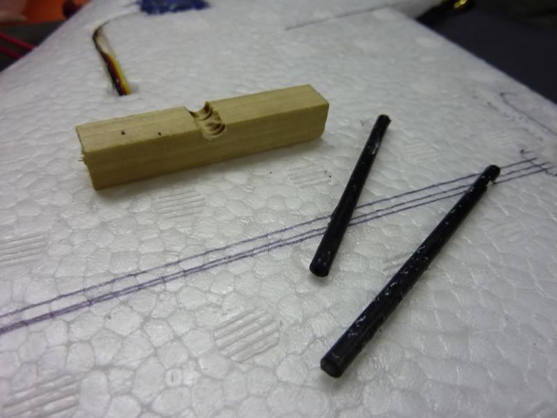

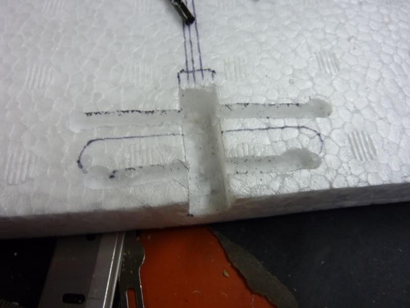

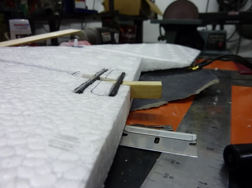

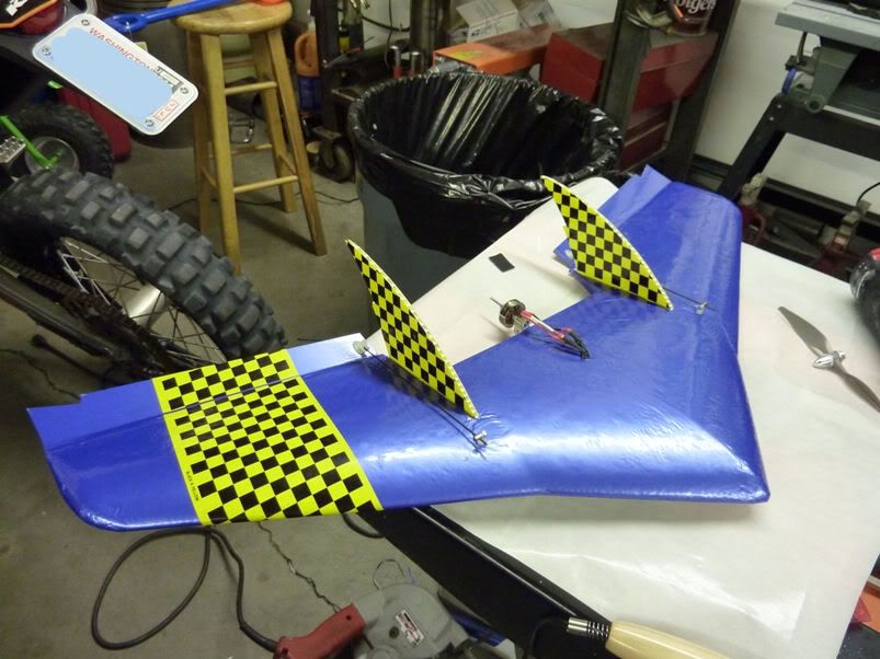

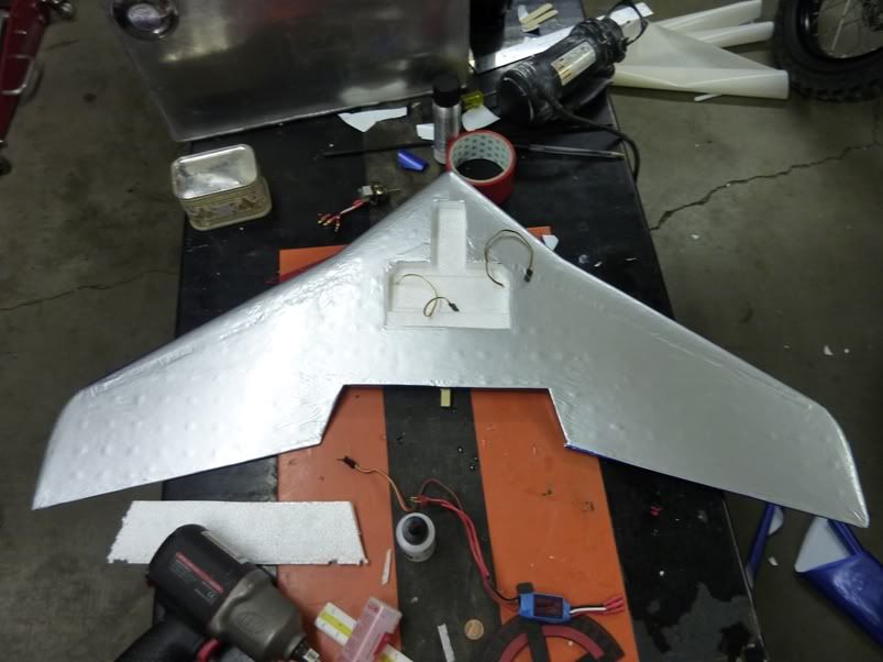

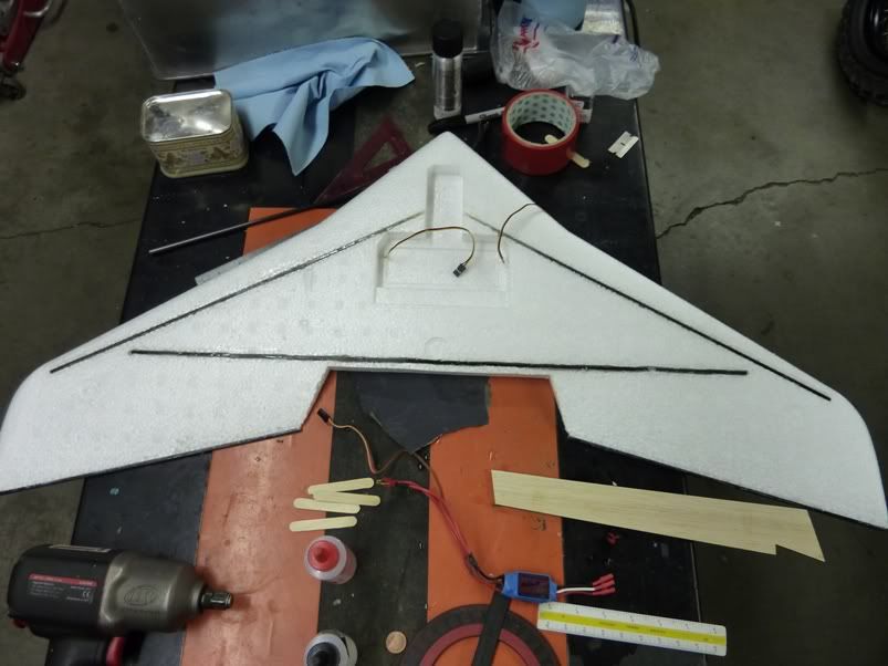

thought I would post up some pics of my build so far. Had this Wild Wing kit in the garage for the past two years.....got to looking around and I have enough spare parts to put this thing together so I figured I would get going on it. I changed a few things on the kit to hopefully make it fly better. I removed about 3" worth of EPP foam from the rear of the wing to move the motor forward and help CG balance out correctly. I also routed a groove and added another carbon fiber spar to increase the stiffness of the wing. I covered it in iron-on Ultra Coat. For the motor mount I used a piece of hard wood and two carbon rod pieces, routed out the openings for the wood and the rods and epoxied them into place (thrust angle even with the bottom of the wing). Not to far from finishing things up now, the battery I wanted to use won't fit (3S 2100MAH Lipo) so I may router out a little more clearance and try a 1300MAH batt. I think I may still have to add lead in the nose to get the CG right if I can't use the 2100 Batt. I'm going to try a BP21 Brushless motor ($9.99) and a 7x6E prop.
Here's a few pics so far.
The start of the build. Using Epoxy to attach the trailing edge carbon rods.
Here you can see the area of foam I removed to move the motor closer towards the nose of the wing. You can also see the extra carbon spar I added to the wing.

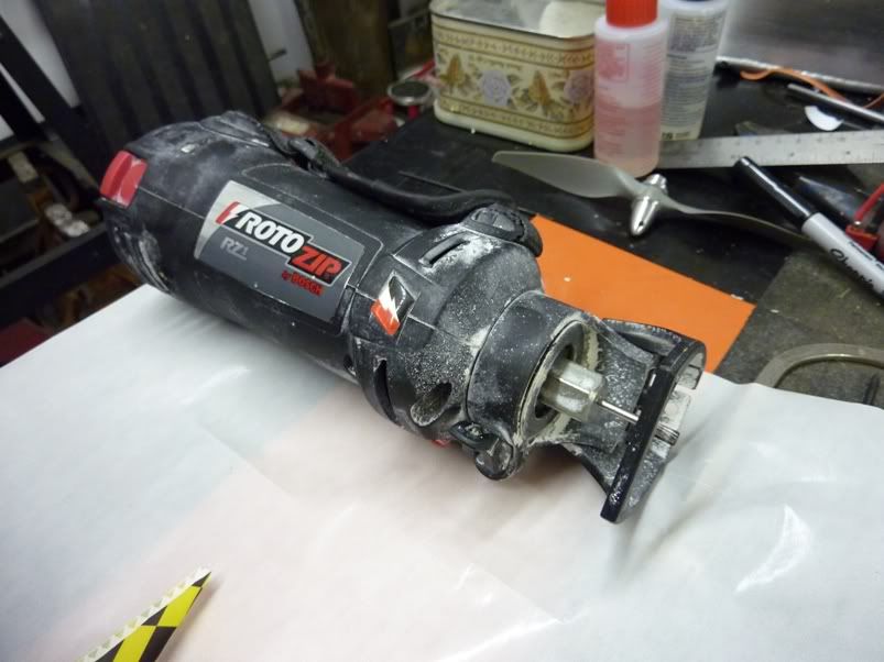

This is the setup that I use for routing out foam. Works great for installing spars, opening up battery bays, etc. Roto-Zip with a small router bit. Just set the depth on the guide and trim away, leaves a nice clean edge.
HS55 Servos installed using low temp Hot Glue.
I decided to use a made in China BP21 Brushless Motor on this build, they are cheap ($9.99) and they hold up great! The plastic motor mount that comes with the kit is junk, plus it won't work with the BP21. I decided to fabricate a mount from scratch. A piece of hard wood and a couple carbon rod pieces later and instant motor mount.
Here's the mounting area all routed out with the Roto-Zip.
And the mount resting in place before using epoxy to lock it in place. It doesn't really look like it in these pics but the motor is parallel with the bottom of the wing, not the top.
You don't have to add covering to the wind but it does make the wing stiffer and stronger. I lightly sanded the wing and used Ultracoat for the covering. I decided not to "glass" this wing like I did the SledgeHammer to save weight.
Underside in Silver. I'll add some orange to the underside as well before I'm finished.
Engine mount stick. Still a little long in this pic, I cut it down some before bolting up the motor.
Getting close to being finished. Still have a little wiring up to do then head down to the park for the maiden flight. Hope it goes well, should be a fun little wing!
I should have just made it ultra light with foam ailerons etc, oh well...it will still be a kick to fly. I'm going to change the batt location to be sideways and farther into the nose to help with the CG.
