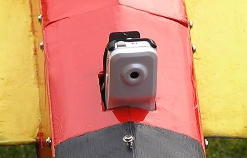

Default finished scratch built
Finally finished the scratch built I started a few weeks ago and it has the video cam mounted. Waiting for this cold wet winter weather to subside so I can fly. NZ has had the wettest winter for years and all the local paddocks are waterlogged.
Have used the small Turnigy video cam in the car and around home in the meantime. Good value for $18-59 from Hobby city. File sizes are large but I use "Format Factory" to convert the file type to a better format

Interesting looking plane there Enkay, what kind of motor?
Is that a steerable nose wheel there?
Hope it flys good for ya.
Crashalott is offline
Old 07-27-2010, 11:57 AM
  #1286
Enkay
Enkay's Avatar
Location: Havelock North, NZ
Posts: 56
No nose steering. This is line it up and point and go.
The motor is a Turnigy 22-13 20 turn 1050KV 19 A brusless outrunner. I have tested it with a 9 x 6 APC prop at 228 Watts. Just over 19 amps.
Cost $11-93 from Hobby City. A more powerful motor would have been a KD A22-20L outrunner 1000kv --25A. Cost $13-99
