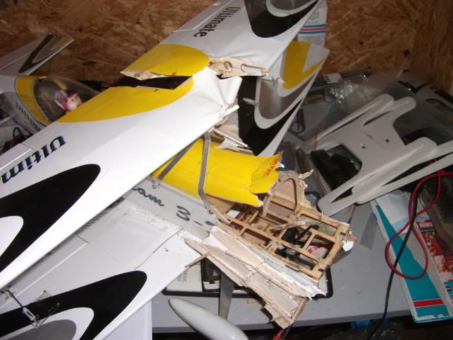

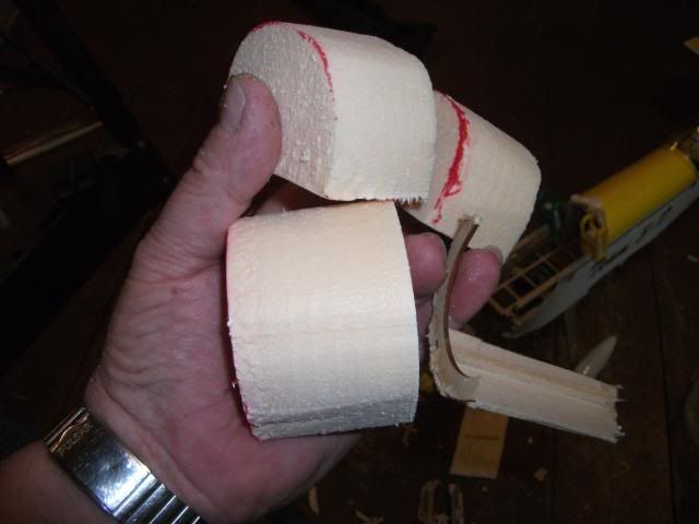

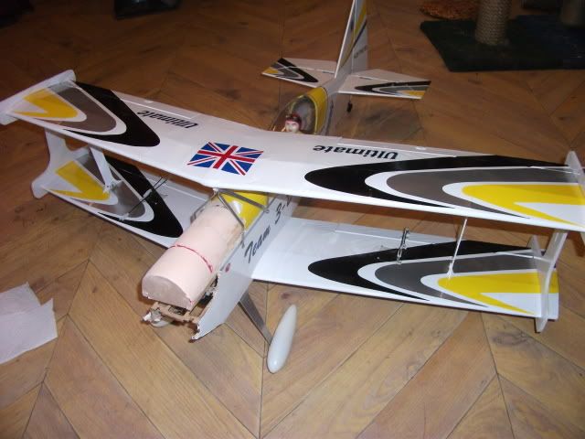

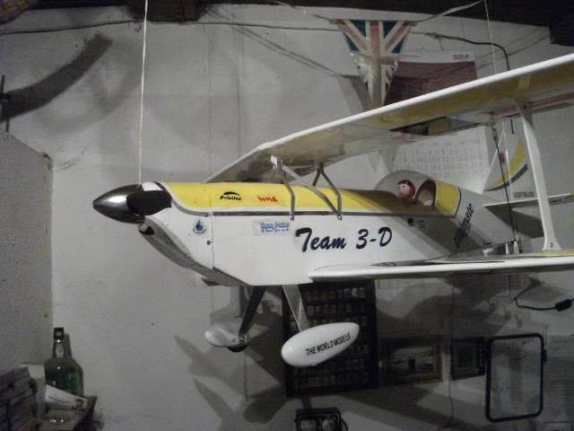

Me - I live in both camps and happily combine both .... as both have advantages.
Foamy to me is any model that is airframe in foam whether profile or full bodied.
But as to my combo approach ... here's a complete wood Ultimate that was repaired with foam ... giving me a quieter and stronger airframe ...
I may be an old dog from balsa and tissue days ... but I can still learn new tricks !!

Cool! theres a Hy'bread RC plane!bubsteve

I can honestly say it flies quieter, better than ever it did as original. And it no longer has that fragile motor mount / front end ....

Many UK based model kit producers like Mick Reeves, Rojair etc. used veneered foam top-decks to fuselages .... developed on from the veneered foam wings.
It made for strong, good looking, easy to build models that flew excellently.
The idea can be adapted as I did for the Ultimate repair ... the only part I left of was I decided later not to veneer over with thin balsa ... a trick that really smooths it all out and gives that last bit of finish before covering.
Foam drinking cups as cowls .... sliced through as scoops .... there are loads of things out there in foam that easily adapt to our use.
