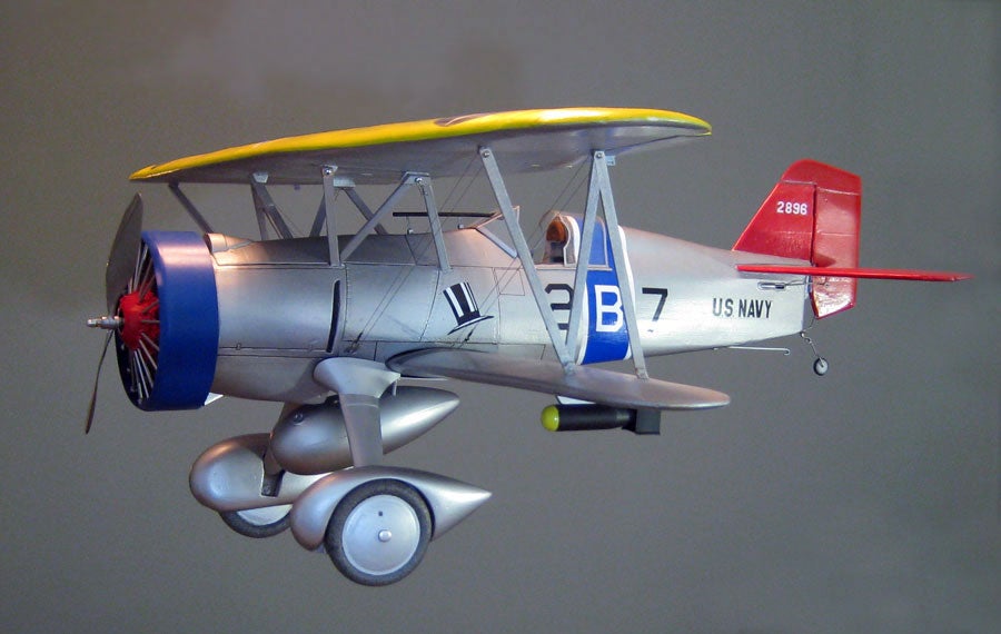

I use Benjamin Moore Stays Clear Acrylic Polyurethane. Yes, it's water based. I always have plenty around for woodworking so I use it on my foamies too.
I apply mine with a Critter Spray Siphon gun:
http://www.crittersprayproducts.com/
Stays Clear sprays beautifully, no bubbles, and dries fast... to fast actually, I have to thin it with 1:4 (water:PU).
My last project was the E-Starter. I glassed the fuse and wingtips with BM Stays Clear and 0.5oz glass. Color is just Acrylic craft paint, then top coated with more BM Stays Clear for durability and gloss.
She came out pretty good:
