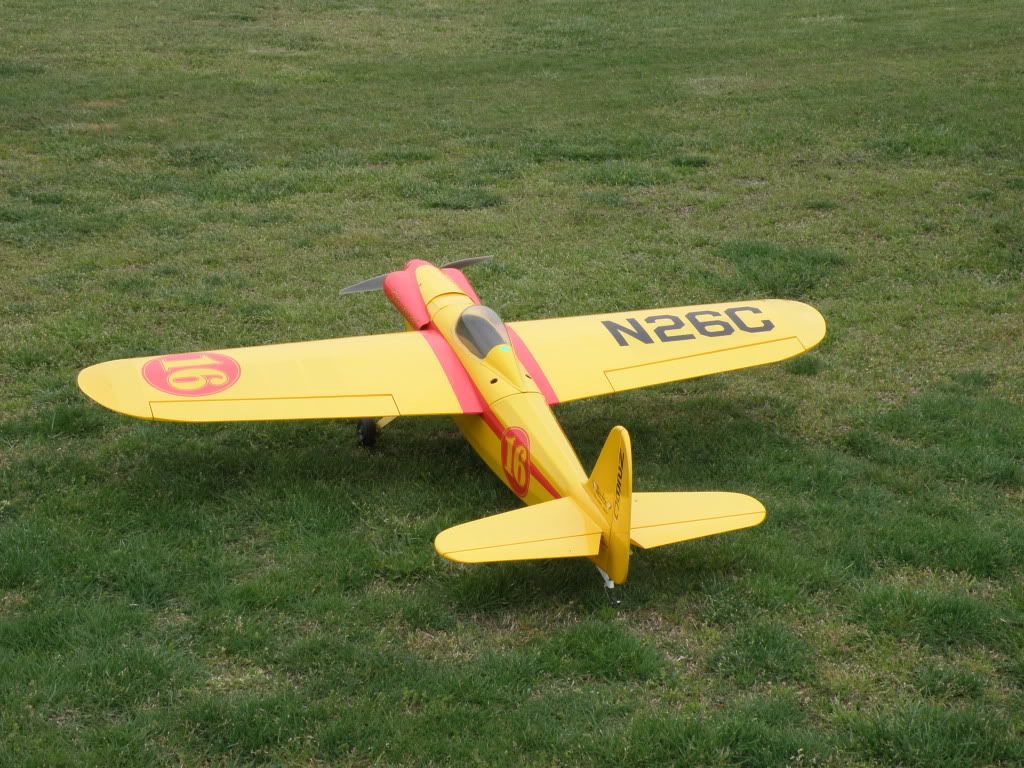

I didn't realize how big she was until I went and found a stock photo:
What did your AUW end up being?
max2112 is offline
Old 04-20-2009, 03:13 AM
Posts: 20,747
Thanks John, AUW is 8.2 lbs.
Specs
Welgard 4130/08 outrunner
14x10 thin electric prop
8s 4000 (2 4s in series)
1100mah Nimh Flight battery
Castle Creations Phoenix 60 ESC
Spektrum AR7000 Rx
Spektrum DS821 Digital Servos.
1000 watts total power
