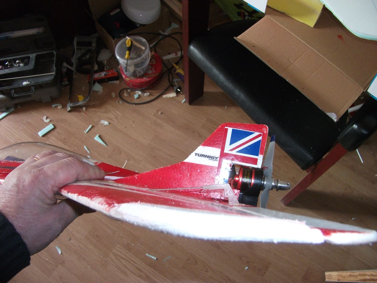

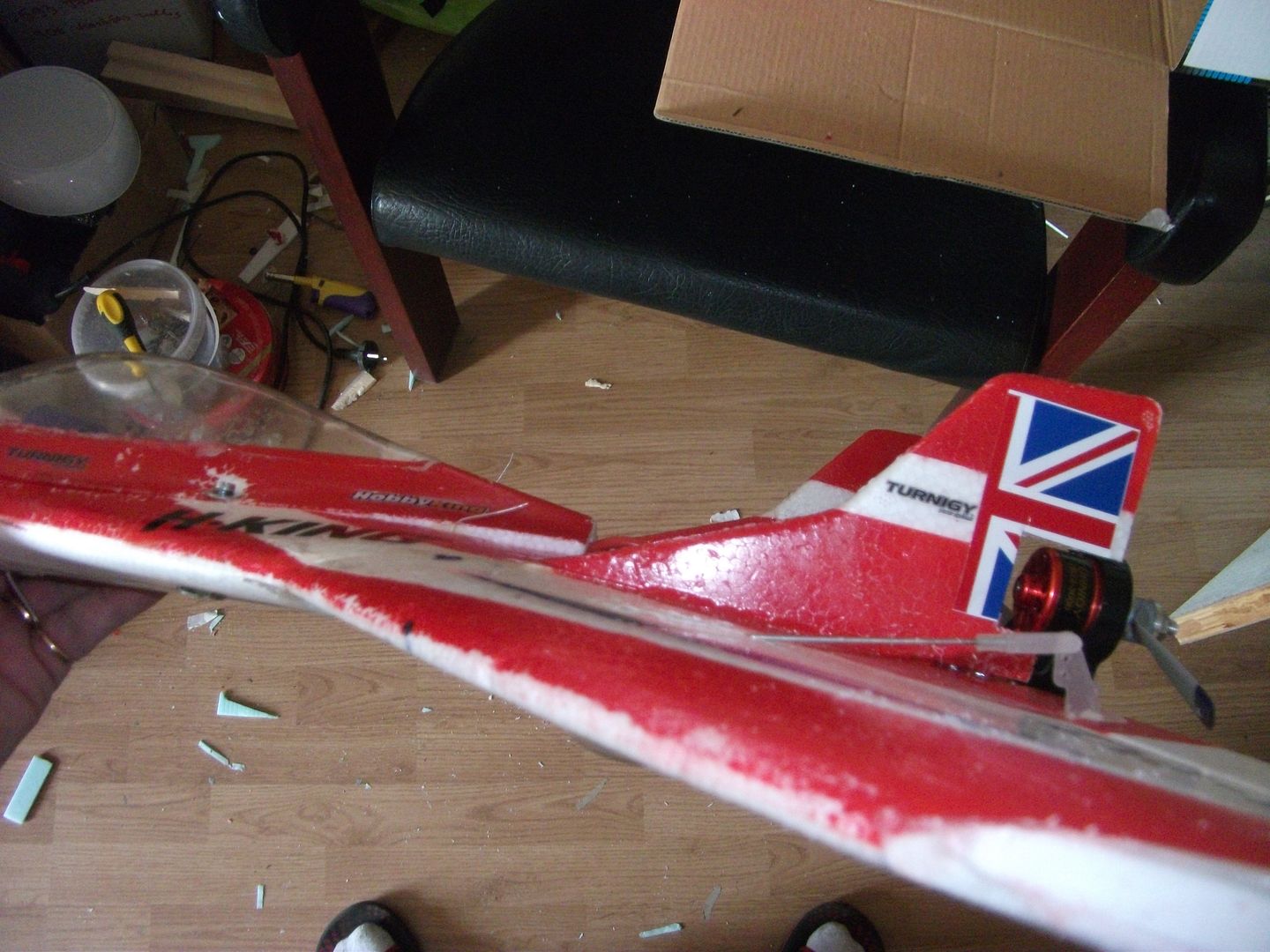

For those who want a more sturdy PKJ ...
We see many modification recc'ds for this baby and I would like to now list my personal ones :
a) Elevons are flimsy to say the least and unsuitable for anything other than sport flying ... any hard manouevring or speed and they will soon let you know. On my first PKJ that hit 222kph - I did as many - used CF rod running span of them. But that soon proved to fail as the foam let the epoxy go and the rods starting to exit the grooves ... So I looked for alternative that would also be better cosmetically. Thin 1/16th balsa sheet epoxied to the underside of the elevons gives a nice smooth and strong stiff form. The balsa can be sanded to regain the trailing edge. The epoxy in the 'sandwich' really does stiffen it up.
b) The fuselage especially at wing joint and at rear where channel is cut for motor leads etc. is weak. So my remedy again is balsa but in form of 1/4 sq beams. 2 of them parallel set into the underside from just about where the airscoop hole is back to mid wing position. These not only are light - but with epoxy again are stiff ... they also provide anchor for stitching to hold the Velcro inside canopy for battery hold downs.
c) On the twin - the channel cut at rear of fuselage is filled in with pink foam to make more rigid.
d) Servo rods and horns on top of wing ... servo still fitted underside. 9gr used instead of the smaller recc'd. The stock control rods are fine and never given trouble.
e) Canopy hold down is by two bolts and blind nuts. The blind nuts are pressed into the underside of fuselage and the bolts go down through the side ;pieces of the canopy ... via holes in fuselage to the blind nuts. This makes sure that canopy becomes one with fuselage and helps stiffen it up. There is no chance of canopy ever 'flying off' in flight !! At over 200kph - it needs serious hold-down !
f) On the single motor PKJ - the motor mounts are fragile and my answer was a L furniture bracket drilled to fit motor ... the bottom part of the L then set into a slot below the wood beam and set in with epoxy. A single self-tapper then through bracket and up into the wood beam. This steel bracket enabled bending to desired thrust angle if required.
g) On the twin - I use plastic RCTimer beam mounts to 10mm sq beams epoxied alongside the fins and to the fuselage. These plastic mounts are more forgiving than metal.
h) Battery retention is by two Velcro straps as sold for 450 helicopters ... I first cut in half to i) remove the buckle, and ii) flip one round so they fasten together. Second the strips are epoxied into bottom of cockpit area and BEFORE epoxy dries - carpet thread is sewn down and through the balsa beams in underside of fuselage and back up ... tied of. Knots have a drop of CA applied to make permanent. My Velcro straps this way have never lifted !!
i) Once all done - I then smear a thin layer of epoxy along the centre fuselage underside to give some protection for landing.
I do not add anything to the wings - I keep to the original kit CF rods and that's all. The foam wing is thick and has proven more than strong enough.
I will mention glue joints though. The foam used is not so happy with epoxy without a little work done. It needs to be roughed up a little ... if left smooth - the epoxy cannot 'grip' and over time will 'let go' ... So scoring of the glue surfaces to give a good key for the epoxy to sink into and 'grip' cures that.... this applies particularly to the wing to fuselage joints.
So - nothing overly fancy in my mods ... simple, easy and seems to work.

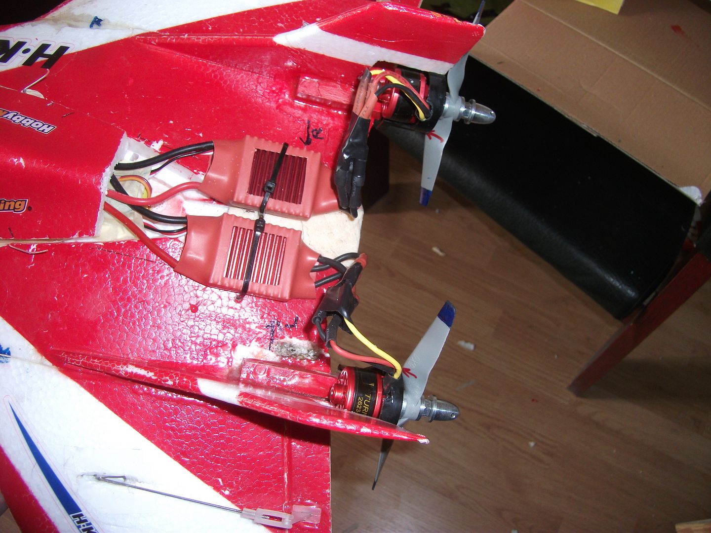

Well motors are now closer to zero thrust line ... in fact when I checked before altering - I was surprised how much DOWN was in the mount.
So shimmed and refitted ...
I added shaft cone nuts behind the prop nuts ... the contra prop had loosened its prop nut ! Plus it adds a few grams weight to tip her back a touch.

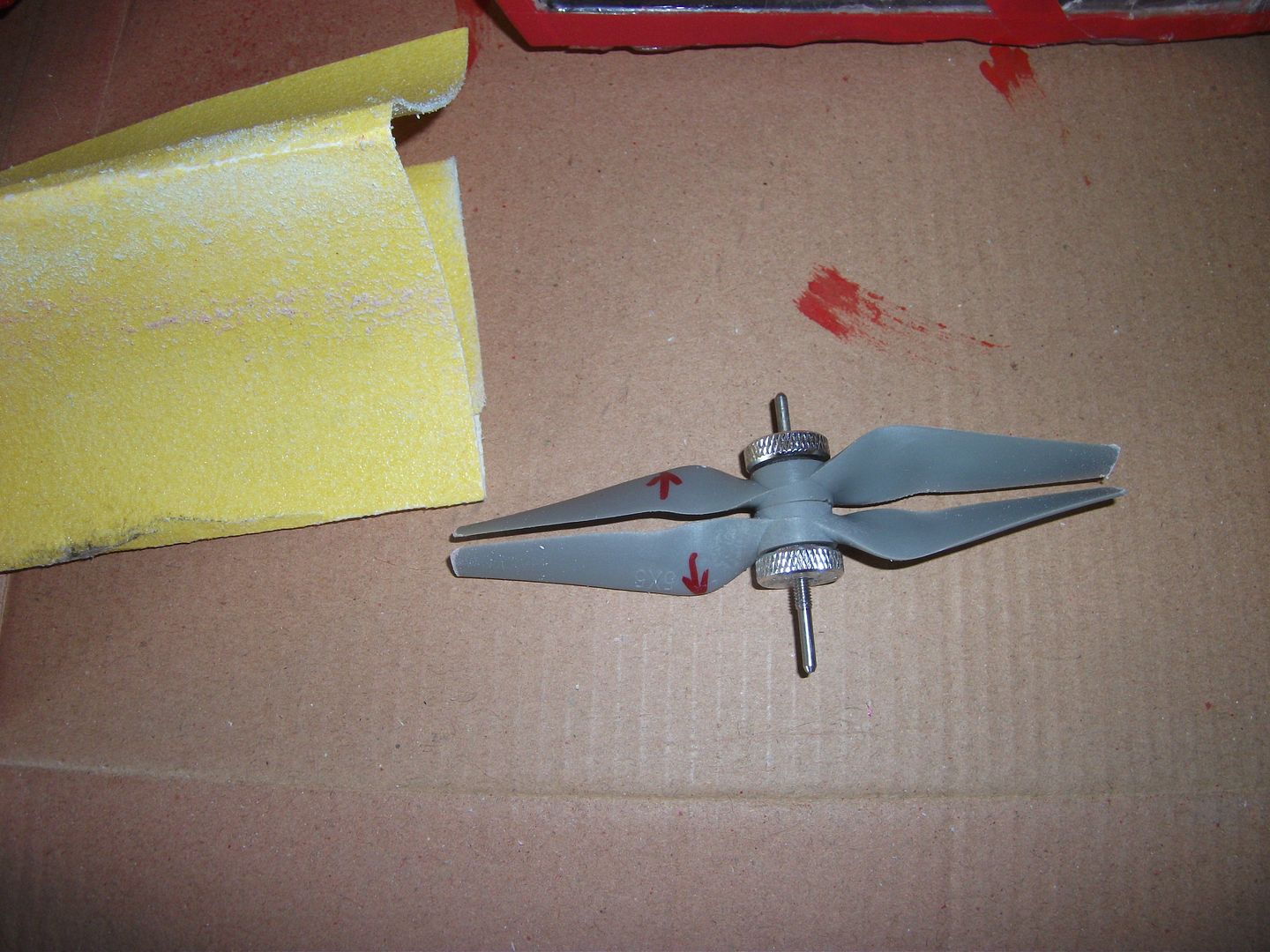

Here's my new props .... 5x5 cut back to 4.5 x 5 ... and matched via the blade balancer. Surprisingly - one prop even though cut, sanded together with it's partner was significantly out of balance and needed a sliver of tape on its back face.

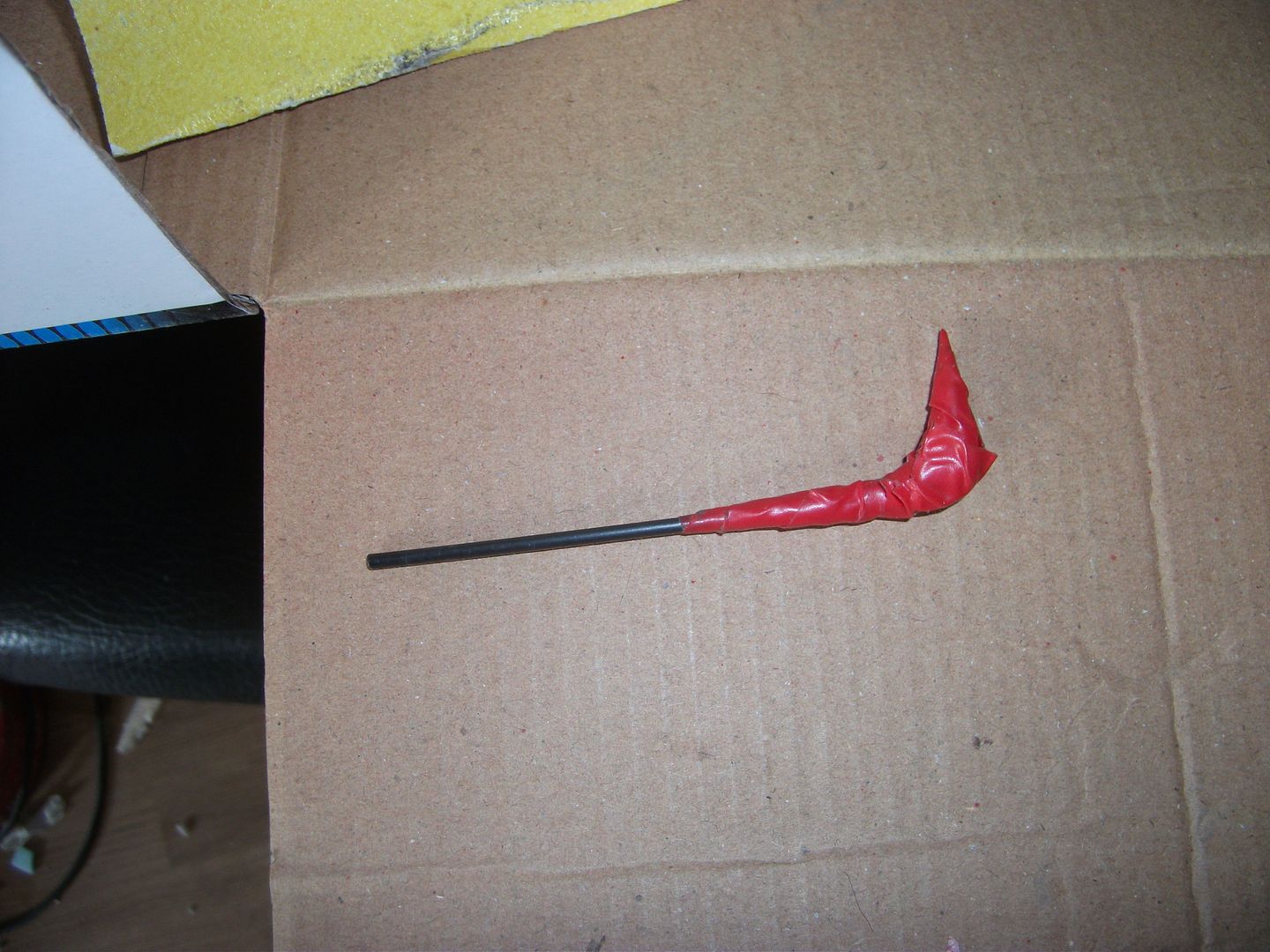

and my prop cone tool .......... always looking for a rod or similar to tighten / undo these cones - I took a offcut of 2mm bar and created a bar tool. Wrapped L end with tape so I can see it in box and also protect my hand from rod end.
