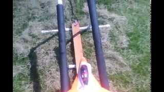

Old 06-09-2014, 01:03 AM
  #643
Posts: 3,692
failed again,minimal damage,she lives to fly again....or at least crash again.
0:42
trimed vid of failed pkj bungee launch
Old 06-09-2014, 07:59 AM
  #644
Posts: 12,442
That appeared to be too much aileron but not enough elevator ?
I see you have the pipe insulation on the rails ... I took mine off - I found it caused friction with it's non-smooth surface. The plastic rails had smoother surface.
I did think about packing tape along the insulation to make more shiny smooth ... but in the end just removed it.
Me going home ? Office keeps saying they are trying to sort something .. so lets hope !
I plan to be home a month - as I have trip to UK to make - Summer Home to get rid of and see my sons ... maybe even find some of my old models from Ex's place to take home !
Old 06-10-2014, 04:34 AM
  #645
Posts: 3,692
i believe your right Nigel on the aileron/elevator along with dumb thumbs. i also think having a video of the launch shows the bungee is stretched to far and i didn't need such a fast launch. the pkj must have hit a hundred mph for that short flight....doesn't that count for an award?[jk]
the vertical fins and the motor mount broke in the failed launch, and the motors shaft got pretty badly bent. it has 3/4inch of shaft showing to put pliers to and i think it's straight enough to have another go.it's remounted and everything is ready.
the funjet weighs considerably more than the parkjet and i should remember to reduce the bungees pull for the parkjet. hopefully i will try again this weekend,so i will leave the launcher in the car,once it finds it's way back into the garage it tends to stay there. to bad theres no place I'd leave it at the field.
