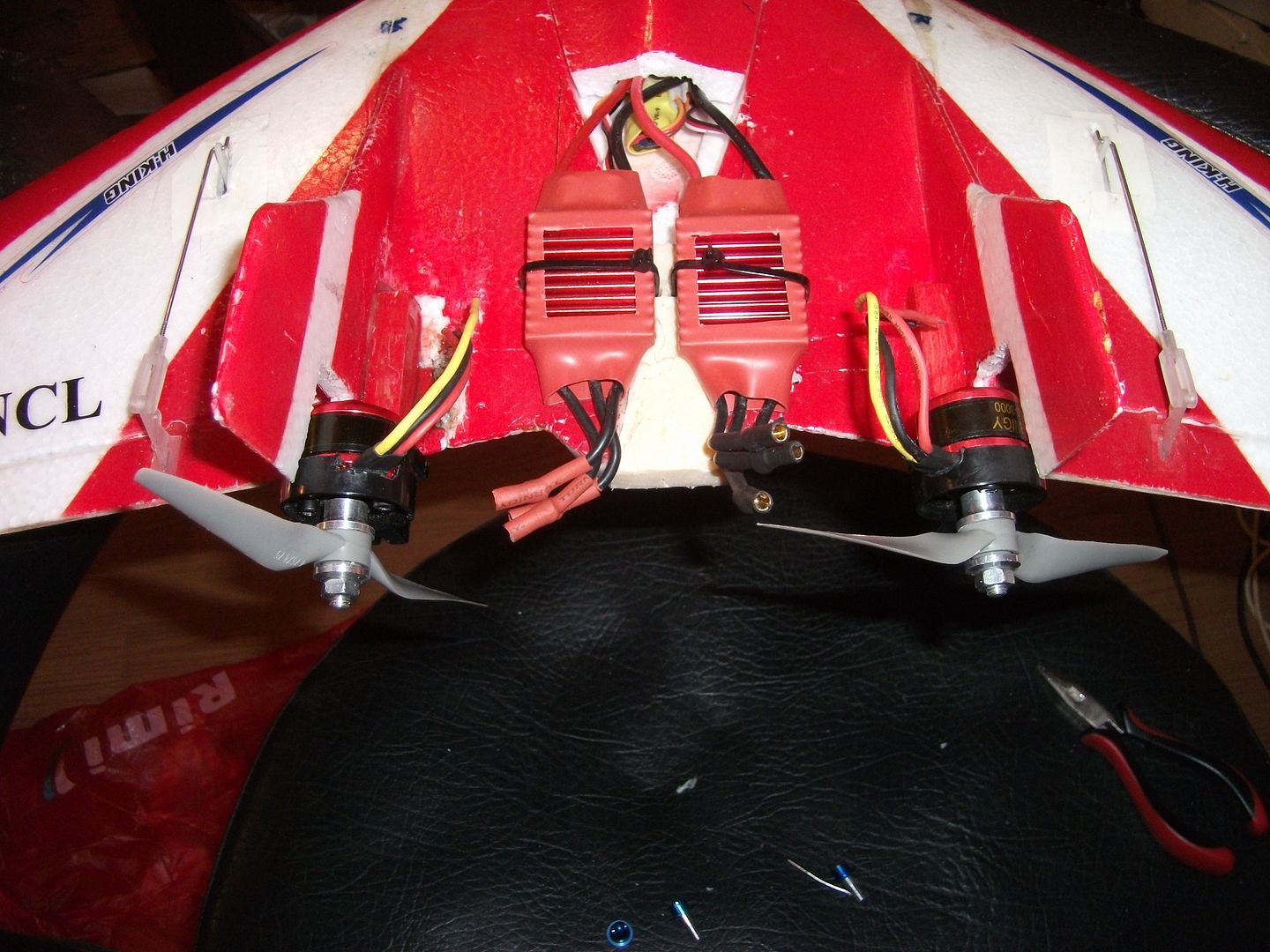

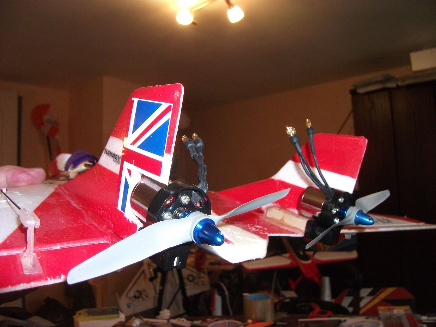

My Twin has the motors mounted higher and set into the fins. She runs 4.5" props not 5" ... so ground clearance is quite good.
(Ignore props here, I know one photo has them backwards ... they were just for photos).

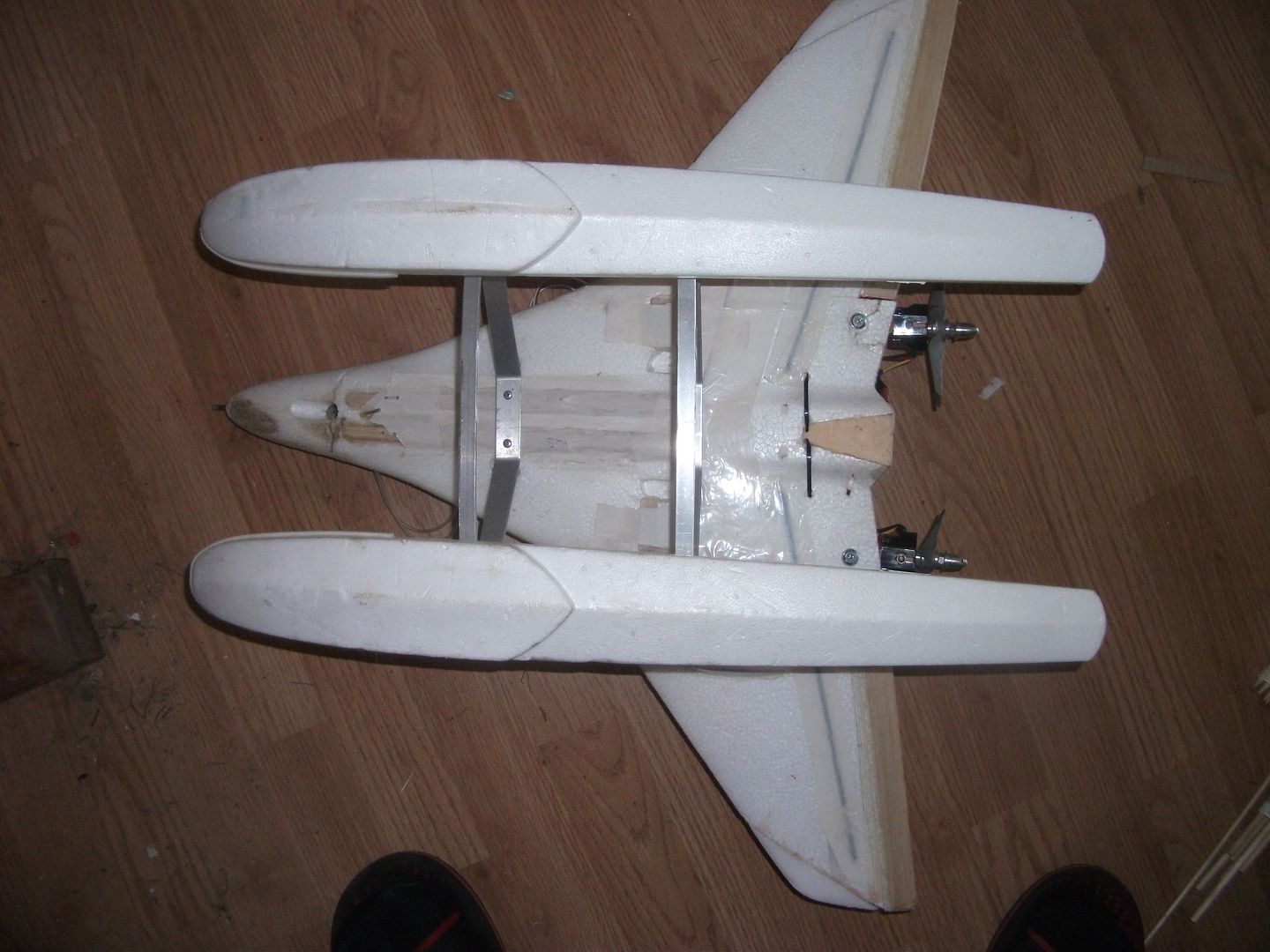

Got to think about height ... weight ... length ....
I think simple box floats with a step just behind finger holes.
Floats to be in line with the 'bumps' under wings ....
Rear end in line with rear of motor bell, so there is slight overhang relative to the wing.
Front end to be in line with about halfway from wing break line to the joint to fuselage.
Width ? about 1.5" ??
Ideas ?

If its hard to launch you may have to think about rather 'cleverer' floats that control the water drag at high speed.
In boating terms that means a deep V hull and possibly a swept back step.
The object is to smoothly loose the hydrodynamic lift and water drag without a significant change in the plane's angle of attack so it can simply 'fly off' the water. Not so easy to arrange.

The Cessna 182 that is giving me real hassle on water ... will be giving up its first set of floats shortly.
They are too long for the PKJ ... but the main forward body is too short ... so my idea is to CUT them shorter on the aft section to basically provide more balanced for the PKJ.
They are light as made of solid foam ... and mounting is simply plates slotted in and epoxied into the foam.

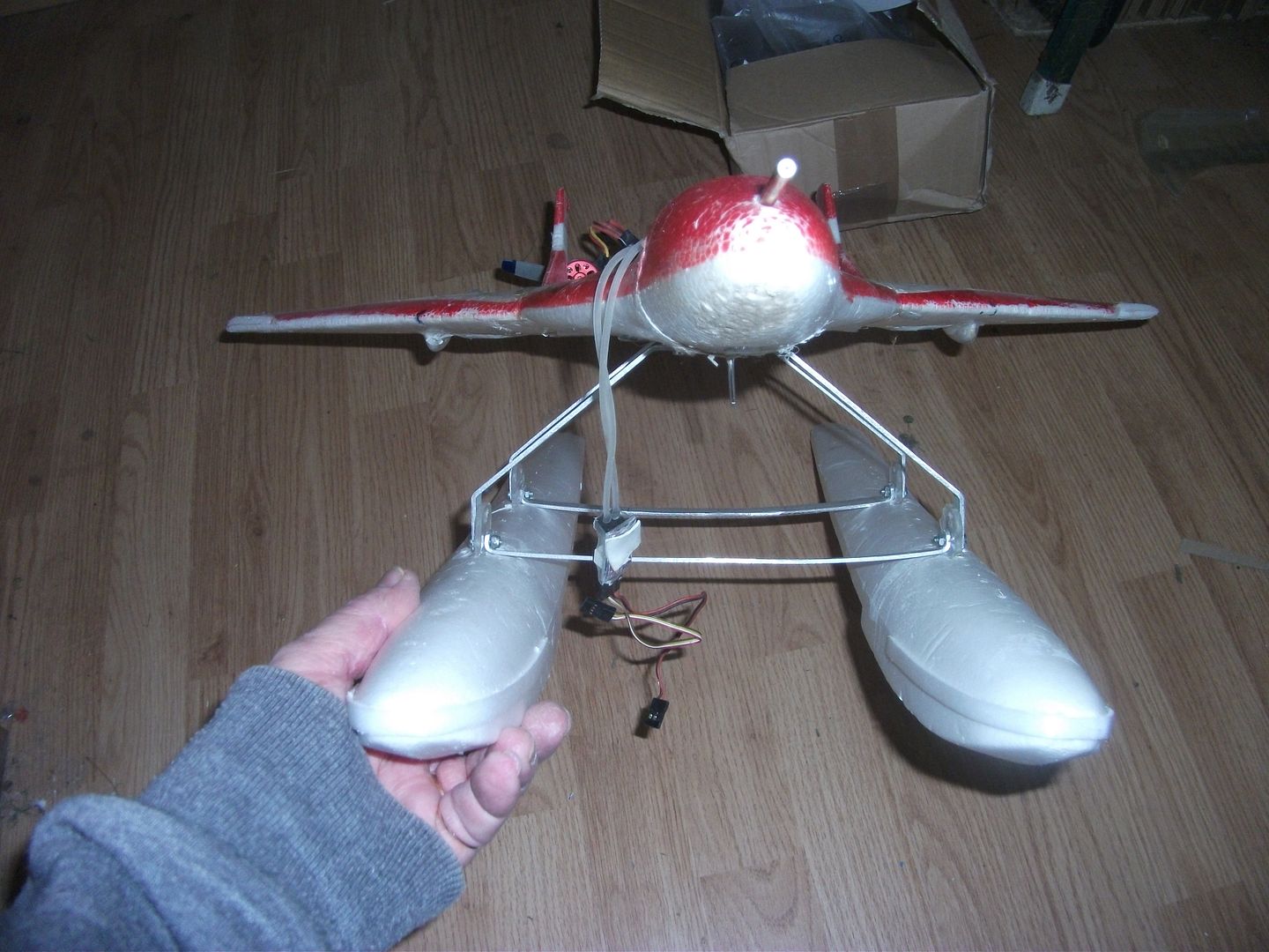

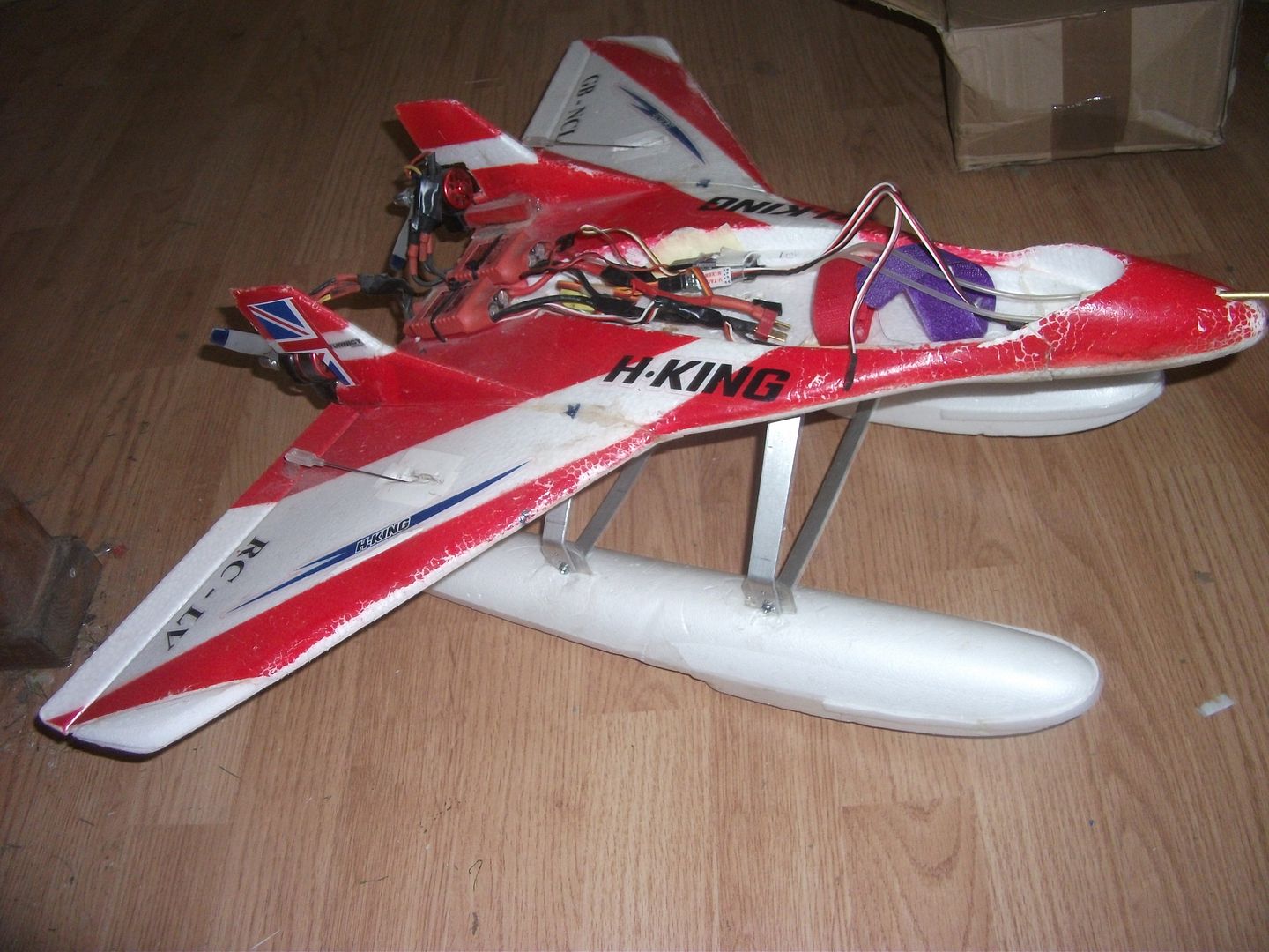

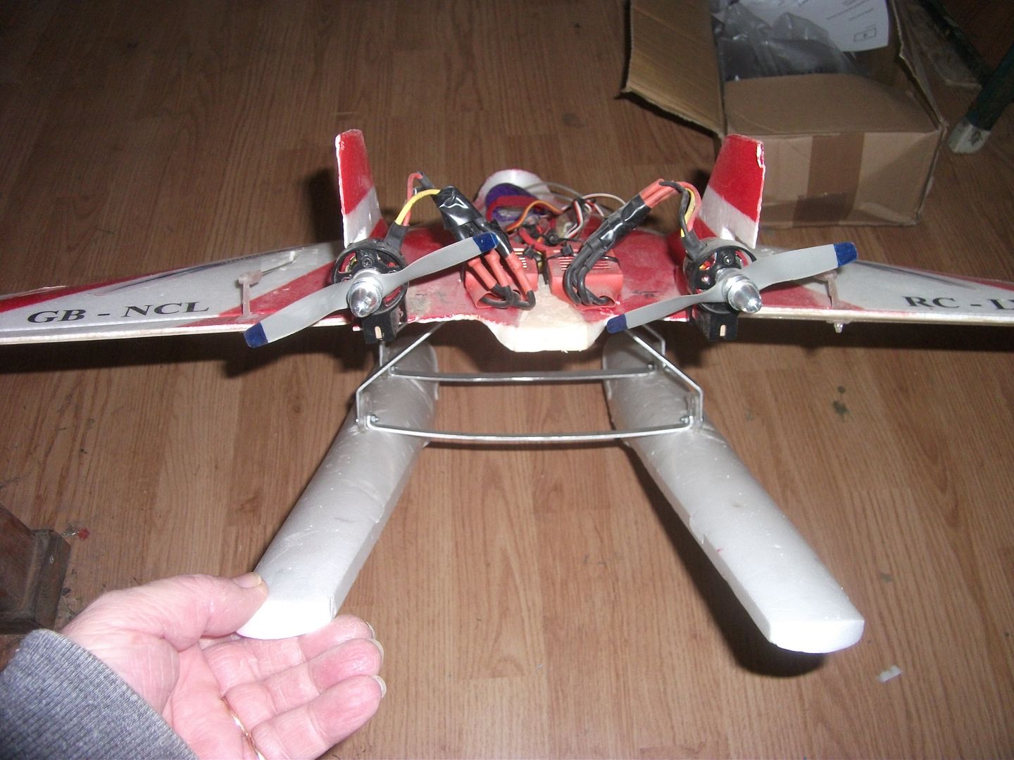

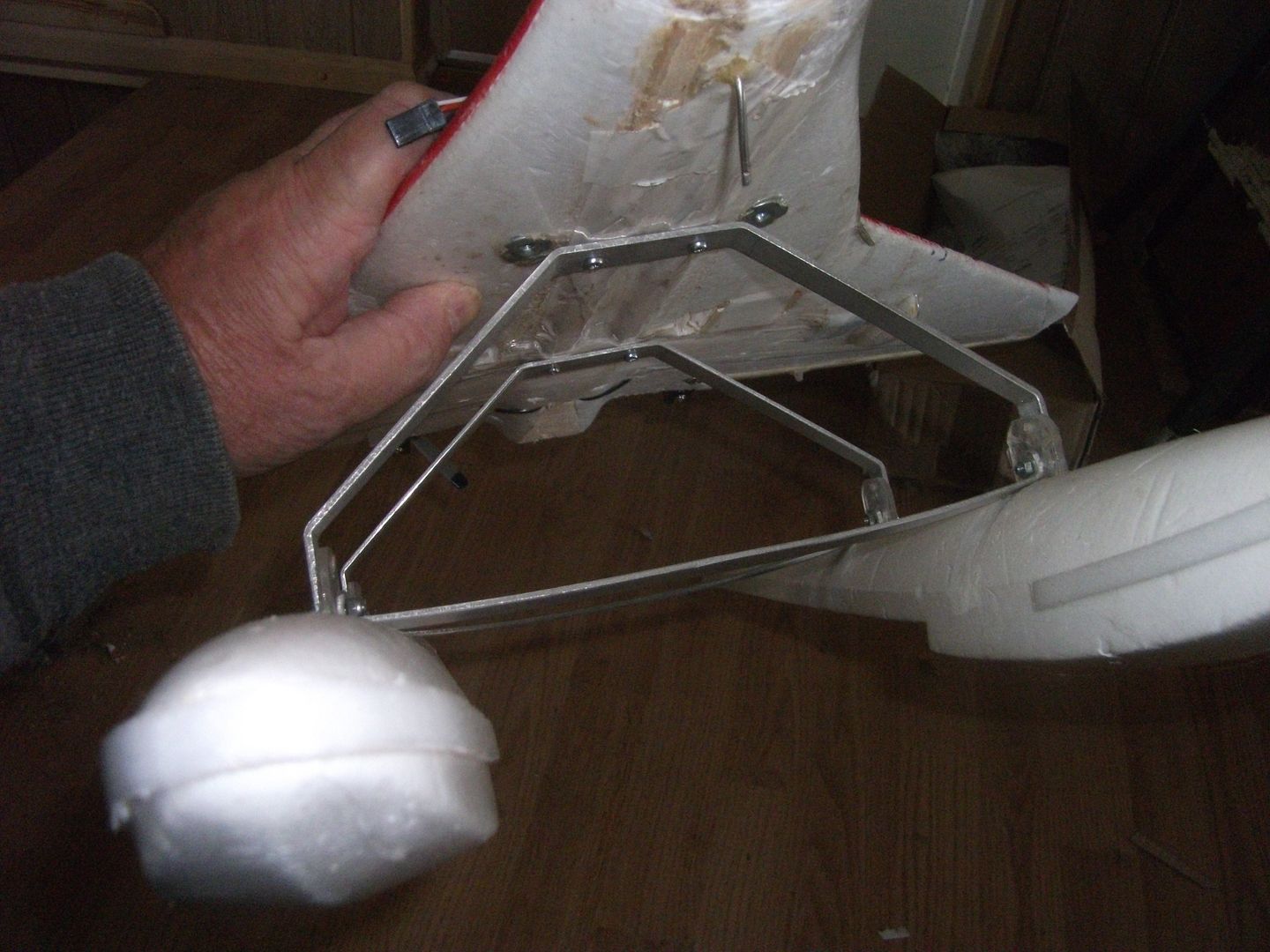

Ok ... here are a few starter piccies ... just fitted roughly to give an idea of what she would look like ...
I used the old spare Cessna floats and I think actually they might just work !!
Weight increase is quite minimal actually ... the model is already grossly overweight. I am planning to swap out the 'hungry' heli motors for Floater-Jet motors - same as I use on my Tu144. That way I can reduce battery reqt's to a more reasonable size / weight. I can also replace those heavy 80A ESC's with something more appropriate !! They also are Opto - so I can get rid of the sBEC ...
You can see the Eagle Tree speed sensor is still there ...
It's more a 'Can it do it ..' project than a speed one. Interesting ...

interesting Nigel. it may work but certainly at a cost for speed. do you think it might just nose over into the water when throttling up? hopefully that doesn't happen getting everything wet thats exposed like the esc's and motors would be a bummer.

Dunno .. it really is a suck it and see ....
The floats are more than required for the model I reckon ... so she should float high and nose up.
As to getting gear wet - that's a price I can live with ... Each part will be wrapped in clingfilm to give some sort of protection, except for motors of course..

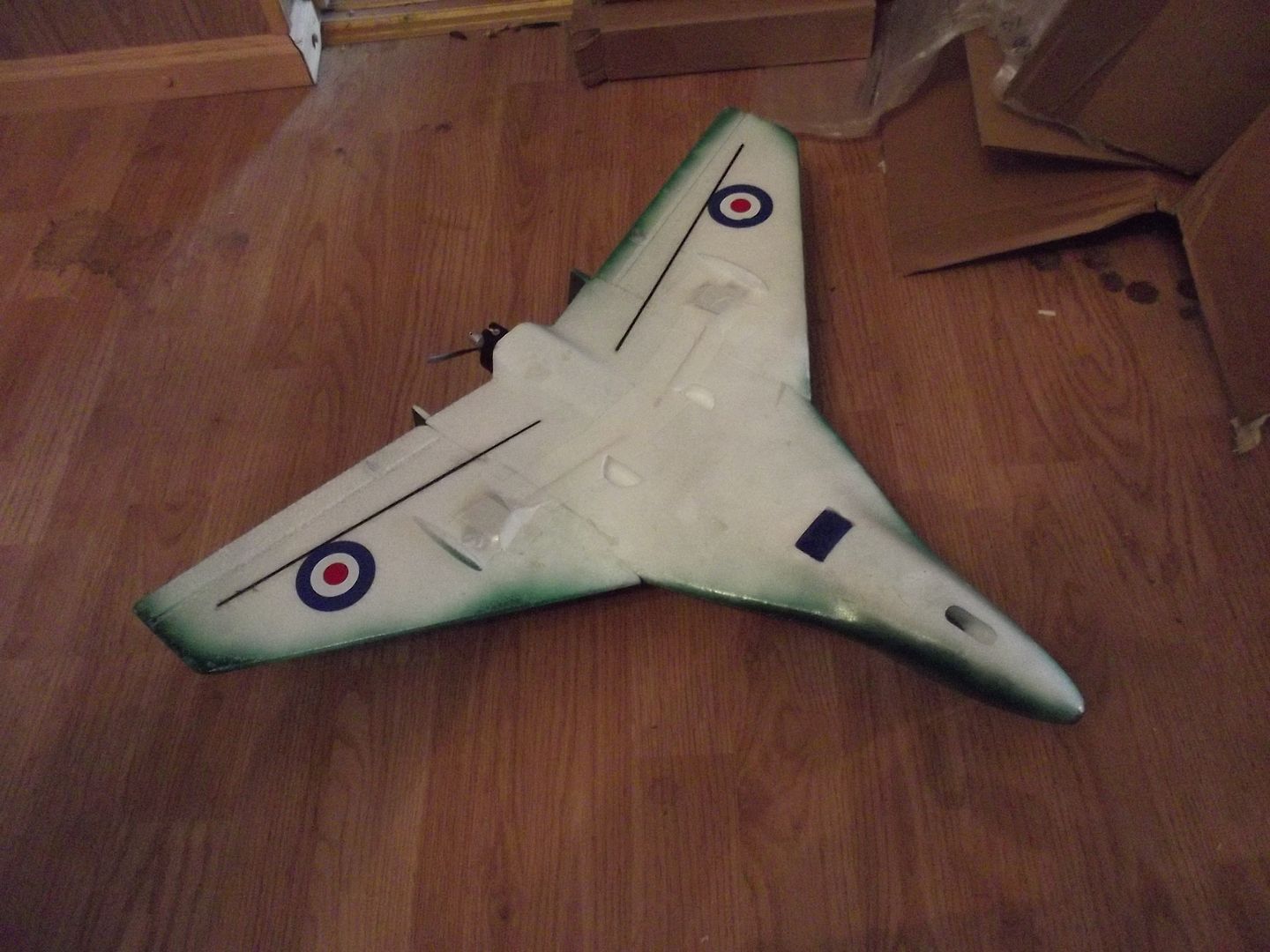

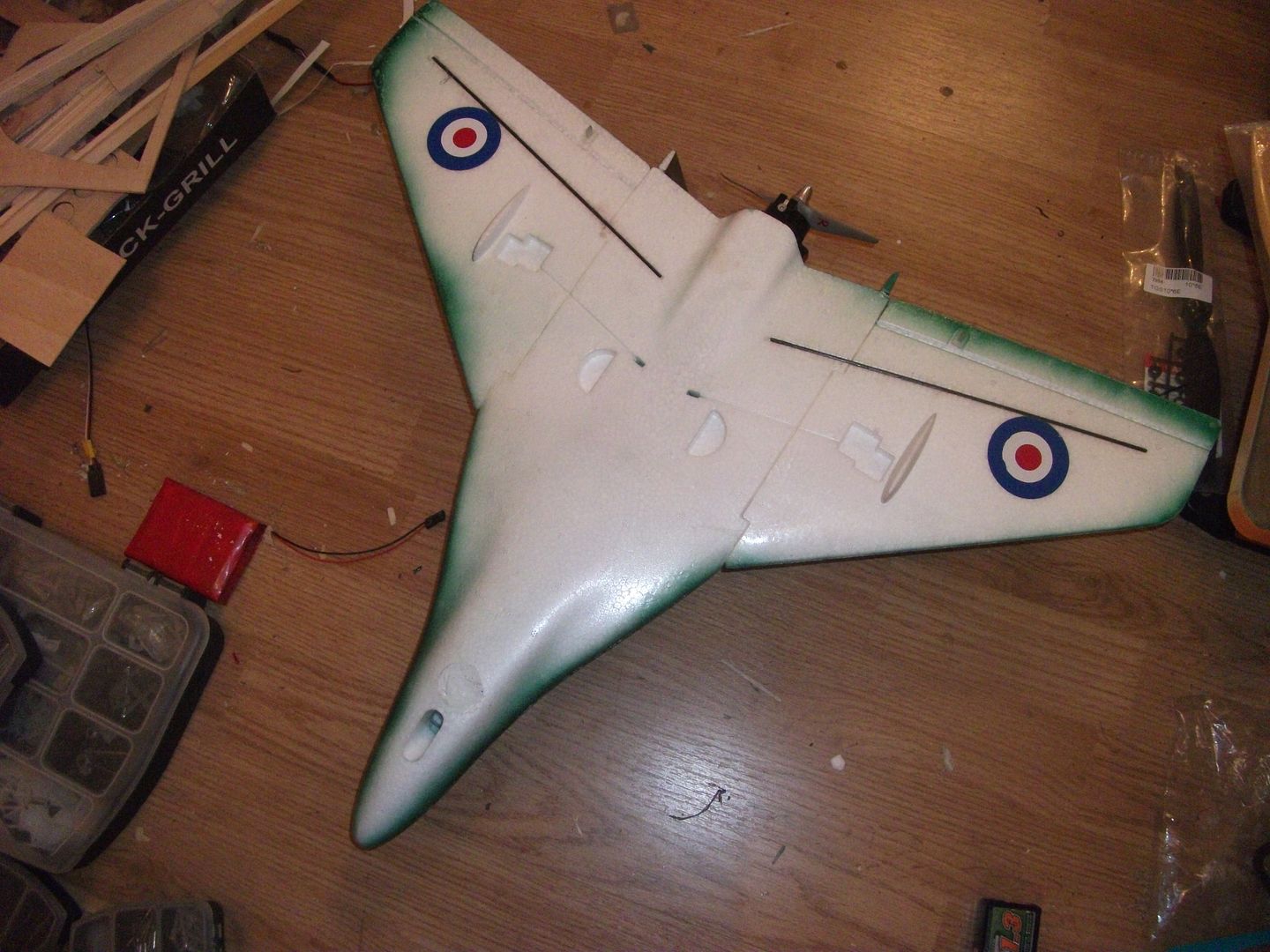

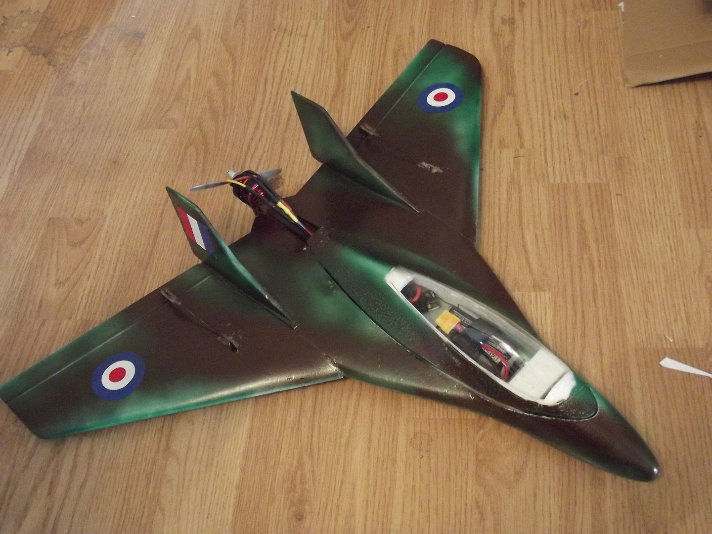

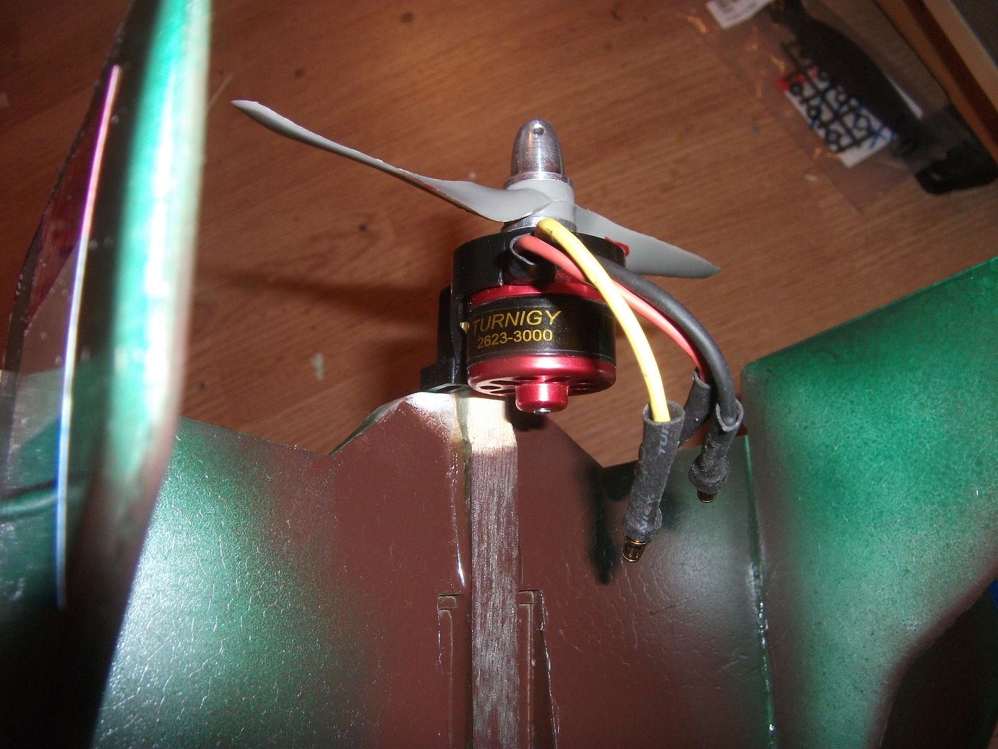

OK here she is getting fixed up, first is sitting on top of Polaris as a sense of scale ..
Motor is 3000kv 250 Heli motor .. with 4.75 x 4.75 prop but that is only a thought - may change when test fly ..
Underside left plain - I think the overspray adds a bit of character !!
What's left to do ?
Add servos (MG TGY-9018MG), the control arms will exit at top of wing to put things out of way from snagging on grass etc.
Install HK 50A ESC
FrSky 4ch Rx
Test for best battery positions and mark up .... expecting to use from 1300 3S up to possibly 920 4S or more ...
I have an Eagle Tree Speed Sensor if needed. But I do not expect to hit anywhere near my previous 222kph ... in fact I had a flight of over 230kph but sadly I failed to record ..
This one is intended to be a keeper and hope not to bash her up too much.

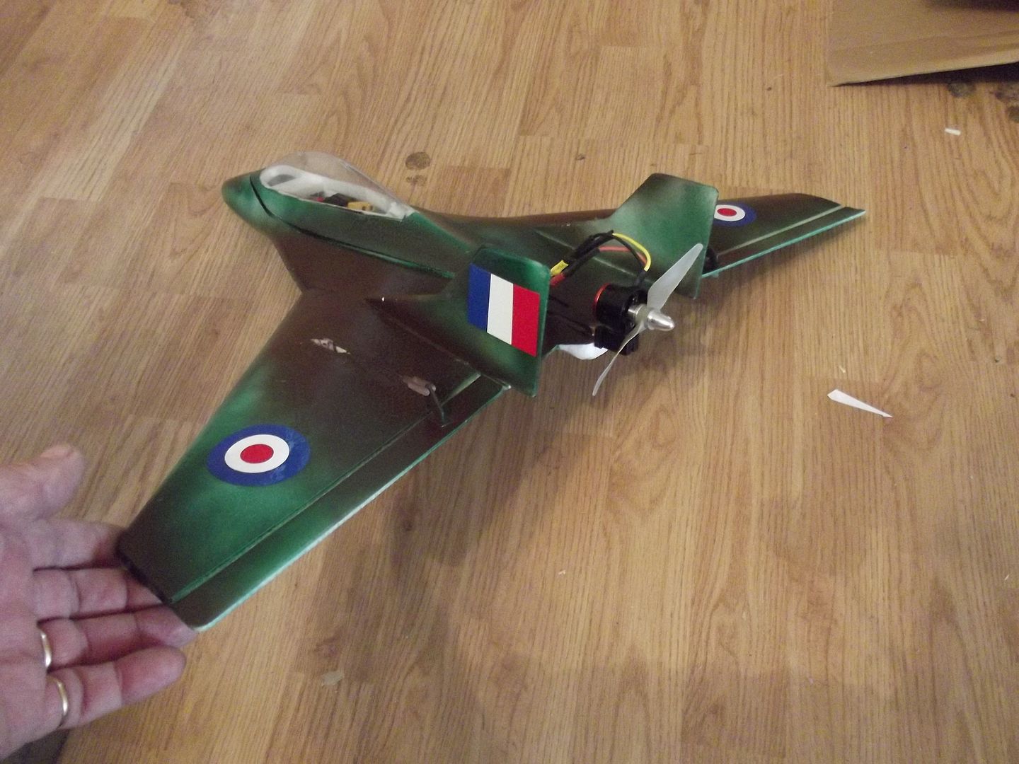

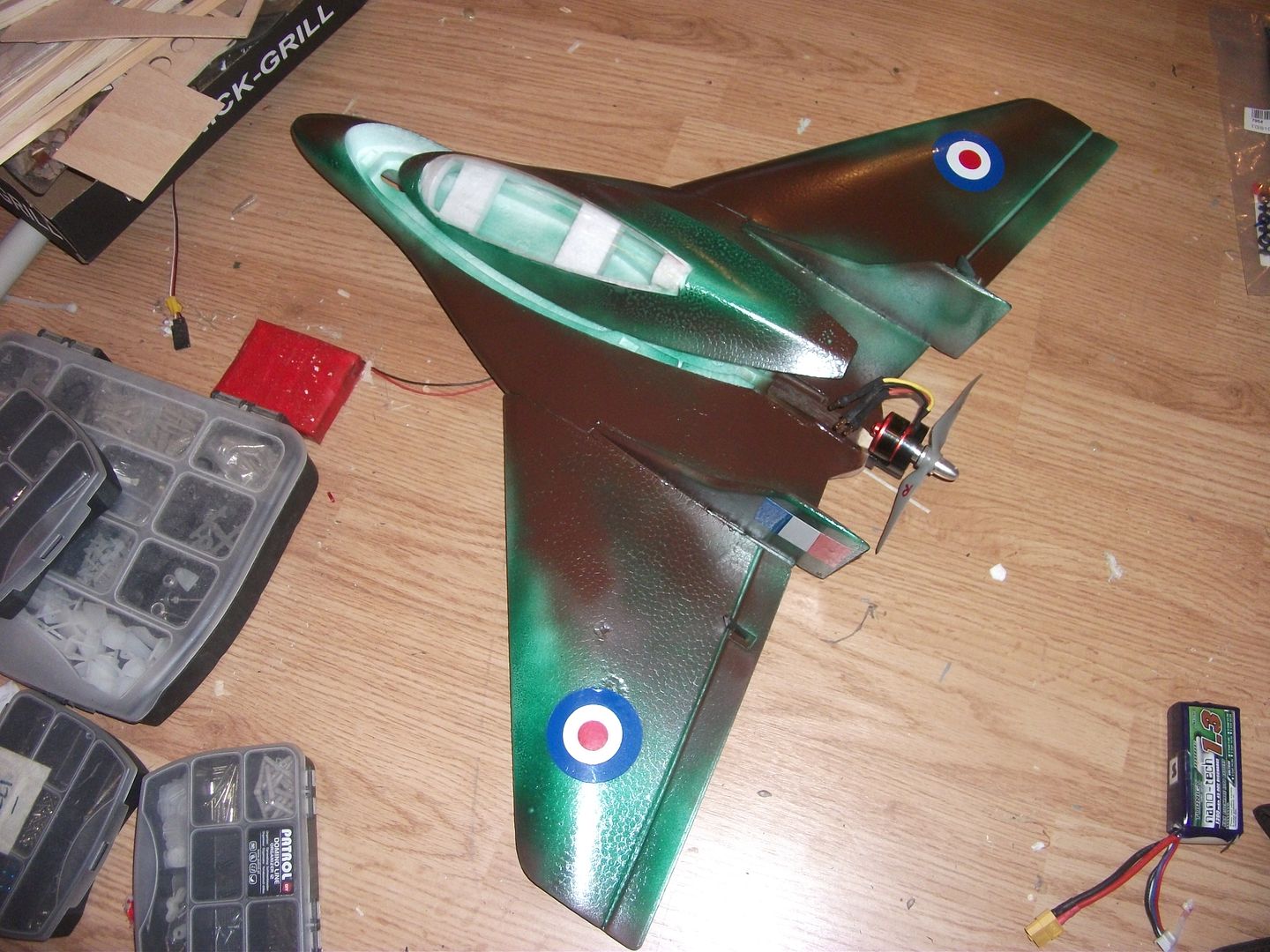

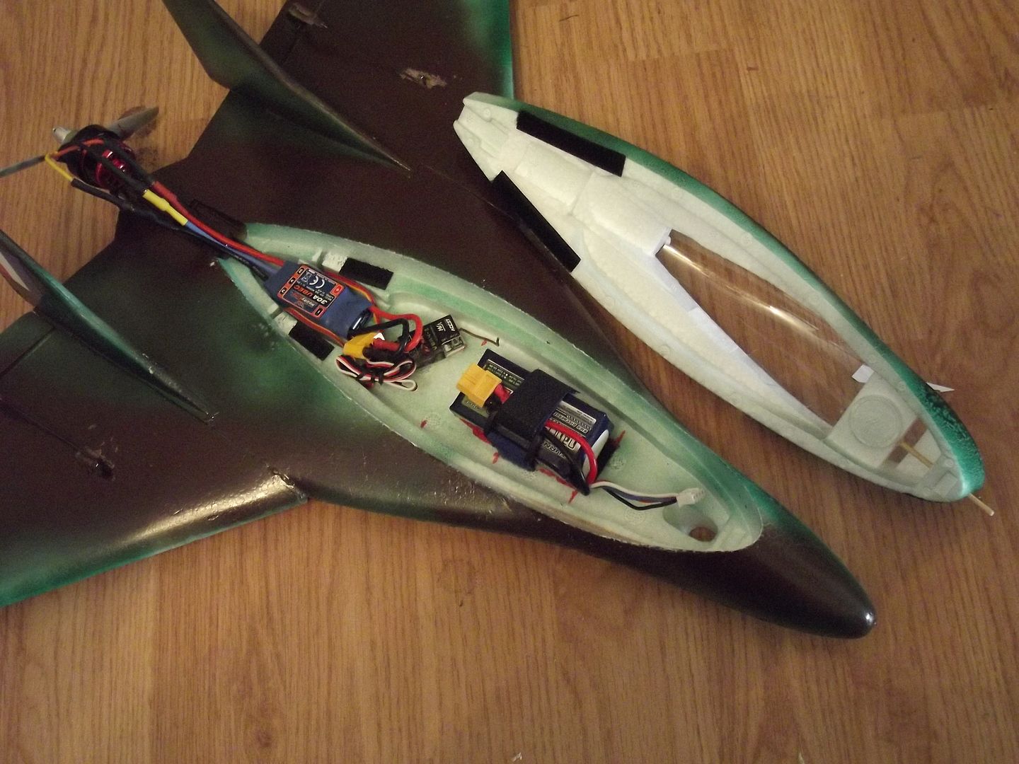

OK she's RTG ....
And installation :
Canopy held by cocktail stick at front and Velcro at rear.
Balances just a shade in front of the finger holes. I can move battery back a touch if necessary. She will take either the Rhino 1250 or the normal Turnigy 1300 3S after removing one of the foam bridges of the canopy.
