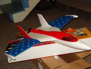

I just bought a new F27-C brushless Stryker and I noticed that the elevons are'nt level with the wing (One a little up and one a little down). To make them level with the wing I had to give it all the left trim that the transmitter would allow. I'm afraid that if it tries to bank right, I won't have anymore left trim to give it. I have'nt flown it yet because I wanted to find out if this is normal or not. If I put the trim in the center, it looks like it would try to bank right but I got to thinking that this may be the setup on this plane to cancel out the torque from the brushless motor. Could this be possible? I don't want to launch this monster only to have it to plunge directly into the ground! I like lawn darts but not with a plane. Any advice will help. Thanks!!!!

it was the same thing with my stryker.
Remove the tape and pull out the servos. Then when you have all your transmitter trims on neutral but the servo horns as close to a 90 degree angle as possible. (that will make sure the elevons move up and down by the same amount)
And then just adjust the push rods so that the elevons are paralell to the bottom side of the wing.
I hope this helped

I disagree with blue man, don't remove the servos. Center the trim and unhook the servo arm to the control horn, by turning it clockwise or counter clockwise it will adjust the length of the control arm and correct the problem.
Both of the elevons should be level with the bottom side of the stryker body. If you have to adjust the trim in flight i suggust you center it when you land and go thru the previous step again until no trim adjustment is needed.
You will find the stryker C is a very easy plane to fly, it will coast very slow and land with ease, it is one of my favrote planes that i have in my hanger.
GL lets us know how your maiden flight goes.

Thanks guys!!!!! I tried centering the trim and adjusting the control clevis's and it worked. I still haven't flown it yet. Hopefully I will get to tomorrow. I will let you know how it went. Thanks again !!!!!
