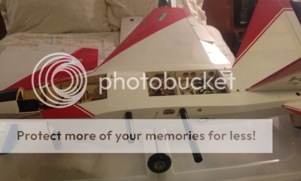

Here she sits Airframe Only:
Some recent pictures during Weigh-In for Dry Airframe only:

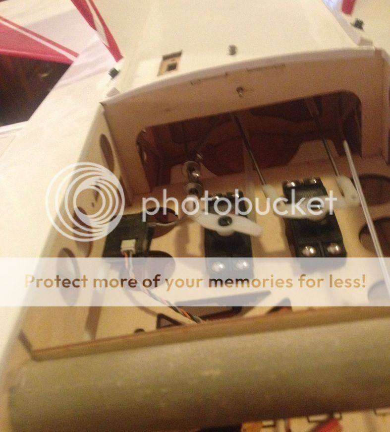

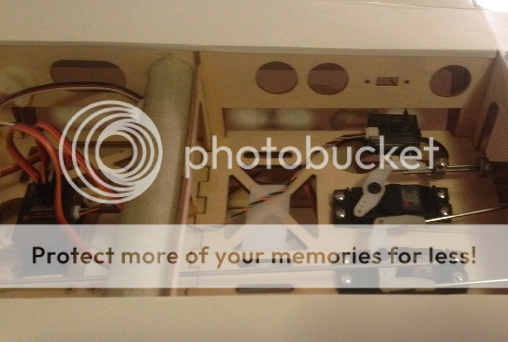

Started with the project and found that someone secured the Glow Engine Mount a little too secure and perhaps used the permanent type of LocTite!
:censored:
Using an Electric "Adjustable" Impact Driver, I was able to remove two of the bolts (Phillips head) on the Left side but, the two on the right side just didn't want to come out!:o:censored:
I carefully using a hand saw blade inside the FUSE and started to cut towards the blind nuts at the bolts that didn't want to come out and see about a neat way to slide the Blind Nuts and Bolts out but, it became messy!
The FUSE is kind of tight and didn't want to destroy it with my large Gorilla Hands so, I took a screw driver and carefully pried the Glow Engine Mount that was lose toward the Left side and it finally came off the firewall with minor to moderate damage of the Firewall.
Found a large piece of 2/32nd plywood and worked a template and got some Gorilla Glue and now it is good as new and motor assembly is ready to be mounted. From measuring before taking off the cut-up cowling, I need at least 3/4th of an inch spacer to allow for the prop adapter to clear the cowling.
A few pictures of my ordeal.......

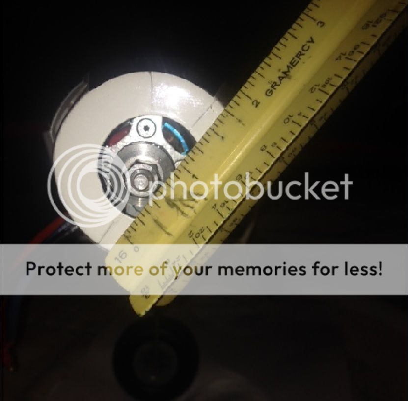

So, like someone suggested, I used one (1) stock Glow Engine Mount hole and the Electric Motor assembly turned out off-set! I am so glad that I didn't drill the rest of the holes!
Needless to say this used motor seems to have suffered a nose in accident as the output shaft is slightly bent and a complete wave off is in effect and I am now looking for an alternative.
Oh, well......back to the hobby drawer!

Guys,
Second late night working on this F22 Raptor by Hangar9 and let me tell you that this is by far one of the most challenging models to convert as that dual heavy vertical stabs and overall weight of the rear with all that wood makes it really heavy to allow for a good reasonable power system and set of batteries to Off-Set all that weight in the AFT area.
Also, lets not forget the rather closed-in Frontal FUSE area to work with and the tiny tapered nose effect as you really can't use a metal cage hardware to mount any motor as it will interfere with the cowling. Resort is to use X-Mount with stand-off hardware and you have to be paying attention to every measurement before drilling.
Okay so, I have spent Tuesday late night and Thursday late night on working with this model and I am exhausted and will take a break unless of course I get a good night sleep tonight.
The worse is the horror to find my newest motor (Emax 46) with a bent shaft as well, however, not that badly like the Himax HC3528-1000 so, with some patience and vice gripe pliers I was able to straighten out the out-put shaft of this motor! It really pays to have Gorilla Hands after all!
Yes, I have run up the motor several times to note where the high and low points were on the shaft and after the fix as well. Now the shaft is very tuned and no wobble what-so-ever! In-between runs of the motor and without the battery connected, sprayed some CRC 2-26 into the motor as this helps with the bearings and cleaned out that motor and now it runs much smoother and quieter.
Here are some close-up pictures that hopefully be self explanatory for all to see what I used and why. Of course feel free to ask questions should you have any.
Close-up shows where I will be placing a small square piece of plywood to allow the battery to clear the ESC wires going to the motor and have a compartment for the ESC wires to stay safe from any unnecessary handling while inserting and taking out the flight battery.

Guys,
Life keeps coming at me....work, family, house, cars, and friends and finally tonight ....wee hours of the early morning got some work done on this fantastic discontinued Hangar9 RC Raptor!
The servos used for Elevator & Rudder are the JR Sport (ST47). These are slightly smaller than the Hitec HS-311 / HS325HB and even the Futaba S3003.
I tried the Futaba 3003, Hitec HS-311 / HS325HB and they just didn't want to go in the STOCK cut-out so, I am thankful that I had the JR Sport ST47's on hand. I suspect that since the JR's are distributed by Horizon Hobbies and Hangar9 is a based product line of HH then, the JR SPORT were meant to be in this model.
